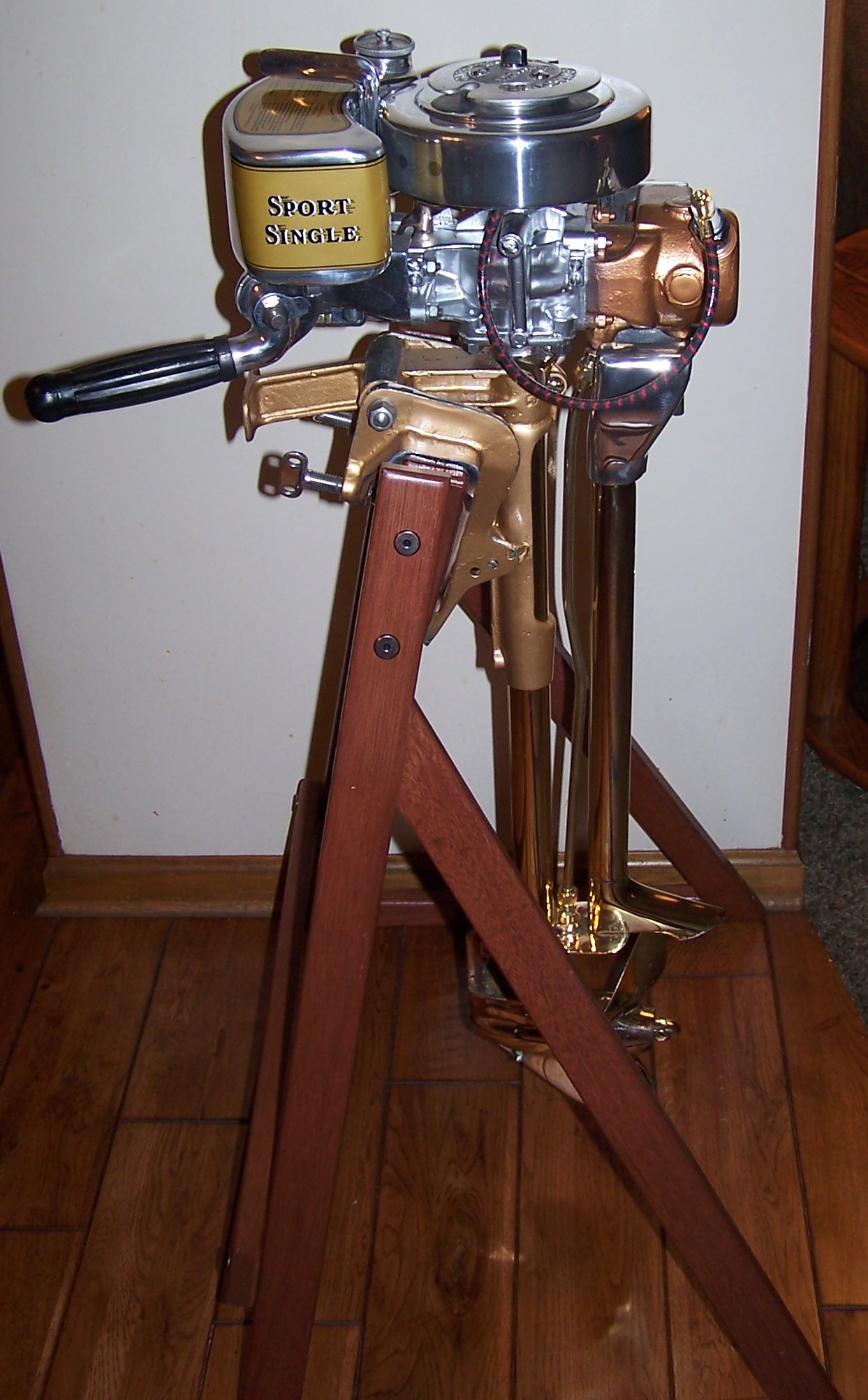

1933 Sport Single
After a search I came across this auction:

June 28, 2024 at 3:57 pm #288712well, I got around to checking the motor it has compression and spark the gas tank is clean and don’t smell like old gas I think it will run. Should I put some oil in the cylinder. The person that had it before me took good care of it.
June 28, 2024 at 4:32 pm #288714
When I start a motor that hasn’t been run in decades I put a ton of oil in that first tank of gas. Want to be sure the bearings, crank shaft, and wrist pins are getting a good oiling, as well as the cylinder. Tubs
June 28, 2024 at 4:44 pm #288715Iam not sure what Iam going to do with it now, not sure if I want to try and start it what would the oil mixture be for this engine. How much oil should i put in the cylinder 1 or 2 oz to store it. what else should I do to store it. what would be the first oil to gas be if I was to start it for the first time. I don’t know much about these, but they look good.
June 29, 2024 at 7:32 pm #288742
Be sure there isn’t any water in the gear case and fill it with lubriplate 105 or corn head grease. I’m guessing you don’t have a grease gun so the 105 might be the best choice for you as it comes in a tube. Available from NAPA or on line. Put some oil on the threads of the gas cap and vent screw and close them fairly tight. Keeps them from getting stuck over time. Take out the mixture screw and put some oil on it then tighten it so it just bottoms out. Don’t over tighten. This is to help keep air and moisture from getting in the tank and carburetor. Take out the spark plug. With piston all the way to the top, and with the spark plug hole facing up, pour in about ½ oz of oil. Slowly turn the flywheel till the piston gets to the bottom. Then turn the motor over a few more times and put the spark plug back in. Expect some oil to come out of the exhaust. If the motor is going to be stored in an unheated space for and extended period of time, it would be best to build a wooden create to keep it in. Really helps to keep away the moisture. Option 2 would be a sealed plastic tub. Tubs
