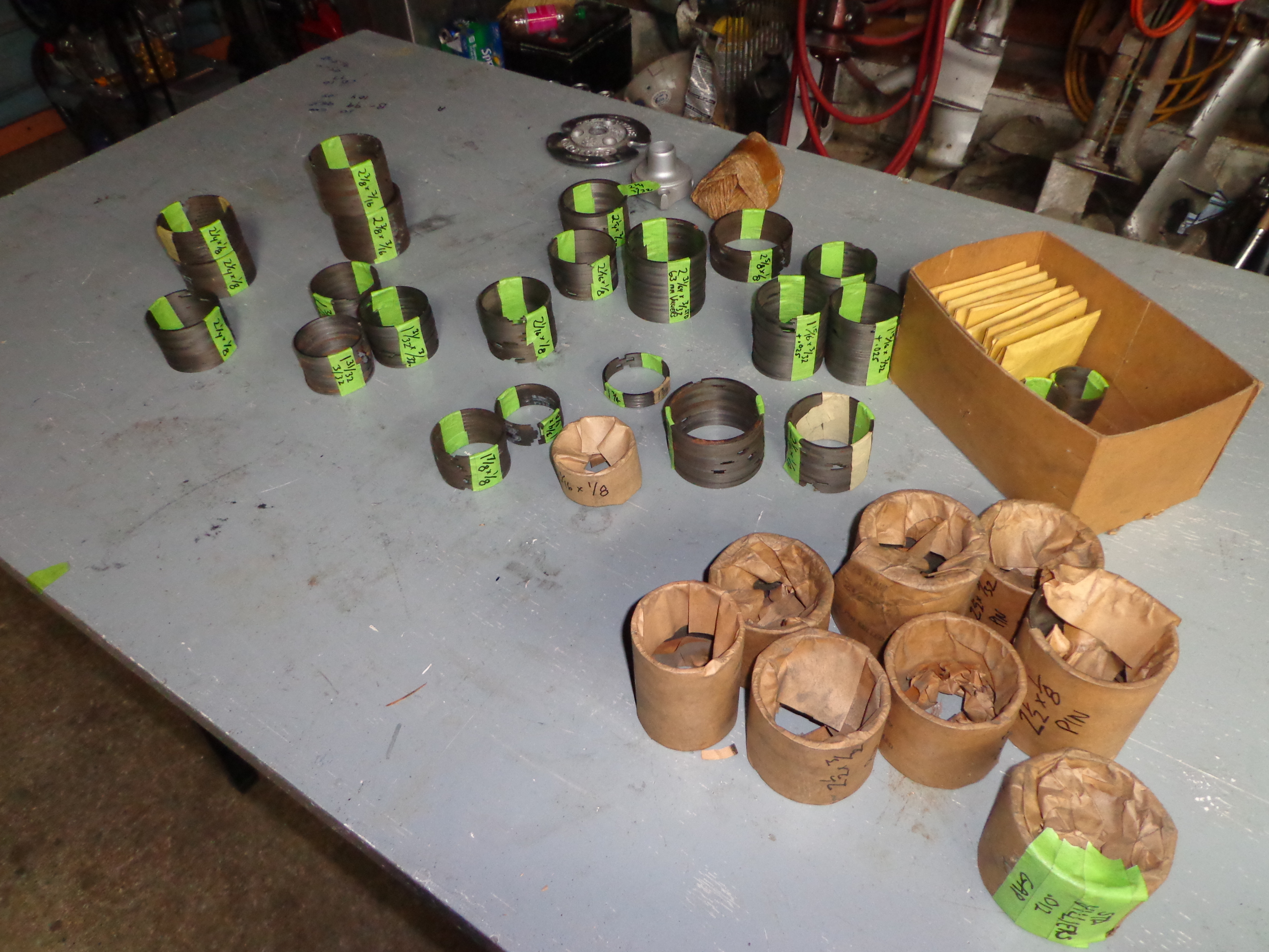

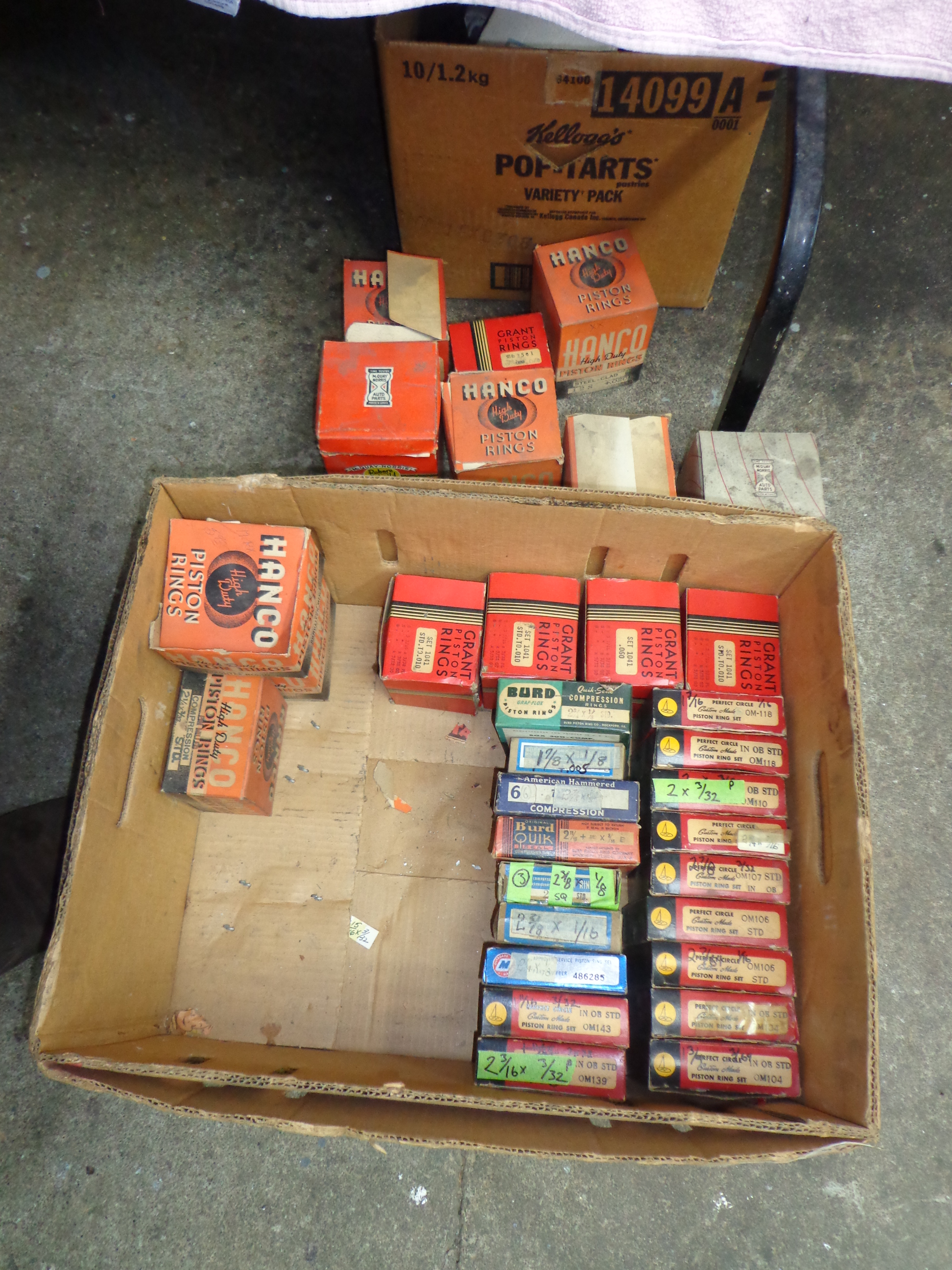

                Randy, if you can find them, +0.010 oversize rings will work in a given bore size. 1/16" (0.0625) oversize is just too much.
                I have lots of rings here for different things which I’ll never use but nothing near what you need. Anyone building a Ford flathead V8? Lots of those from std. to +0.070. Free. Take them.

                      quote Mumbles:
                      Mumbles, we need to talk!
                      #35441
                      chris-p
                        I think he meant a set, not the whole collection, lol
