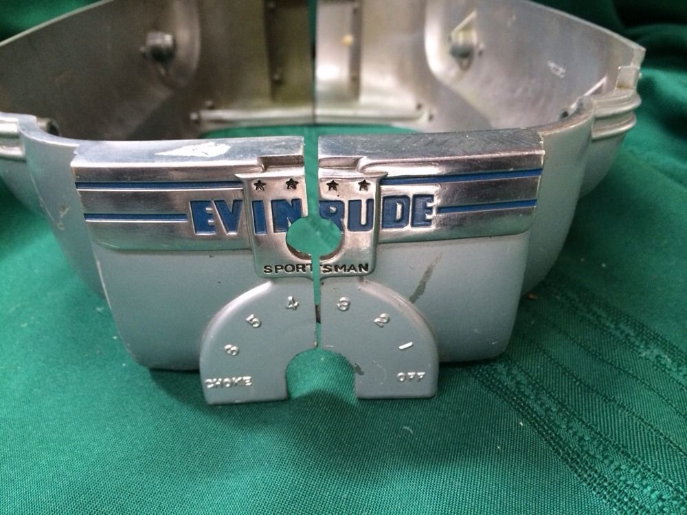

        Well you all talked me in to it. For the top lettering I sprayed a board and let the paint tack up then rolled the letters in the paint. That got about half of them. If I rolled it in something a little softer it may have covered better? Then I tried what modelers call dry brushing. Took a detail brush cut the bristles halfway sprayed some paint on a board let it tack up a little then brush the letters horizontally with the bristles flat. It didn’t matter if you got a little on the silver part it came off pretty easy with the sharp and flat end of a toothpick.
        The bottom letters I gently used a point file then finished up with a stick sander.
        #54102
        olcah
          Nice! Looks original.

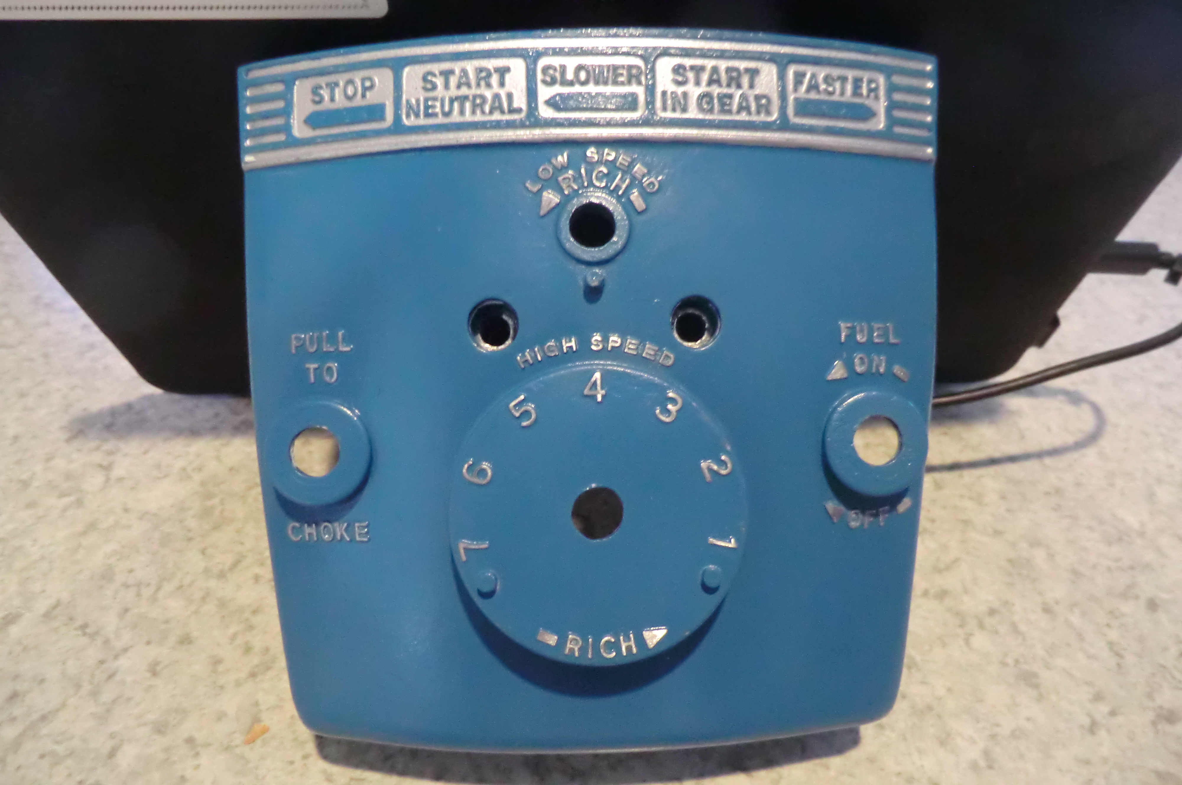

          #54103
            Nice work guys. I to have found a small brush and no caffeine in the body works. I’ll save the jiggle juice for after when the job is done.
            #54111
            Goman
              Nice Mumbles! I’m guessing that chrome paint isn’t rattle can is it?
