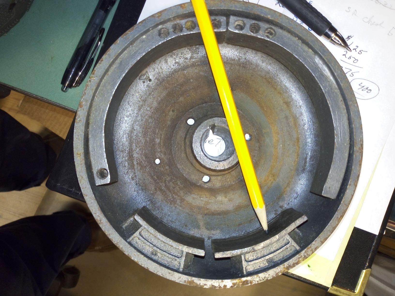

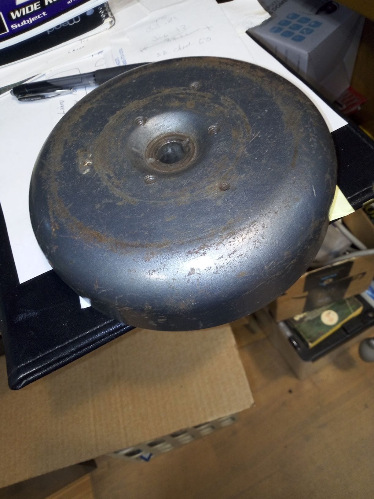

                  I have phelon flywheel came on Mk 20 power head I bought with Phelon magneto. Will ship for $30. One of magnets is dead. I you can get magnet charged should be OK
                  #212326
                  mercuryman
                    I have one I will sell for $30 include ship. It has on bad magnet if you can get magnet charged it should work. I see no numbers on but will fit Mk 20 crank.

                    #212329
                    foot_doctor
                      I can charge the flywheel if the magnet is viable. (Not Cracked)
                      R.T.
