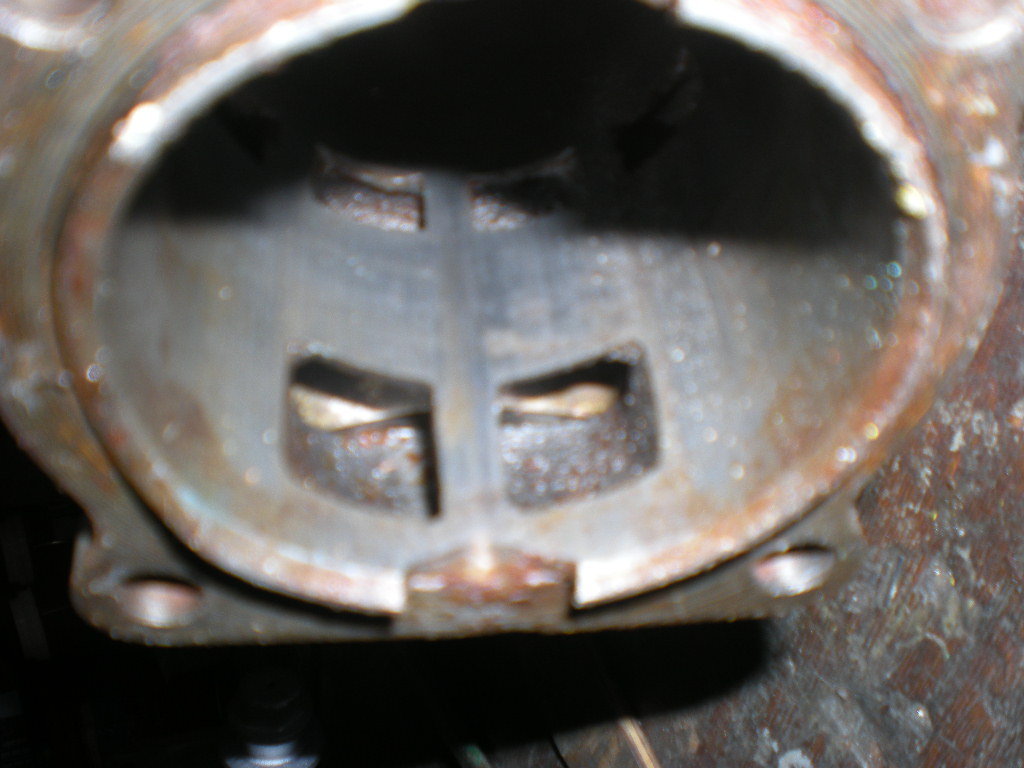

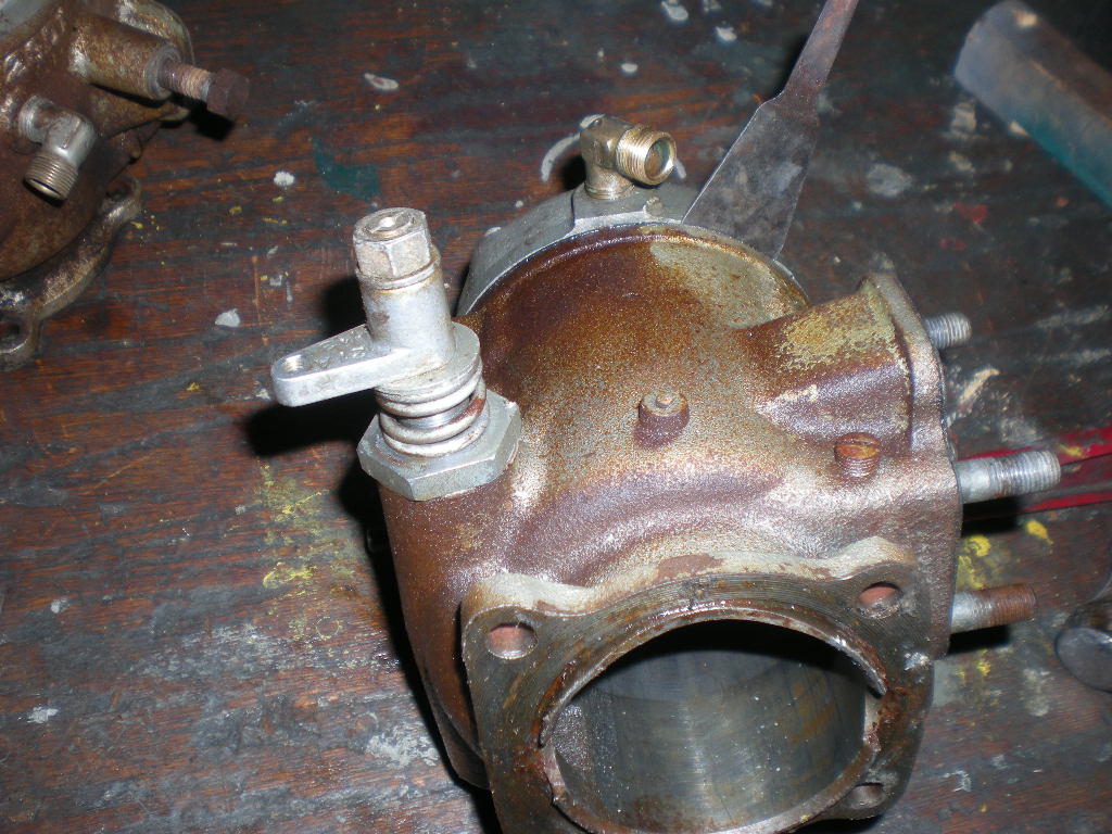

      I thought the compression relief system consisted only of the poppet
      valve in the one cylinder head, but now I see there’s also a
      rotary curved vane in the inlet porting. Does this shut off
      fuel to the cylinder so flames don’t shoot out the poppet valve?
      #47146
      George Emmanuel
        Nope, it prevents a charge of fuel/air from entering the cylinder and allows the mixture concentrated in the crankcase to go to the other cylinder.
        As an FYI, you can start that engine without using the compression release, but I like using it, especially when the engine is cold. I’ll crank mine up and idle a bit before closing the valve. That seems to prevent a stall when getting away from the dock.
        George
