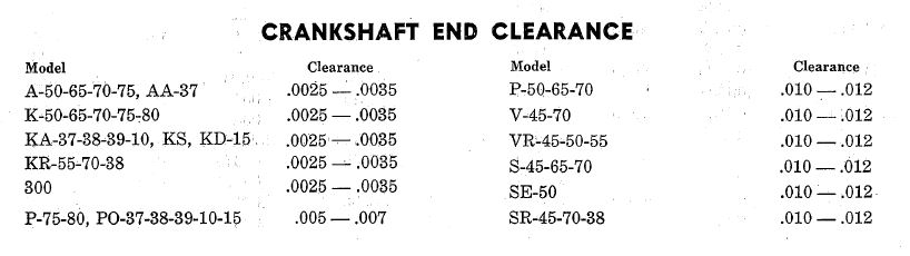

      I queried about "How much end play is too much".
      Gary said "Over .006 is too much on rotory fuel
      induction style crankshafts.
      My question now is…..
      "What’s the minimum clearance"
      I had about .009 end play before originally.
      (check with a feeler gauge)
      It had two gaskets on the crankcase head.
      I removed the thin one (about .006 thick),
      snugged it back together, and although it
      turns freely yet, I don’t think I have over .001
      end play. I can barely feel any end play.
      "Will I have a binding problem when the old girl heats up?"
      Thanks!
      #47470
        0.006 is ideal. A few thou more shouldn’t cause any problems.
        #47478
          Mumbles, Thanks!
          Me thinks I better did thru my gasket material and make
          one to give me just a tad more clearance.
