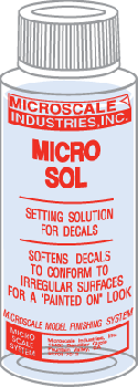

December 21, 2016 at 12:02 pm #49519You may want to review and try this product. There are two parts to it. First goes on the tank before the decal the second is applied over the decal.
The last I spoke with American Outboard they will send you another decal if your first attempt fails. Follow American Outboards directions as already mentioned. I would use the clear coat a half hour or so before applying the decal.

Goman, I’m a little concerned about that product "softening"
the decals that I was warned from the vendor as being "delicate"
already. Have you used it before?

December 21, 2016 at 9:20 pm #49543I’ve used the micro sol with good results. The first part from what I remember gets the paint ready to accept the decal. Some worry if you soak the decal too long it will not stick as good. The second part will settle any bumps or creases or other imperfections you get especially around bends. I still had some minor cracks and dings. After I put on my final clear coat I used a fine point permanent felt marker for touch up. You might want to read up on how some of the model guys apply the big decals on boats and planes and such. I’m sure not an expert.
GlenSorry I didn’t mention it was for the water slide decals.

Thanks for the micro sol info.Prepare to be boarded!
December 21, 2016 at 11:52 pm #49554For my PO decals…and other long Johnson Evinrude tank decals I use a wallpaper tray…a long one…for soaking. Yes I also use MicroSol to set the decal. Decals after soaking typically have almost no adhesive left to adhere them. So clearcoating matters.
Used very warm…not hot water with a DROP of soap to allow the decal to ease off the paper. Do not force the decal. Use the paper to support it on the tank and ease the paper out from under the decal after you get it in position. Once the decal is on the tank…I use a spray bottle with the same soapy water to keep the decal floating as in move it gingerly into its final spot
Don’t worry about wrinkles…the MicroSol or MicroSet will take care of those that form on compound curves like corners.
Some older decals may require a bit of clear coat. Use something that will be comparable with you final clear coat.
Greg
