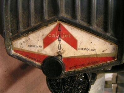

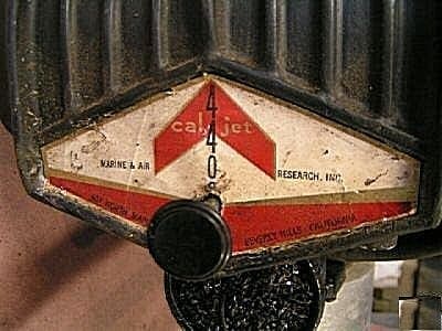

          Decal-X
          #181305
            Thanks Tubs! I searched for an hour last night looking for that decal!
            Where did you find it?
            The text in the lower right of the decal says “Beverly Hills California”.
            Can’t make out what it says in the lower left.
            Maybe “Jed Clampett”?
            • This reply was modified 6 years, 6 months ago by Buccaneer.

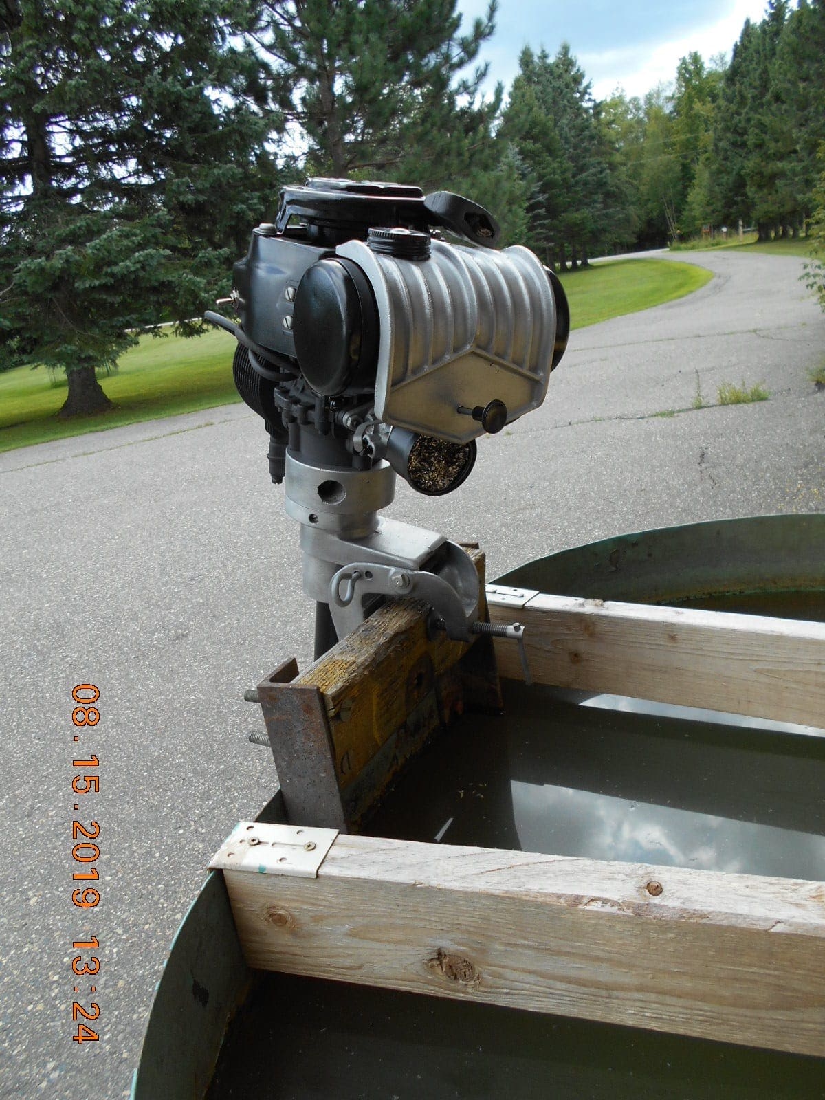

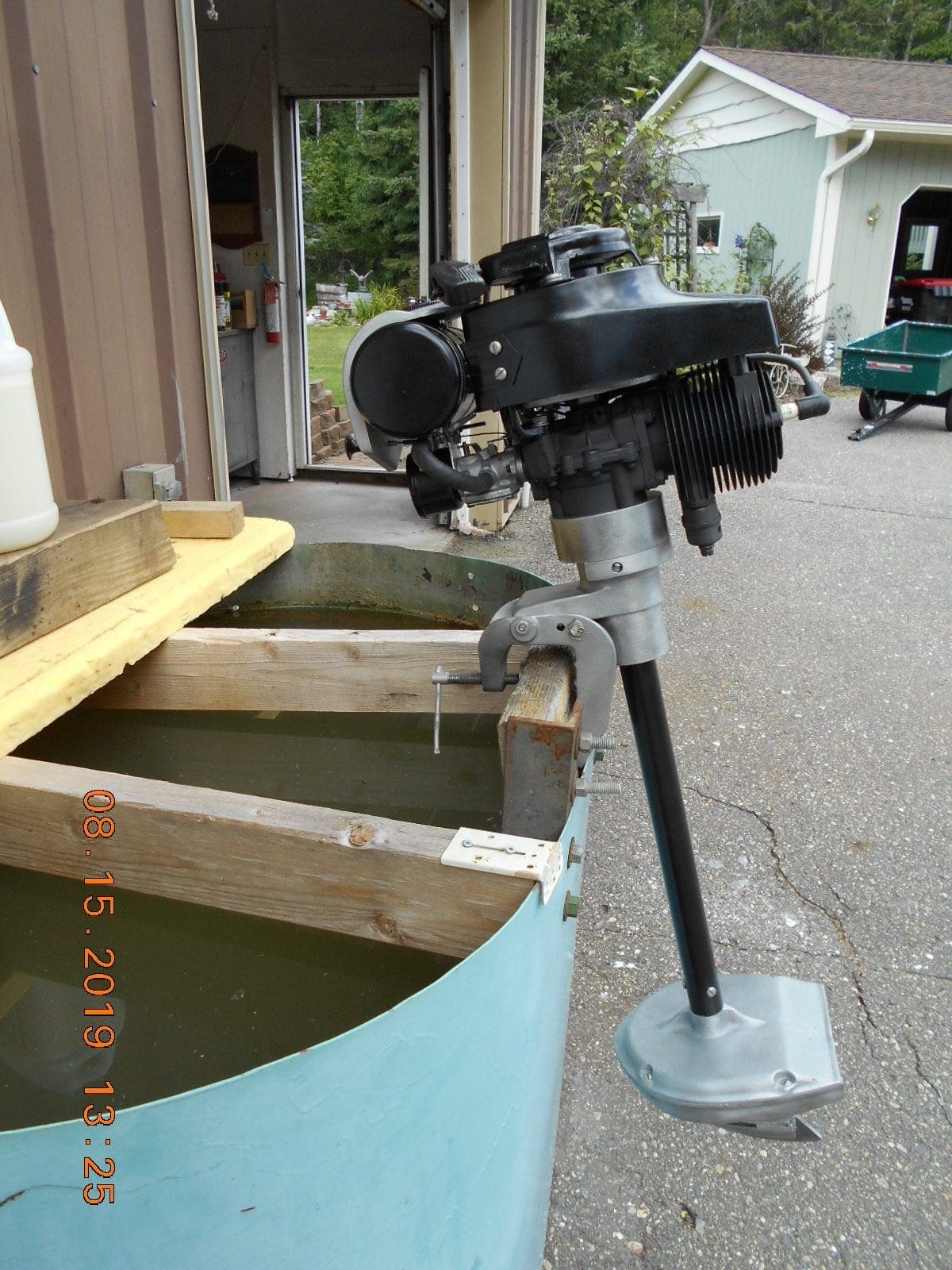

                      I finished putting the Cal-Jet together today and fired it up.
                      I put a new carb kit (with diaphragm, etc.) in it, but it probably
                      needs crankshaft seals. It’s running lean on the idle circuit.
                      I should attempt to put some decals on it if I can find or
                      make some, then put it on the rack for the next 20 years!
                      https://youtu.be/CGbGilNxuiI
                      DSCN8063
                      DSCN8065
                      DSCN8066
                      #181401
                        You’re pretty quick. looks better (to me) with
                        the front cover painted silver.
