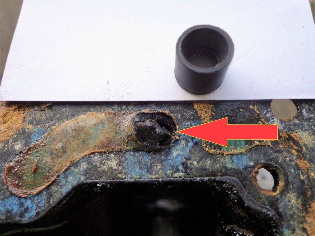

        #29908
          Here’s a collapsed grommet compared to its new replacement. it wouldn’t matter how many impellers get installed as the motor is still going to overheat with this restriction in the cooling water circuit.
          Coating everything with Triple Guard grease may help to slow down any future corrosion.

            In any event, your 1986 15hp has two water tubes and two grommets. The normal long water tube bringing water up from the water pump, and the shorter water exit tube that leads water away from the open exhaust megaphone. Chances are pretty darn good these grommets are crushed if this is a salt water engine, even though the tubes/grommets are the "improved design", unless someone has already done the grommet work. I think you will notice that the new grommets are just a little higher than the water tubes, cutting about 1/8" off the top of each grommet should solve this problem.
            Don’t forget to check the upper mounts while the powerhead is off, the open megaphone engines like yours are more prone to upper mount failure.
