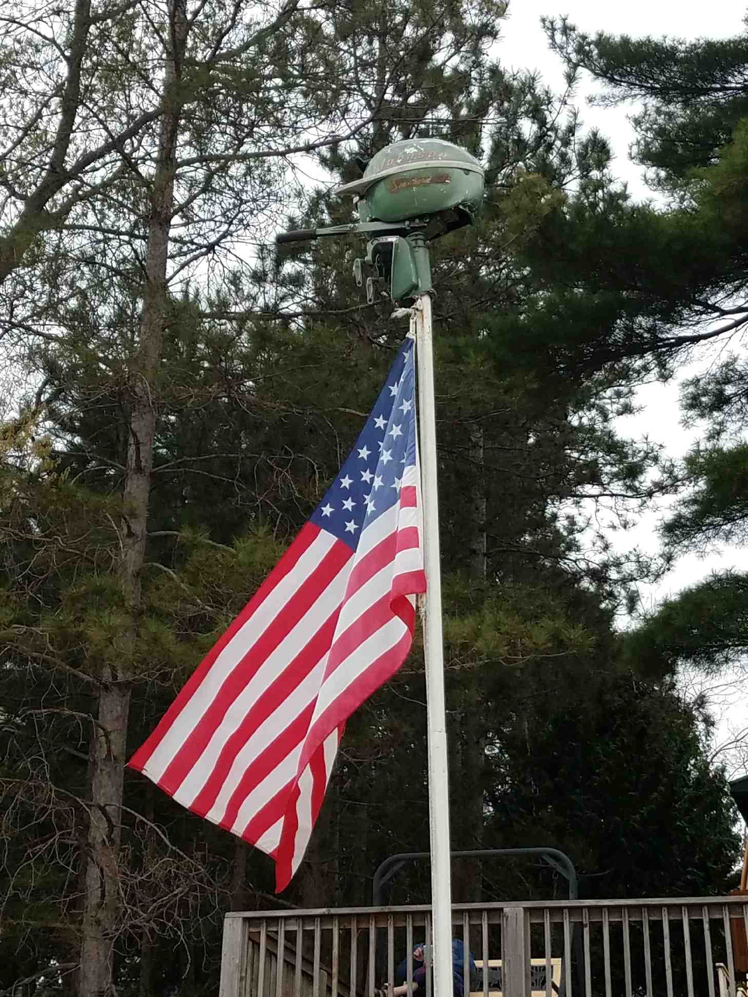

                I used car polish/cleaner on the one below. The paint wasn’t real good to begin with and it’s due for another polish after being outside a few summers.
