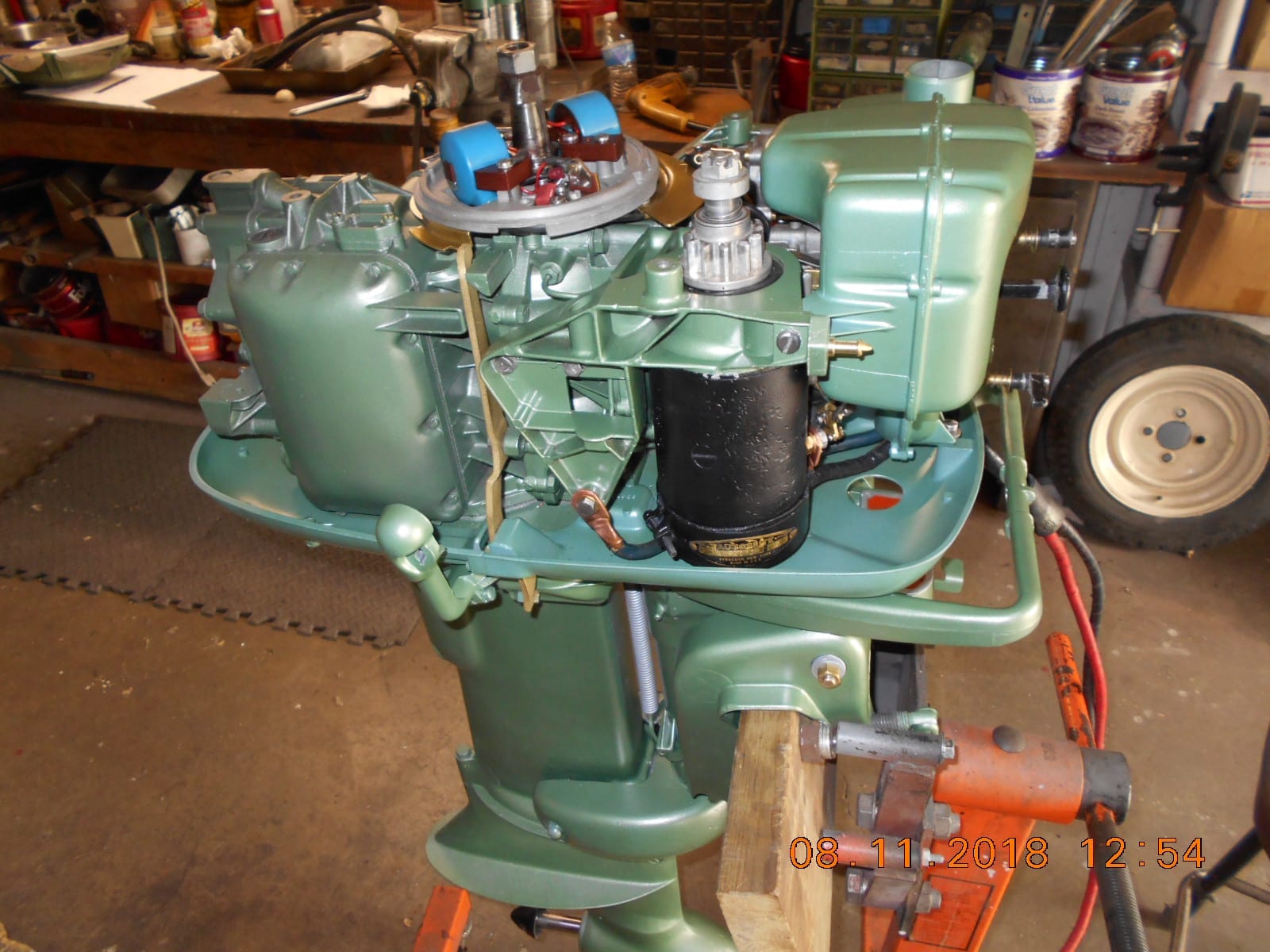

      4.I was able to obtain a starter (MAK 4033 4K),correct starter bracket and flywheel.
      The problem I am having is-

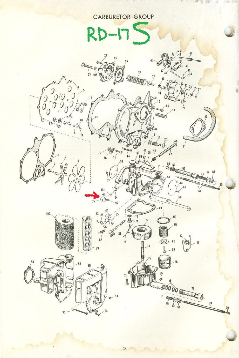

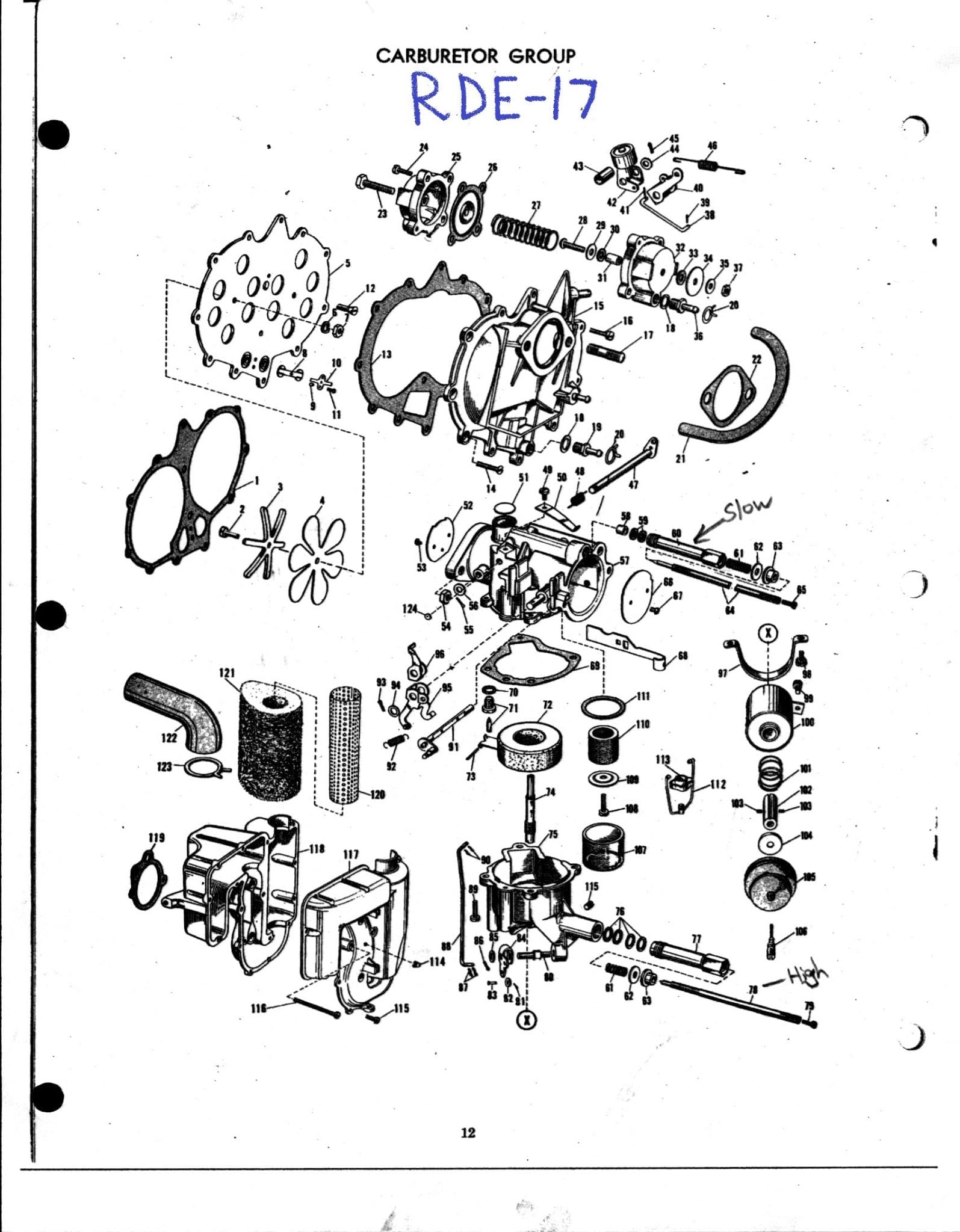

      When I try to mount the starter .The starter bracket hits #55 lever.(see RD-17S parts list).I noticed on the RDE-17 parts list that there is no lever. My plan is to find the type of throttle shaft(#47) (376239) that is used on a RDE-17 and eliminate the lever and replace with washer and cotter pin.

      1955-RD-17S-carb-list

        1955-RDE-17-carb-list-2

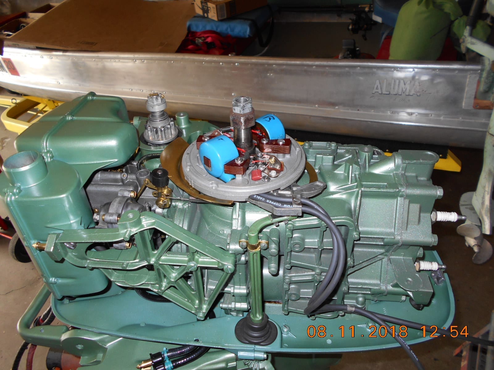

            #189533

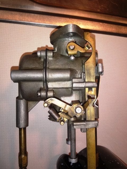

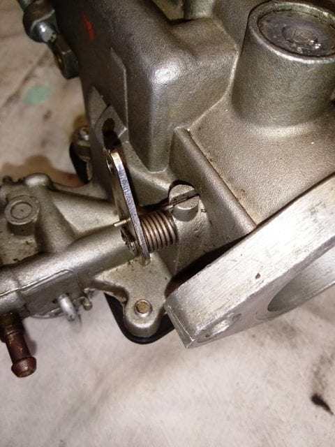

              Not sure if this will help, but it’s my RDE-17
              DSCN6904
              DSCN6905
              DSCN7116
              DSCN7118
              #189543
              outboardnut
                Thanks Buc Thats what I wanted to see

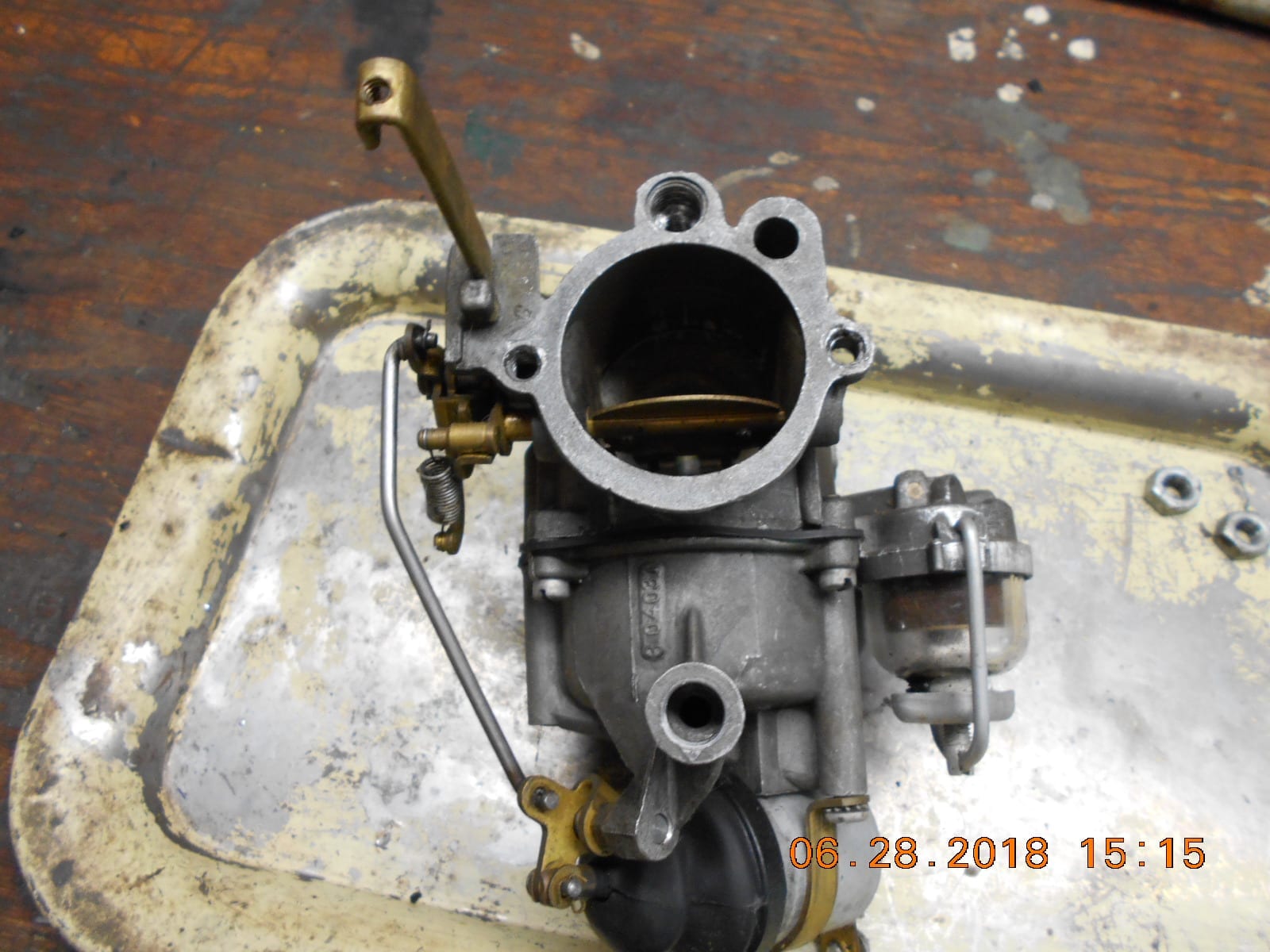

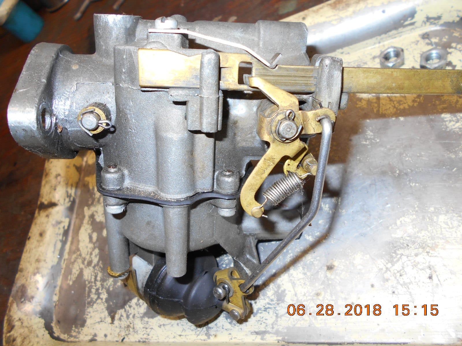

                  this is what my carb looks like from RD-17S
                  20191217_180452
                  #189552
                    Looks like your carb gives you a fast idle when you pull the choke out.
                    Perhaps you can find the correct carb parts or do some kind of
                    modification?
                    #189557
                      Looks like they didn’t figure an electric start motor would be rope started often enough to need a throttle kicker.

                      outboardnut
                        spring-side
