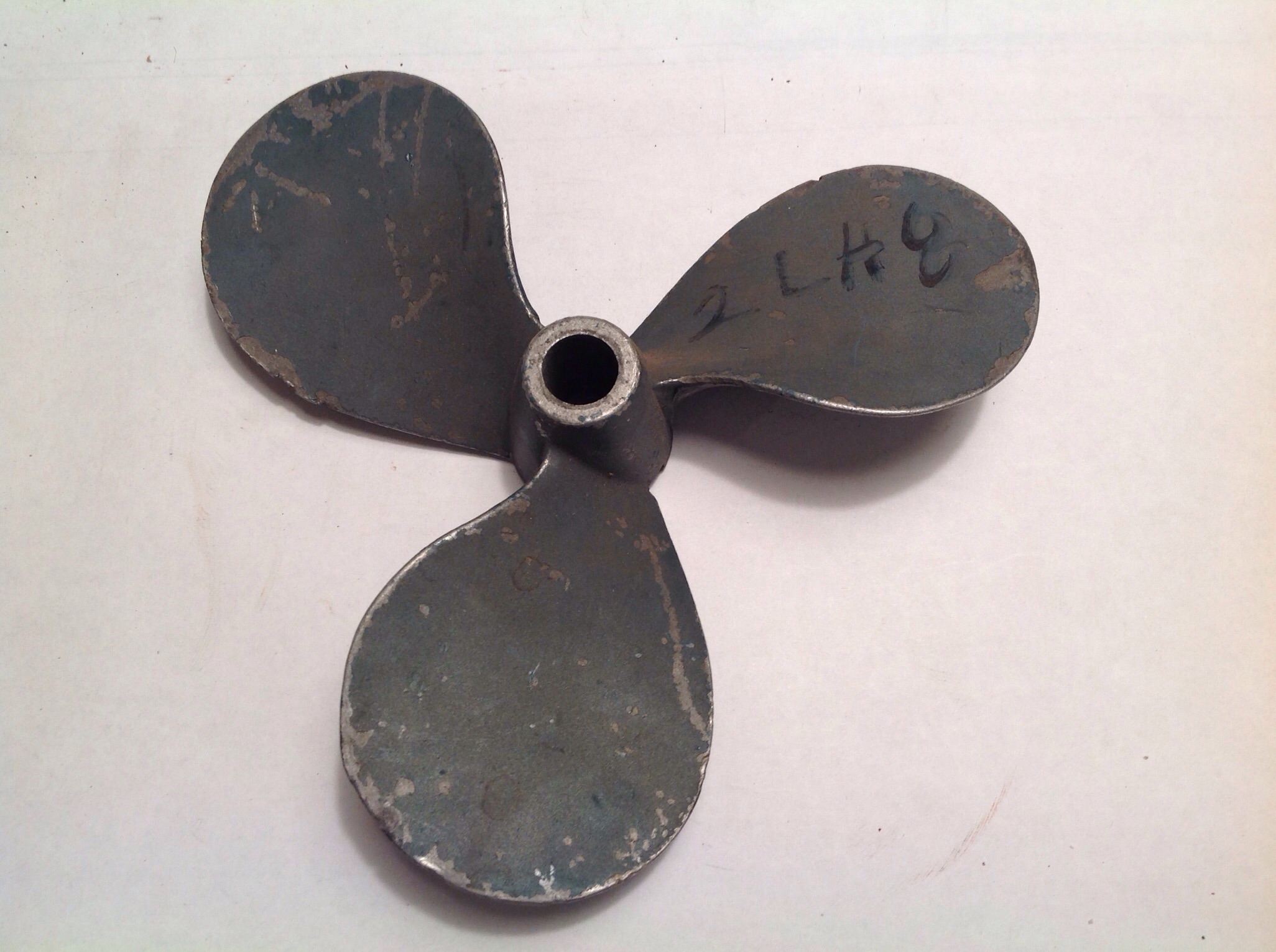

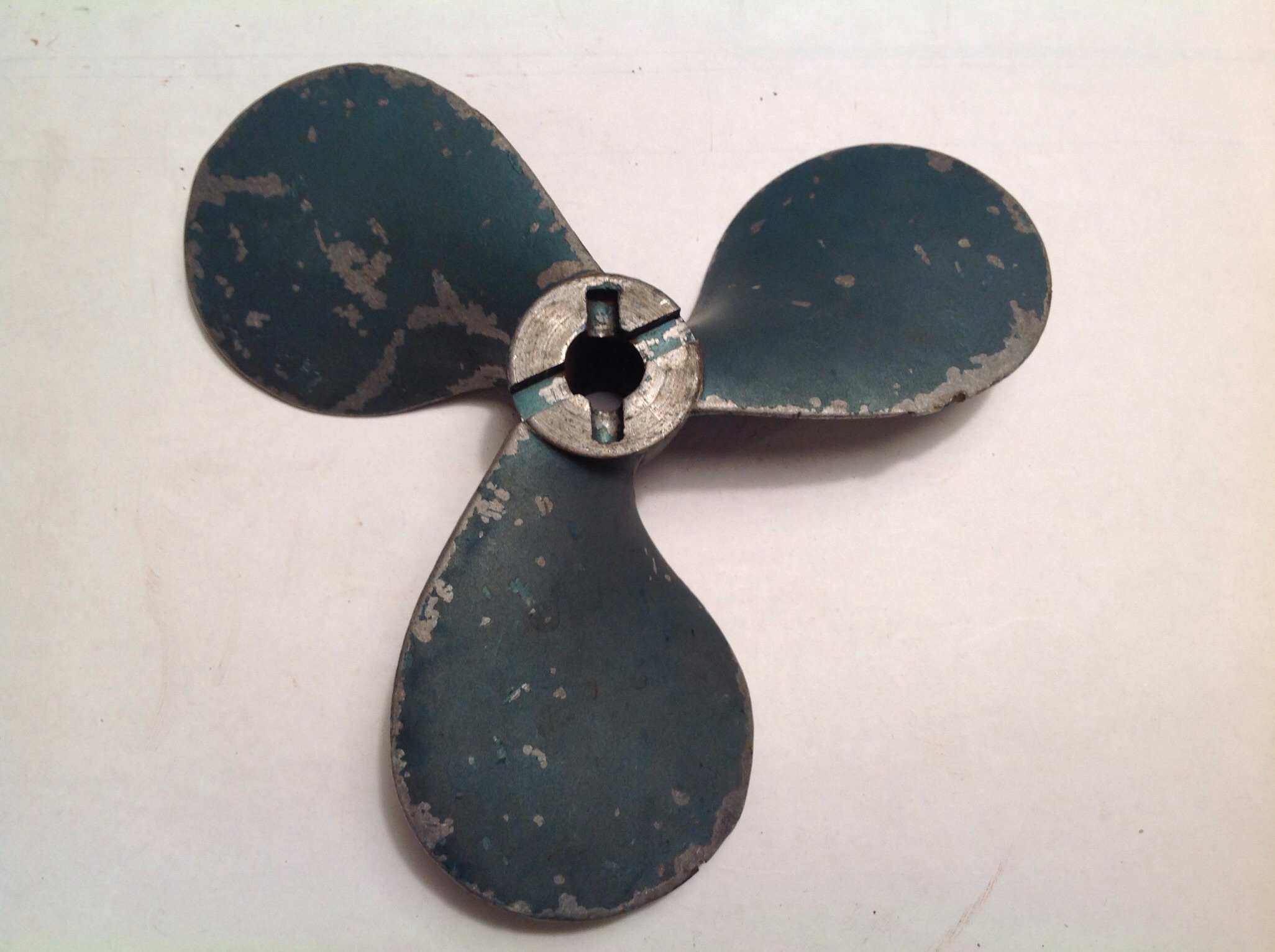

      I am an OMC guy, but found this prop when sorting through parts. Could it be Champion? Any ideas would be helpful so that I can add it to the trade pile and get it to someone that will use it.
      #46392
      dan-in-tn
        How about outside diameter & propshaft size? That might help. It is a counter rotation which might narrow it down some?
        Dan in TN
        #46398
        ADAM GIBB
          Oups. Forgot to put those in the post. Prop shaft bore looks to be for a 1/2" shaft or just over. 9/16 would not fit. The diameter is about 7-1/2.
          #46406
          mercuryman
            My guess is Champion Hydro drive 4.2
            #46410
            outbdnut2
              quote mercuryman:
              Yes – I agree, and someone wrote 2LH8 on it. Not sure where the 8 came from, but the hydro-drive 4.2 was a model 2LHD, made 1950-1952. On this model, the hydrostatic drive was not really needed to get to low trolling speeds as it was on the 8.4 HP 4LHD model, but it did give the motor a "neutral".
              Just visually looking at the prop, it looks like it would also fit a 4LHD, 8.4 HP with Hydro-drive.
