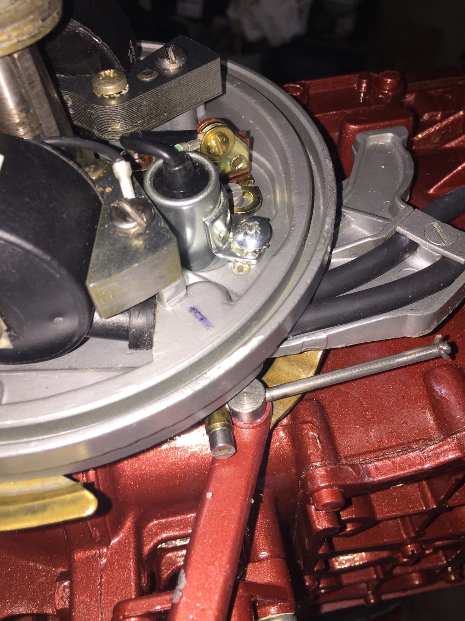

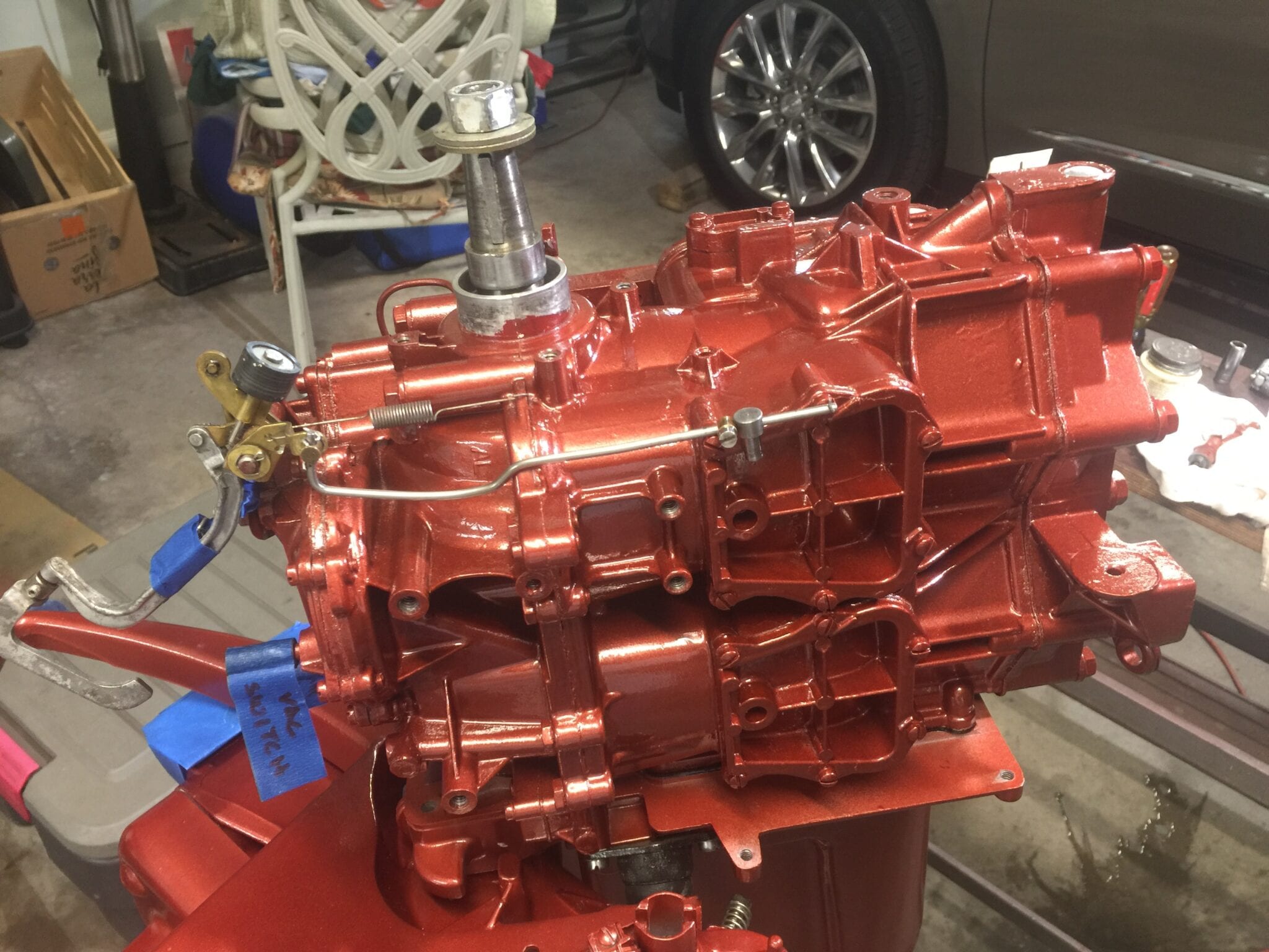

              Don’t know that it would help you much but here’s a couple progress pics of the fuel saver rod/linkage from when I was reassembling my ’56 30hp Johnson. Not sure if the cam roller assembly would mount up on your 55 intake but maybe so. If not, maybe you can swap out the ’56 manifold onto your ’55?

                Definitely helpful. I’ve got the carb and ignition plate from a ’58, but I don’t have the intake plate. Thanks Bob
