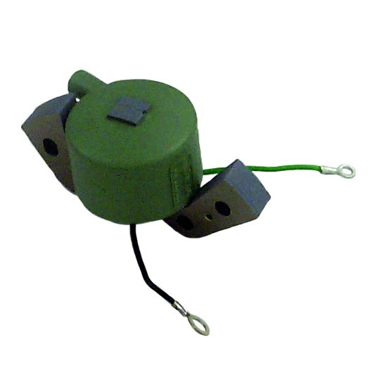

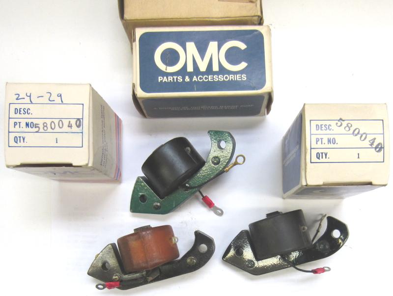

      Like i said the coils "work" but throw weaker spark. I am not sure of where to get replacement coils, with or without lamination. Any ideas?
      #40311
      steve001hsd
        I would like to replace the coils but I dont know where to get new ones or a suitable replacement. Any thoughts on that? They work but are weak.
        #40312
        beerman57
          I got coils for the QD11 at Seaway Marine in/near Seattle, WA. Expensive, but I didn’t want to mess around with all the other stuff to use readily available replacement coils.
          #40319
          steve001hsd
            From some of my research it looks like Sierra International 18-5181 coils will be a near direct replacement. Can anyone verify that? I’m working with a local marina that deals with Johnson but I have no concrete data as of yet.
            #40325
              The Sierra 18-5181 coils are slightly different from your original 580040 coils. Two totally different ignition systems. I’m not sure but you might be able to use your original laminations and press a Sierra style coil onto them.
