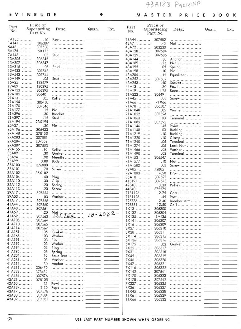

      From the parts list I have for my QD-16, I see that the needle bearings are part number 27-148, which are NLA as far as I can tell.  But I see on marine engine.com that the part number for the connecting rod needle bearings for the QD-19 is 378150.
      So my question is:  Does 27-148 supersede to 378150?  Is it the same part?

        Yes it is. Instructions from Frank R. – “replace the “dash” in the original part number with an “A” and then look that up on the chart.”
        Part_number_changes_that_had_letters_in_them_A_B
