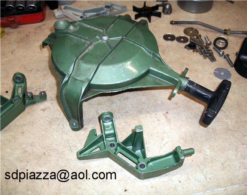

              #281761
              Steve D
                That’s a great save from the scrap pile Jeff. One of my favorite motors. The cover on that one looks great.
                The recoils from 5.5, 7.5, or 18/20/25 will not work. I think only 1949-1955 QD recoil will work. And the mounting brackets might be one year only. Email me at the address in the picture.
                recoil-and-bracket

                    Like Steve says, those parts are fairly unique, later model stuff will not fit.  The 1955 10hps were unique in a few different ways from later models.
                    Nonetheless, this is one of my all time favorites as well.   I’m sure you will find the pieces you need eventually, this engine is worth the effort.  Hoping Steve can help you with the needed pieces.

                      I am going to purchase those parts from Steve and appreciate being able to locate the parts so I will have a complete engine.  1955 must have been a transition year as usually there is a lot of parts overlap.
