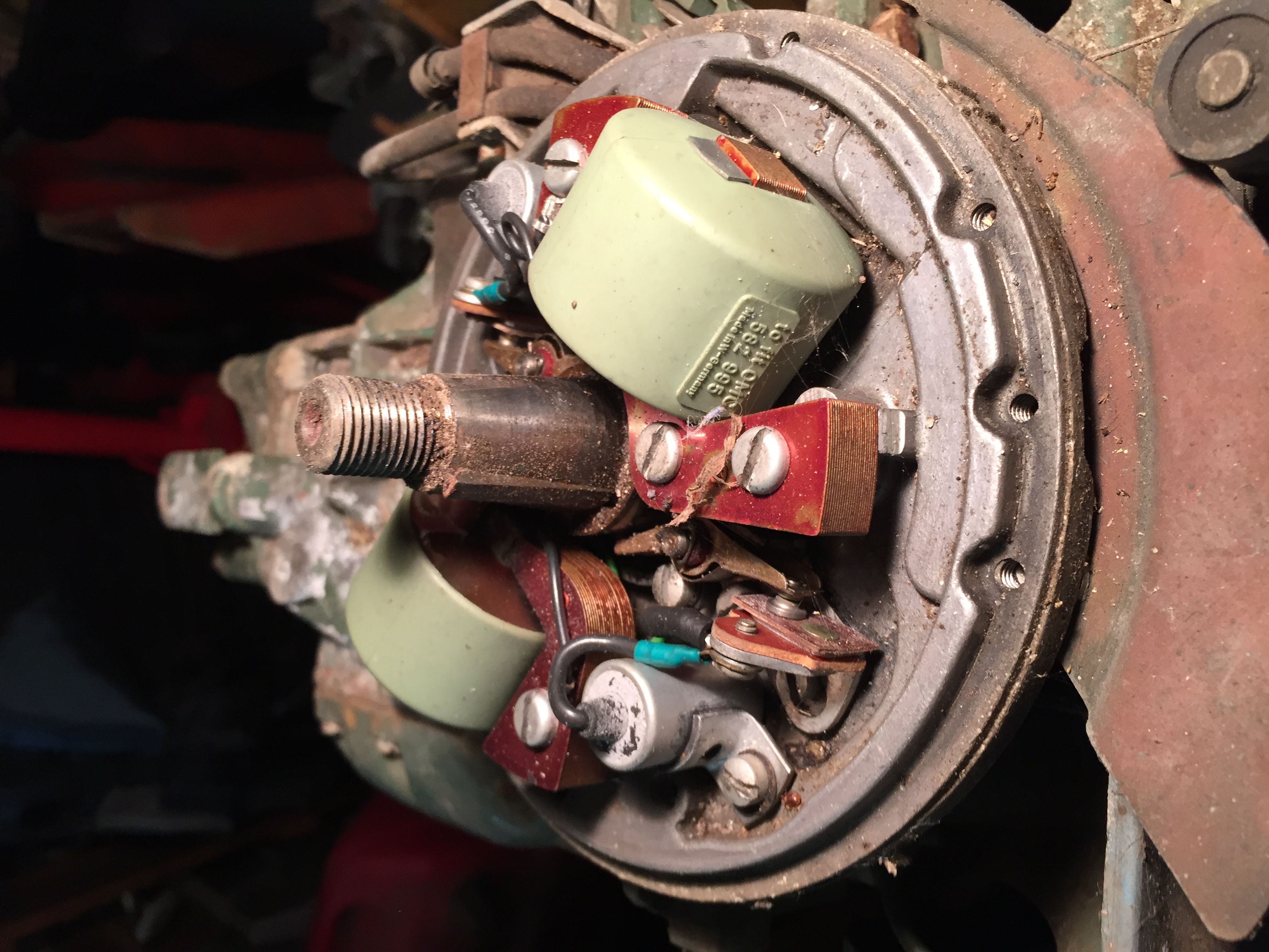

      There is no electric choke on this motor. I forgot to mention checking the ignition timing of this flywheel to make sure it is correct. I need to clean out the cylinders first so the flywheel will turn freely. At this point I don’t know if this will become a runner or parts donor. Thanks for your help.
      #48327
        I can tell you that the ignition timing is the same for all Big Twin series motors.
        #48331
        brian
          Thanks Frank. I will check that one off the list. I would assume the crankshaft and flywheel taper is the same but I’ll check anyway if nothing more than to make sure the fit is good and the parts are not damaged. I can only wonder why the recoil is not with the motor. Maybe the flywheel height interfered or the owner didn’t want to fool with a recoil or it could have been broken and not replaced. The nut on the crankshaft looks about the right height though.
          #48332
          ADAM GIBB
            Frank, Good to know about the timing, I knew it was the same for all of the 36 CU motors. Was not sure about the later ones.

                #48422
                brian
                  Flywheel was just about normal coming off, modern coils that need new plug wires, and a strong running starter all add to the possibility of getting this engine running. Next item is the cylinder head and a look at what was left behind by something.

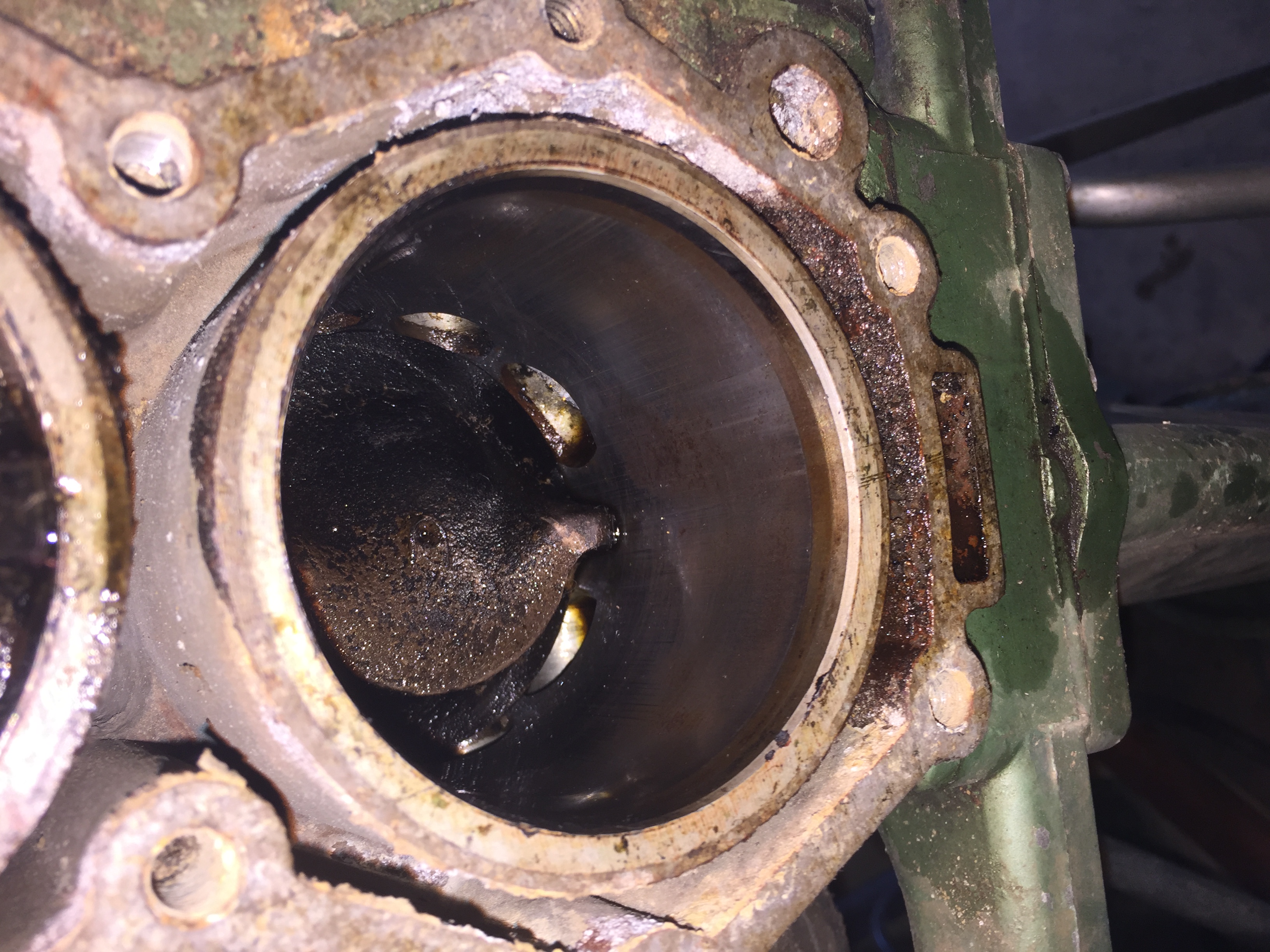

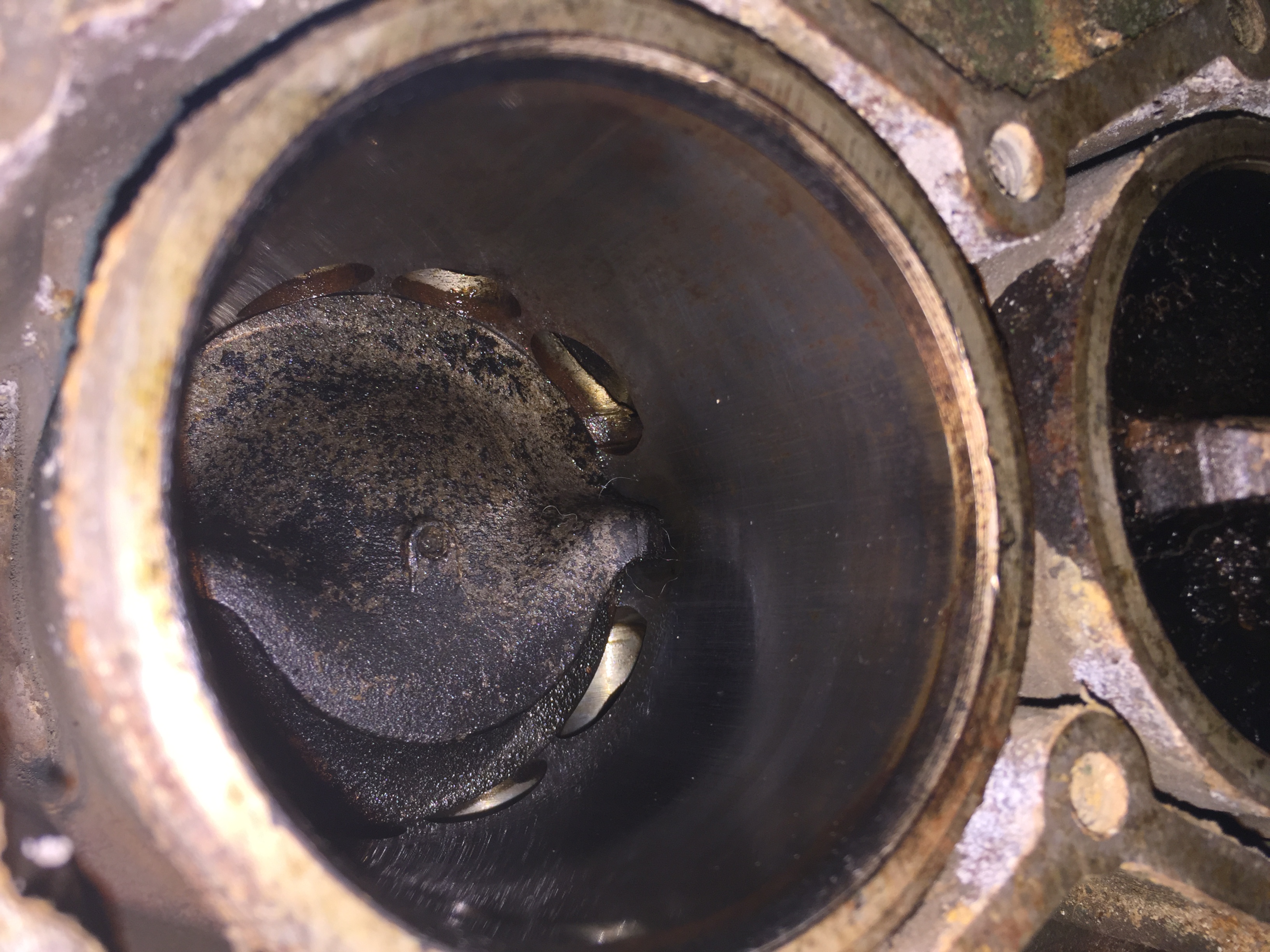

                  #48465
                  brian
                    The cylinder head fell off in my hand when I removed the last bolt. Nothing in the cylinders just some debris in the
                    Water jackets. Very light scoring that is not detectable.
                    Crankshaft still turns tightly inspite of all the lubricant I added. Next will be removal of powerhead to locate the cause of the binding.
                    #48475
                    ADAM GIBB
                      It looks like there is some light rust on the cylinder walls. It may be worth opening up the crankcase to clean that up and make sure that there is no rust on the main bearing surfaces and free up the rings.
