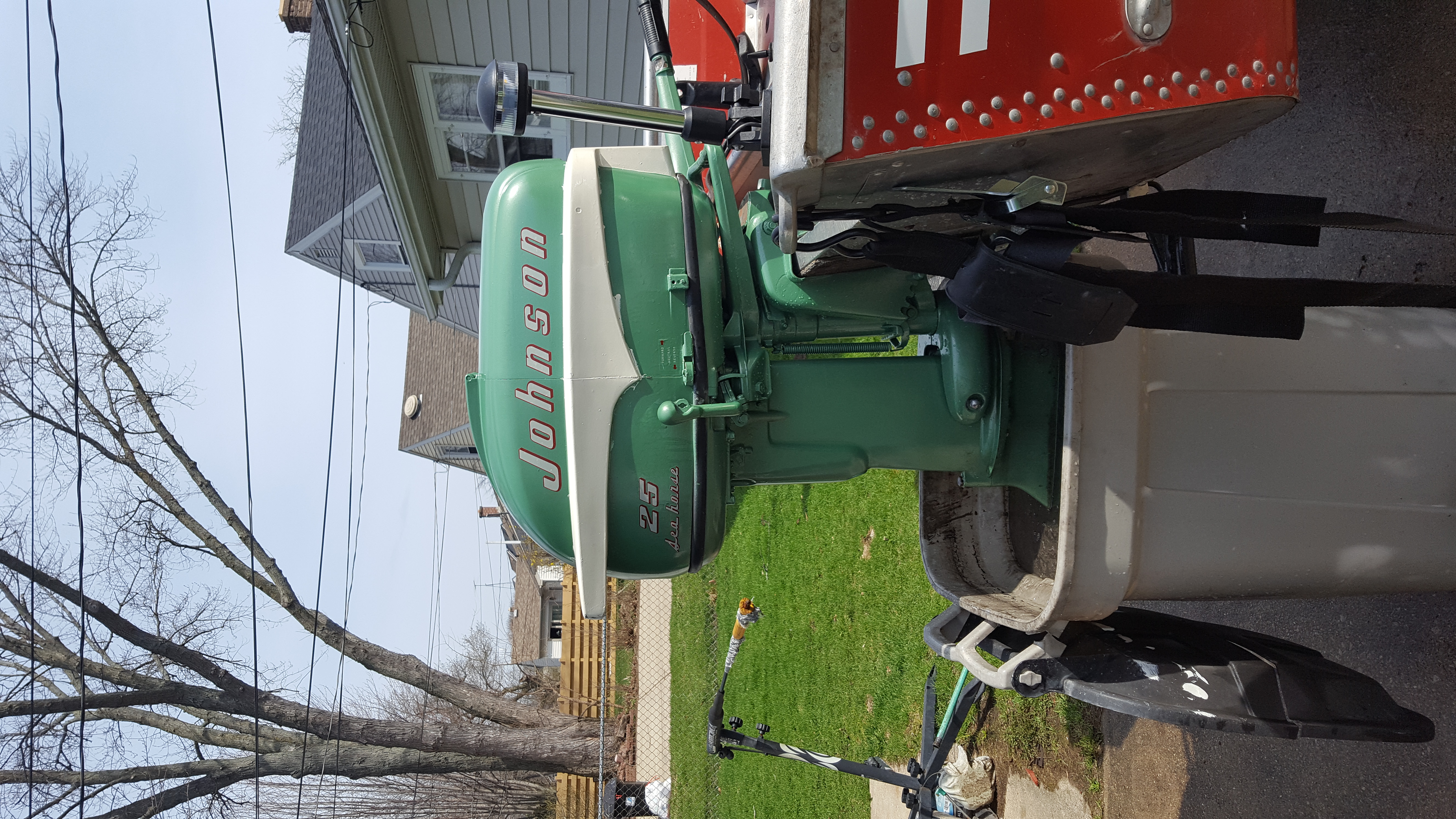

      I have a 1955 Johnson 25hp. I believe it is a rd16s.
      Motor runs like a swiss watch and its my weekly user. It is however finiky about which 2 line pressure tank i use. (I have 1/2 a dozen). I am sure it was never converted to a fuel pump and i struggle to believe all tanks are bad. When the tank gets down between 1/3 to 1/2 a tank it will.not run. Does this sound like a reed valve issue. I keep scratching my.head, because if either the tank or reed valves were bad i doubt it would run well at all.
