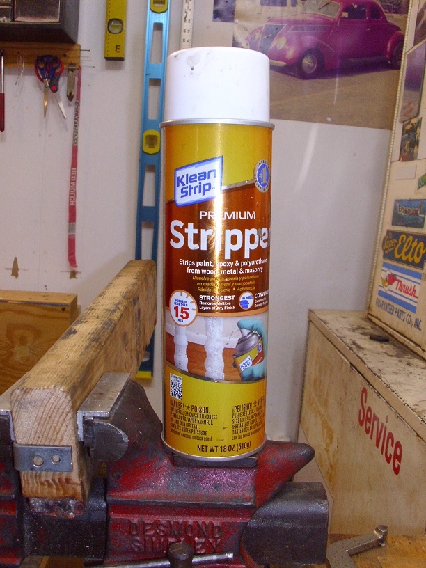

          This is what I use.
          Works well for me .
