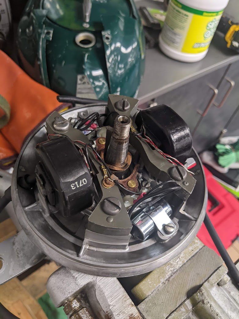

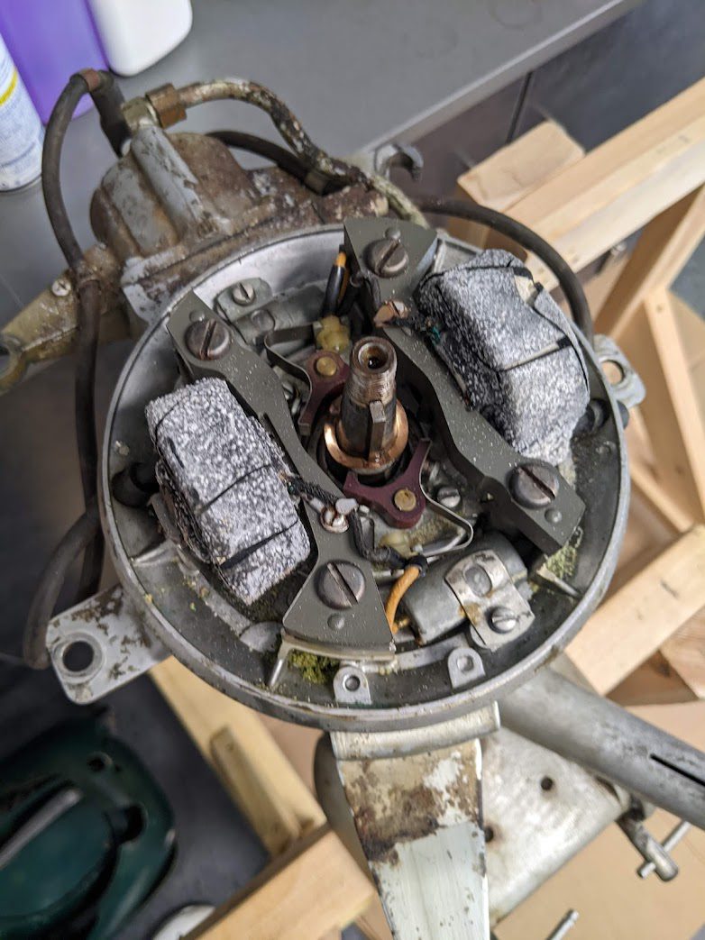

                  #258745
                  JordanSewruk
                    Here is a before and after picture. PXL_20220316_185151542
                    PXL_20220419_180156273
                    #258749
                      Nice job.   Where did you find your new coils?
                      #259114
                      JordanSewruk
                        wholesalemarine.com
