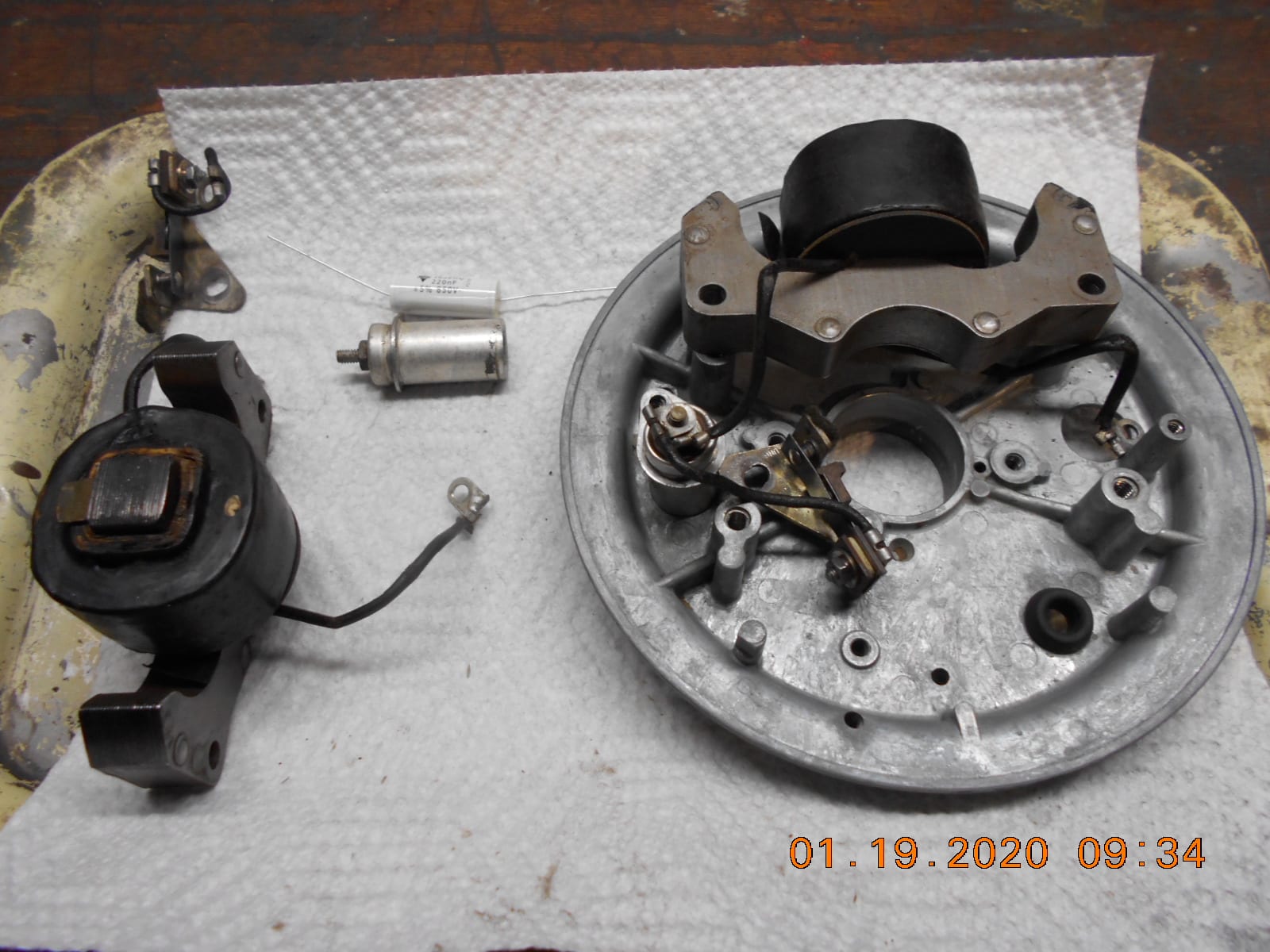

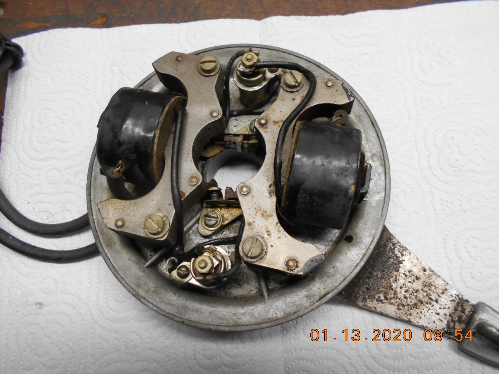

              Does anyone have a diagram or information on the Merc KD4 points? Somene took the points off and I am not sure as to where all 4 wires go. thanks again

                green-thumbs
                  Mercury KD4 might have either Eisemann 72H or Bendix Scintilla K2-A#
                  magneto. Comprehensive information can be found online covering
                  each brand.
                  Tillotson AJ8 carburetor is also cover at length online.
                  Search of internet is sometimes frustrating. but, the information is there
                  for the above items.

                      #233170
                      Boonie
                        This may help
