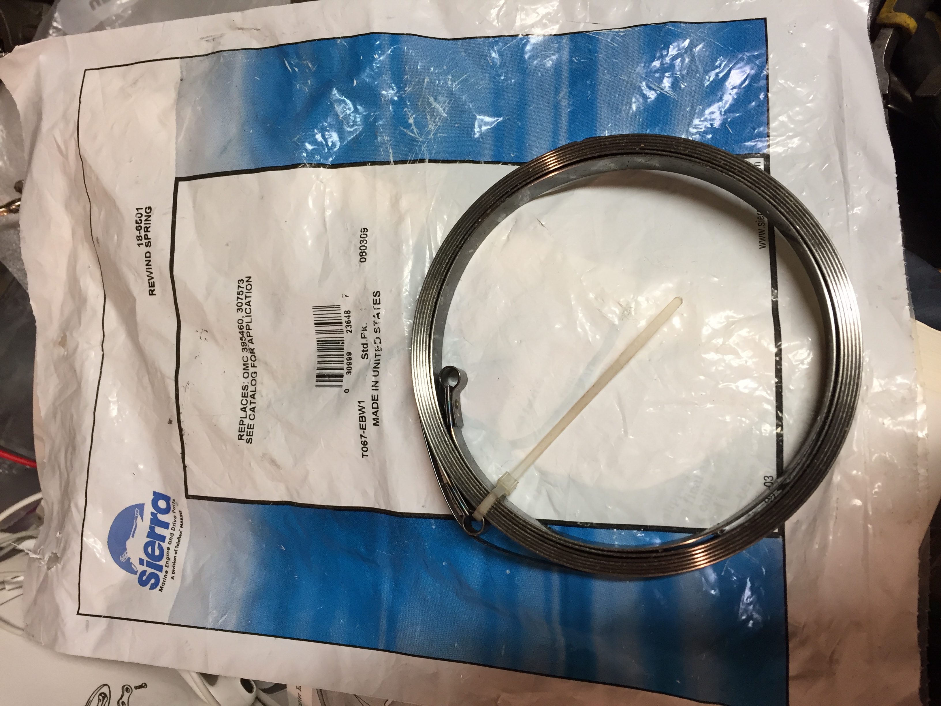

      I am trying to find a correct recoil spring for my 1953 super fastwin. I think the number i need is a 41-197. This seems to be a very standard recoil spring for most models during the 50s regardless of whether it was the earlier standard recoil or the later eliptical style. The RD/Bigtwin appears to be an exception with a different part number (375836).
      I bought these sierra springs a few years back and the OMC number it is supposed to replace is 395460 and 307573. Maybe one of these earlier numbers (41-197, 375836) superseded to these OMC numbers? Anybody know for sure?
      I don’t know whether this spring will fit or not. Any help would be appreciated!

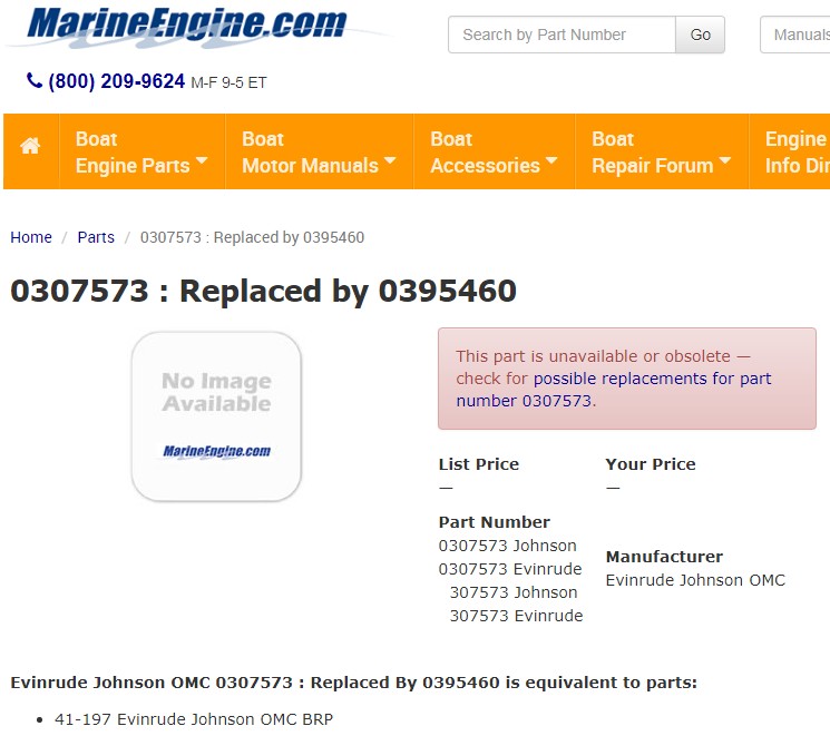

        According to this you have the right stuff.
        http://www.marineengine.com/newparts/pa … OMC0395460

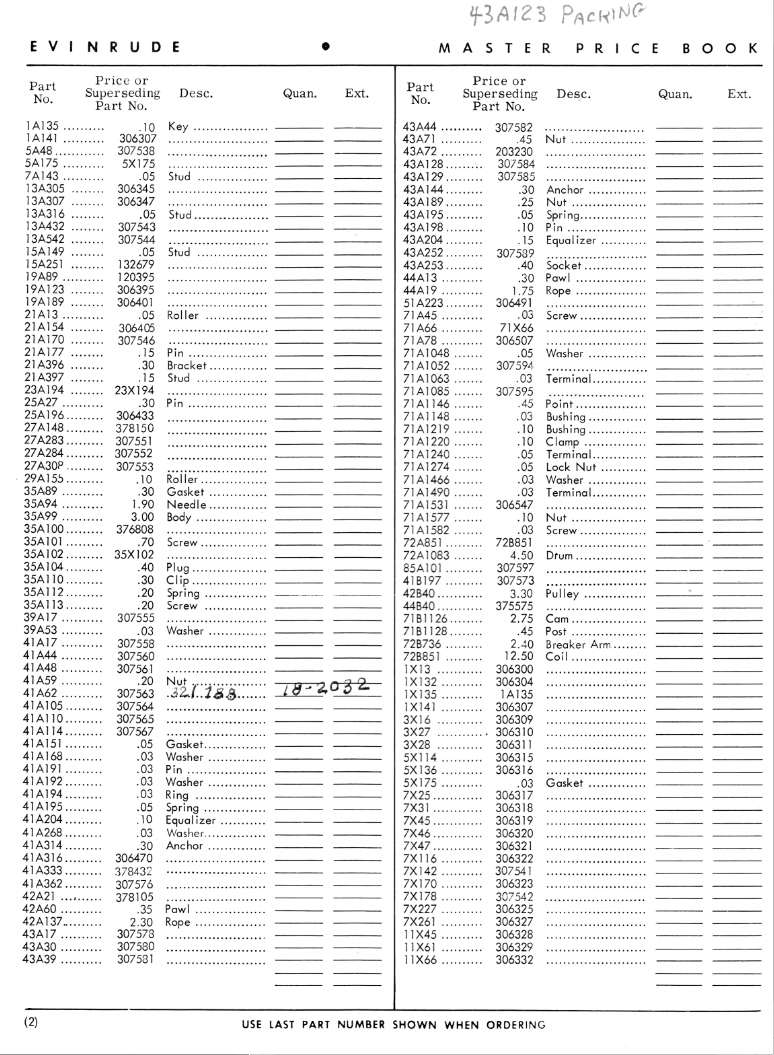

          Garry posted this before and it shows that 41-197 (previously 41B197) superseded to 307573. Frank also mentioned once to convert numbers with a dash, remove the dash, add a zero(s) in front to make it a 6 digit number and punch that in and you should get the superseded number, in this case 0395460. So as Dave mentioned, you’re good with this for your Fastwin.
