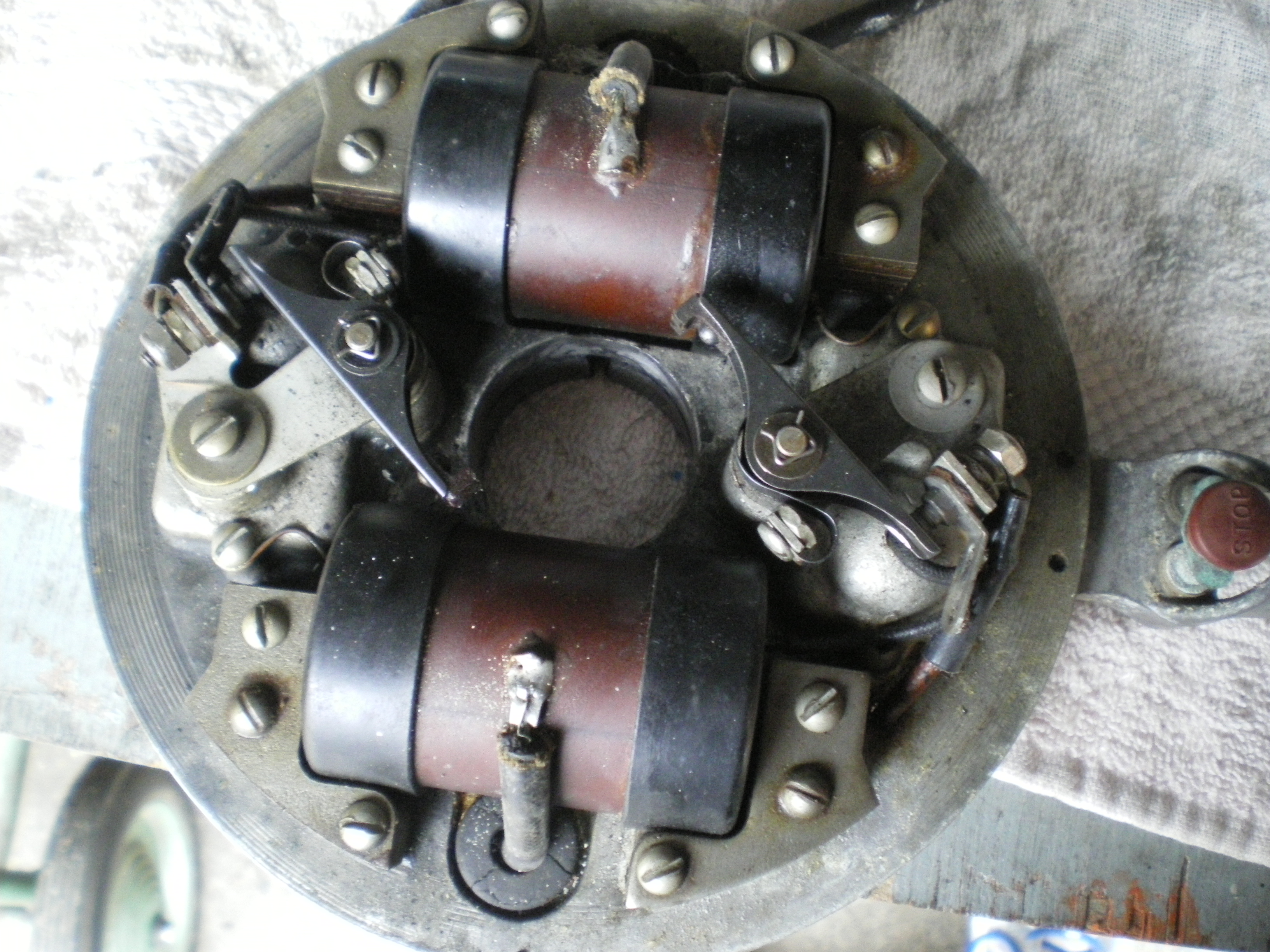

          Ok. Back to this one. I took it out for a spin and it lost spark on one cylinder. I pulled the flywheel and cleaned the points again but still have no spark on that cylinder.
          So for my green guy questions. How do I check a coil that doesn’t have connections I can loosen? And, I was thinking it may be the condenser going bad. They are under the mag plate? Availability?

            #71116
              Early models had a single coil and two flats for the breaker points. The flywheel acted as a distributor, shorting out the un used spark plug wire. I am not sure when they switched to the two coil system. If it has a single coil, look for a short in the distributer system. Cleaning usually fixes it. . . 🙂

                #71127
                  quote Bullie:
                  You can’t. Well you can but it’s better to break out the tools and undo the coils primary lead at the points. The other way would involve isolating the condenser from ground and preventing the points from making contact before hooking up your meter.
                  If my memory serves me right, I think the square caps in my KA-37 were good and didn’t need replacing. If I did swap them out, I would have used these .22 uF Vishay caps from Digi-Key which I have used successfully in many motors.
                  https://www.digikey.com/products/en?ven … =bc2609-nd
                  I think this mag was out of a KA-38 so it should be the same as yours.
                  #71131
                  bullie
                    Yep. Looks like that one.
