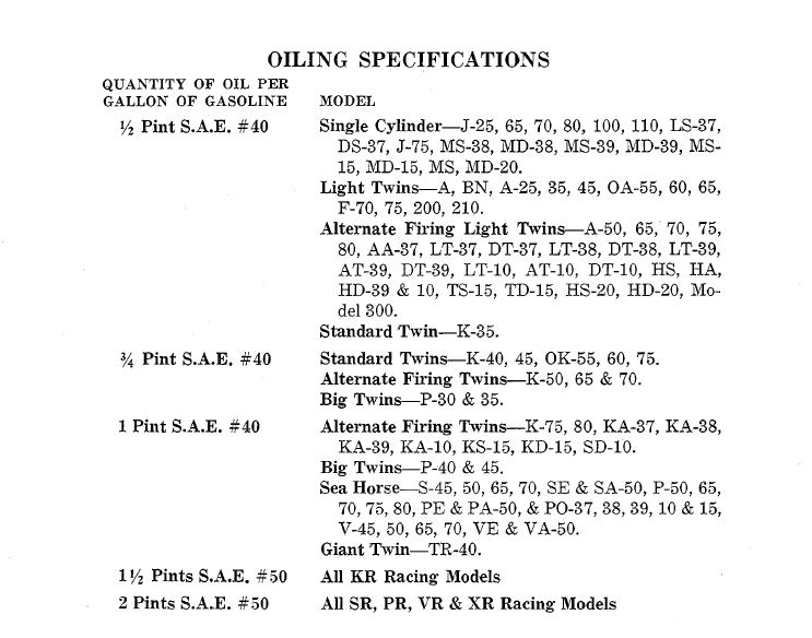

          Those motors like drinking their fuel mixed at 8:1 ratio.
          #71247
          bullie
            Yep. Had it at 8 to 1.
