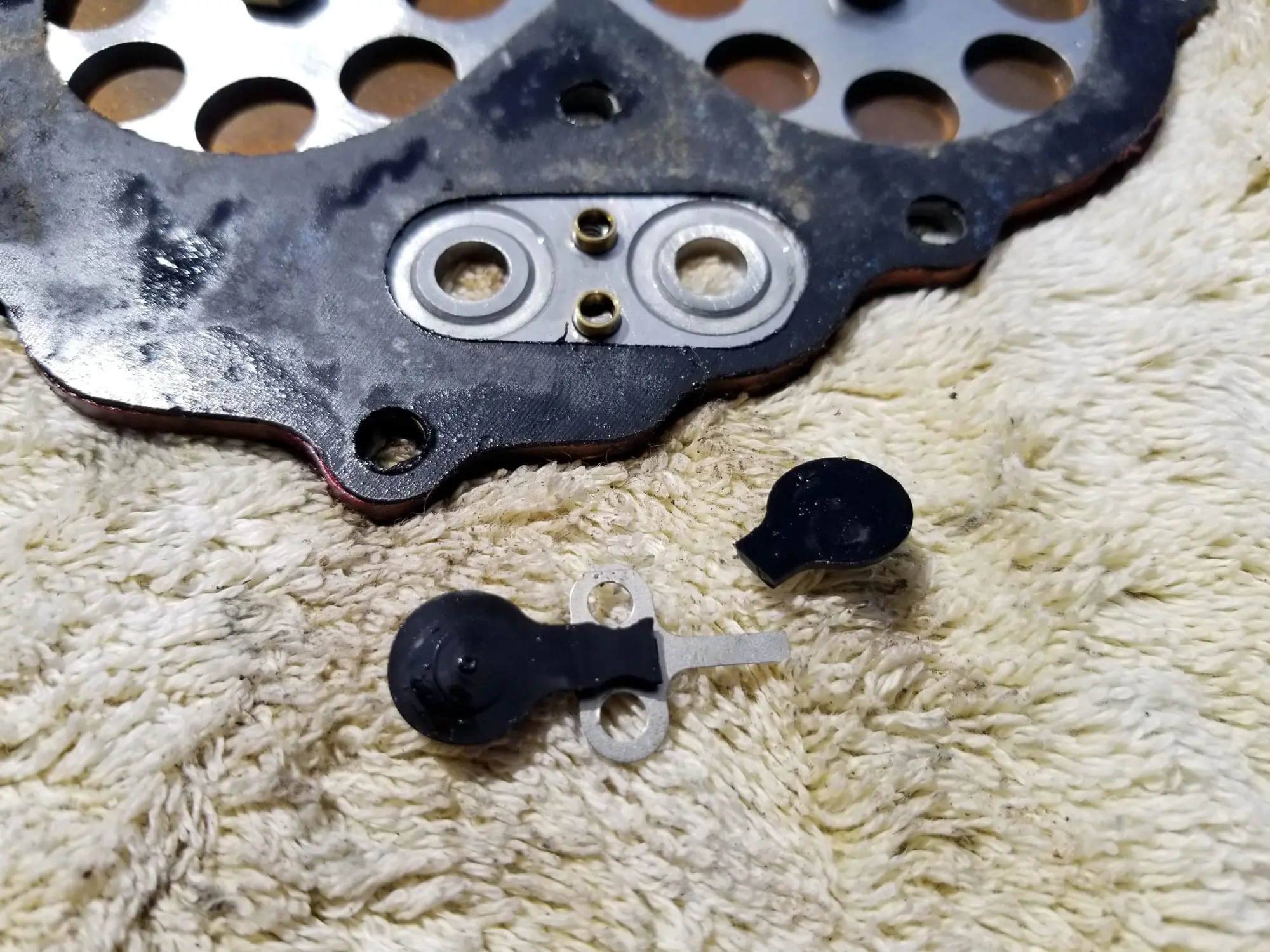

      seakaye12
        If the original poster was referring to this valve assembly…..they control fuel pressure and the associated pulses.  When they are broken like this one is….your pressure tank will not develop pressure properly.
        Pressure-Valve-2-OMC
