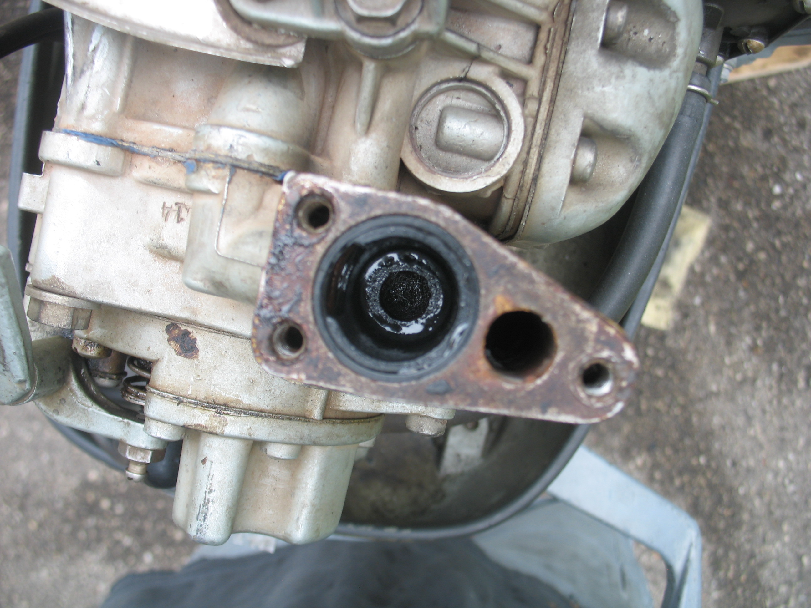

August 24, 2016 at 7:10 pm #42607quote opposedtwin:Well…maybe I pulled it too soon. I tested the little bugger in some hot water on the stove and it appears to open and close. Still, if I couldn’t keep my hand on the housing, isn’t that too hot? Does anyone happen to know at what temp these things are designed to open? To repeat, it’s a 1959 lark.

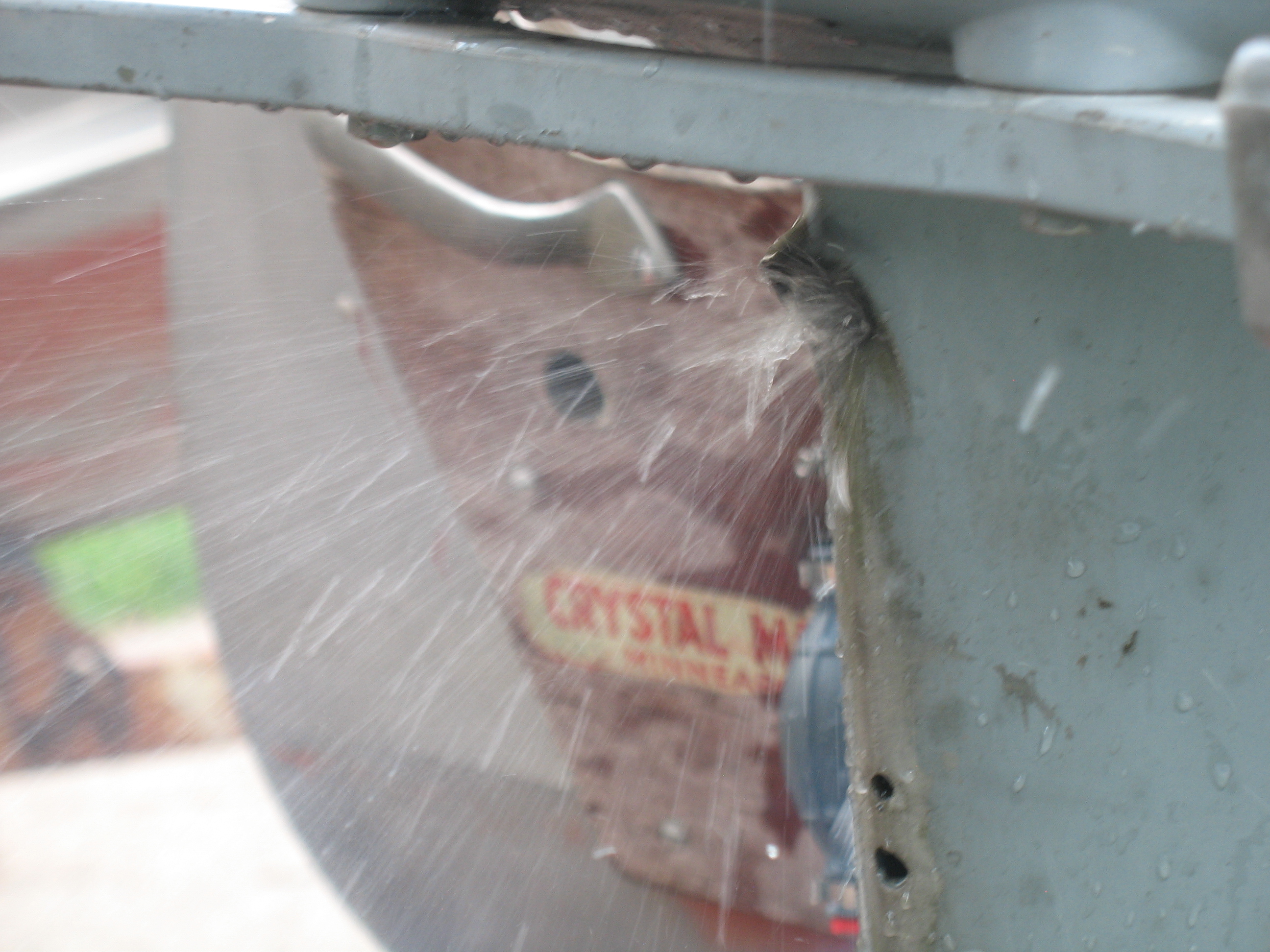

LarryAugust 31, 2016 at 1:38 am #42991well, I re-installed the t-stat after seeing it function properly on the stove top. today I tested it in a barrel and on the water. it pumped in a most beautiful way the whole day! i’m guessing jeff was right. it sat for a couple years and was probably stuck a bit. here are some pics of the water pumping and of the innards.
one less thing I have to worry about! 😀
August 31, 2016 at 4:04 pm #43042Glad you got it cooling – I’ve also got a ’59 35 lark. If it sticks again, get Sierra #18-3553, or 18-3672 gets you a gasket with it. #18-3674 is a complete kit with gaskets and spring.
