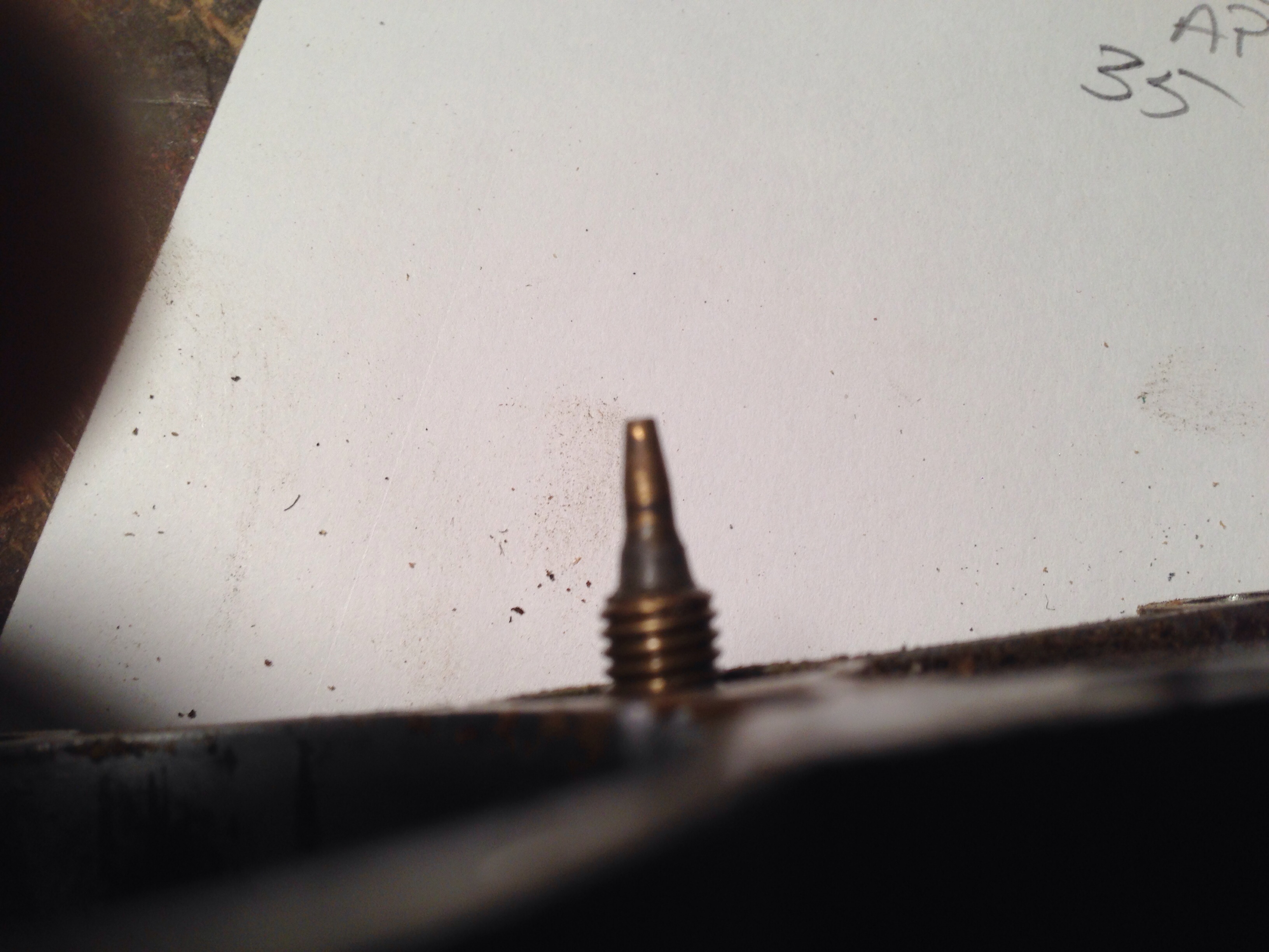

      Does this look right or does it need to be replaced?Shape looks really worn to me.
      #50817
        It looks really worn to me also. Back when I had the use of a lathe.
        #50819
        melugin
          I have managed to renew a point on something similar by chucking it up in a drill and running it against a whetstone.
          #50824
          fisherman6
            I agree, that one looks very worn. Another way of restoring the point is to chuck the needle in a drill motor and secure the drill motor in a clamp or a vise. With the drill motor secured and turning the part, carefully reshape the tip using a clean, sharp single cut flat file. I have made a number of different small turned parts using this method before I got a real lathe. The biggest challenge with this part is that it is worn enough that a number of threads will have to be taken away to restore the point to a taper that closely matches the original. It certainly can be done, though.
            -Ben
            OldJohnnyRude on YouTube
            #50825
              Unless you can reshaped the seat as well
              you’ll likely only be making things worse.
              The shape of the needle mirrors the shape
              of the seat. Changing one and not the other
              can make adjustments so sensitive that you
              can never get to a proper setting. If the
              carburetor is not functioning as it should now
              the solution is to replace it.
