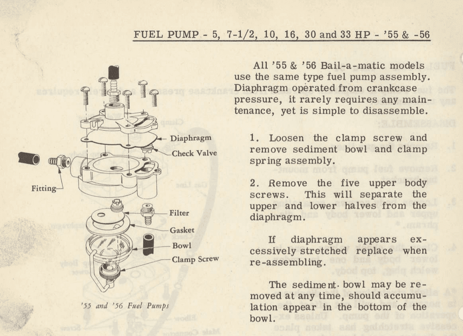

      Fuel pump is repairable.  Here is a screenshot from the book.
      fuel-pump

            OK..I am having a problem finding the impeller replacement instructions for the 1956 16HP with bail-o-matic motor within this manual. I found the ’55. It that the same as the 56?
