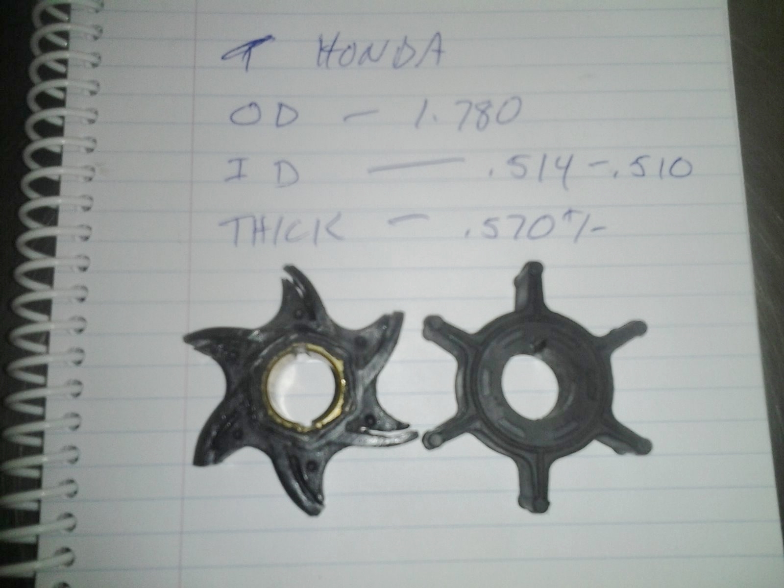

March 9, 2017 at 11:40 pm #54054OK, I made it to the Honda dealers today and they had the mentioned 8-9.9 horse impeller in stock. The measurements for it in the photo are the closest I could get with my calipers. Scott on the left, Honda on the right. It’s pretty dang close! The measurements are in inches, not metric.
March 10, 2017 at 12:55 am #54058Thanks for the info Mumbles. Sound like the Honda impeller is worth at try!

March 10, 2017 at 3:06 am #54068I found some better specs for the Honda impeller.
OD……………..45.04 mm
ID………………13.35 mm
Thickness……..14.77 mm
