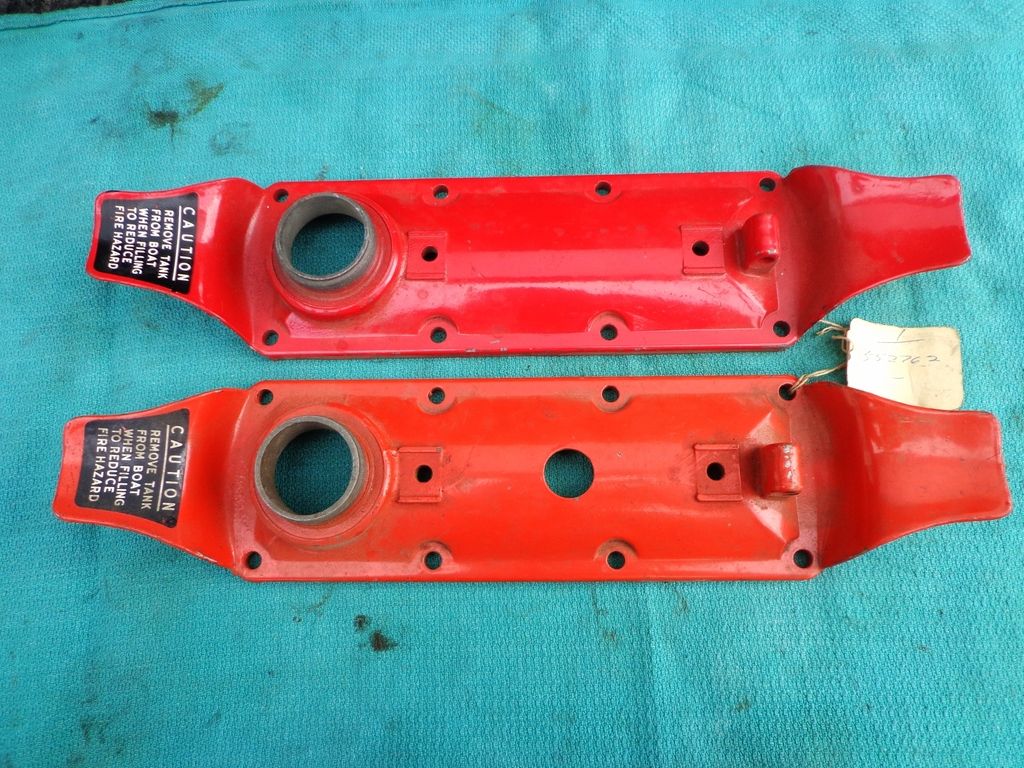

        Any Johnson or Evinrude or Gale non-pressurized tank and hose will work. But if you are looking for a "correct" restoration, the Sea King (Gale) tank was actually the Evinrude or Johnson pressure tank shell with a different top housing, and single line hose/primer bulb assy. Some had "Bosun" decals, some generic.
        #21864
          Here’s two different Gale style tank tops. I believe the hole in the bottom one is for a fuel gauge.
