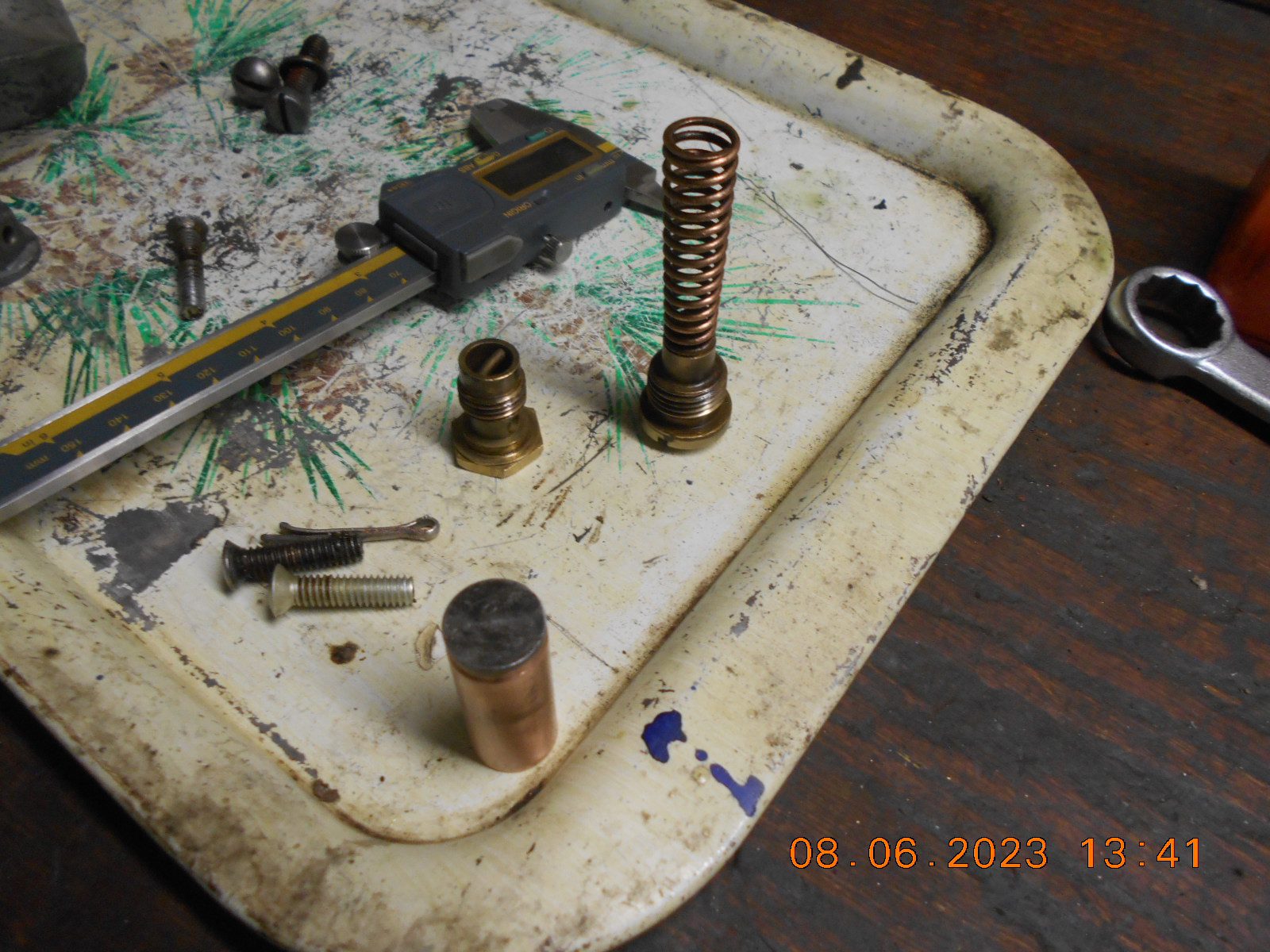

      I was brain-storming on the 1946 Sea King 64EA-9008A,
      3.3 hp, twin opposed again today.
      I had it briefly running in the barrel a while back, and the piston pump wasn’t
      pumping any water, at least not as high as the powerhead.

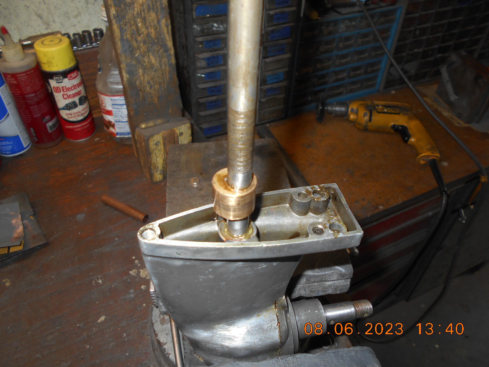

      I managed to get it to pump water about 10″ up, very anemically, with lower unit
      removed, and using a drill. It’s a “strange to me” pump, as this one evidently
      doesn’t have a discharge check ball.

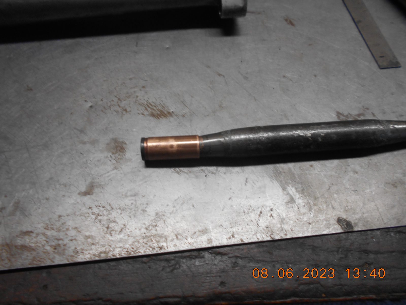

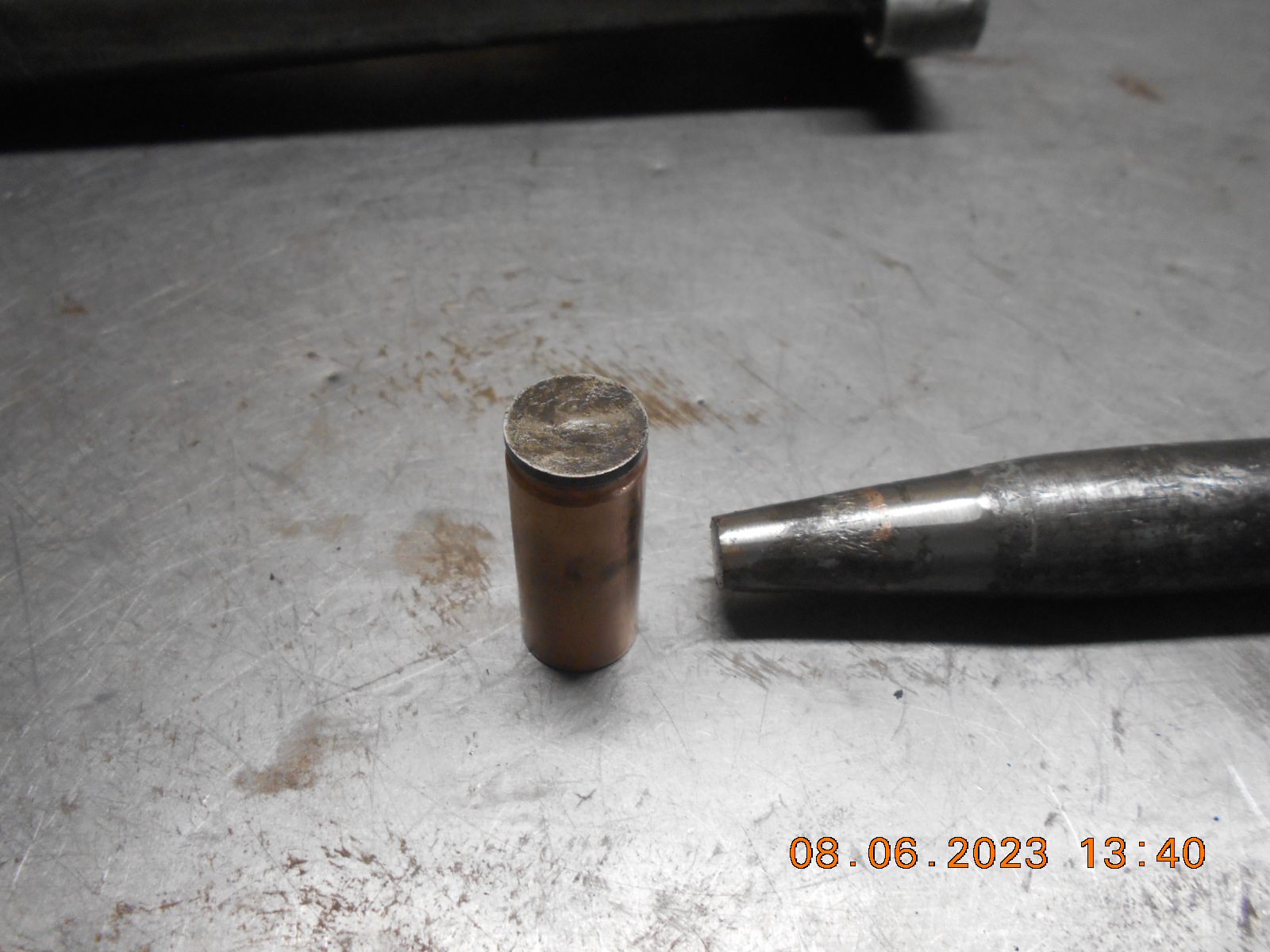

      The piston was a little looser in the cylinder bore than I liked, so today
      I swedged out the open end of the brass piston, using a bull punch, so it fit tighter in the bore,
      as that’s the end that pumps the water.
      Further brain-storming (or lack of a brain-storming), I was wondering if I added some
      “meat” on the piston hard facing, that it would improve pumping action by bringing
      the piston a little closer to the discharge hole in the cylinder?
      While the driveshaft cam nor the piston hard facing, looks very worn,
      the cam only provides 3/16″ of stroke on the piston.
      The hard facing on the piston is only .080 thick.
      What’s the best was to build-up the hard facing, with the least likely
      chance of ruining the piston?
      I was thinking about trying to silver solder a dime onto the hard facing.
      Would that work?
      Thanks.DSCN7688
      DSCN7687
      DSCN7689
      DSCN7693

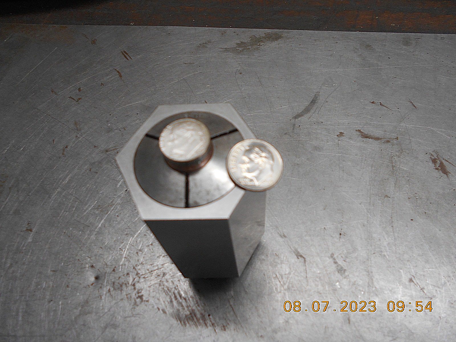

            My piston repair on the water pump seemed to be helpful, as
            it’s now pumping water. The carb adjustment is very touchy,
            and the port side exhaust gasket is leaking water (water cooled muffler),
            and I’m not sure if some water could be getting into the port cylinder,
            causing the erratic running?
            At least the coil swap seems to be working good.
            VIDEO
            https://youtu.be/yO5WNXc_WCU
            Hopefully the Feds won’t come after me for the destruction of the dime!
            I ground the hard surface on the piston square on the belt sander to
            get it nice and clean, then silver soldered the dime to it.
            Then chucked in in the lathe and turned it down to the correct OD.
            DSCN7696
