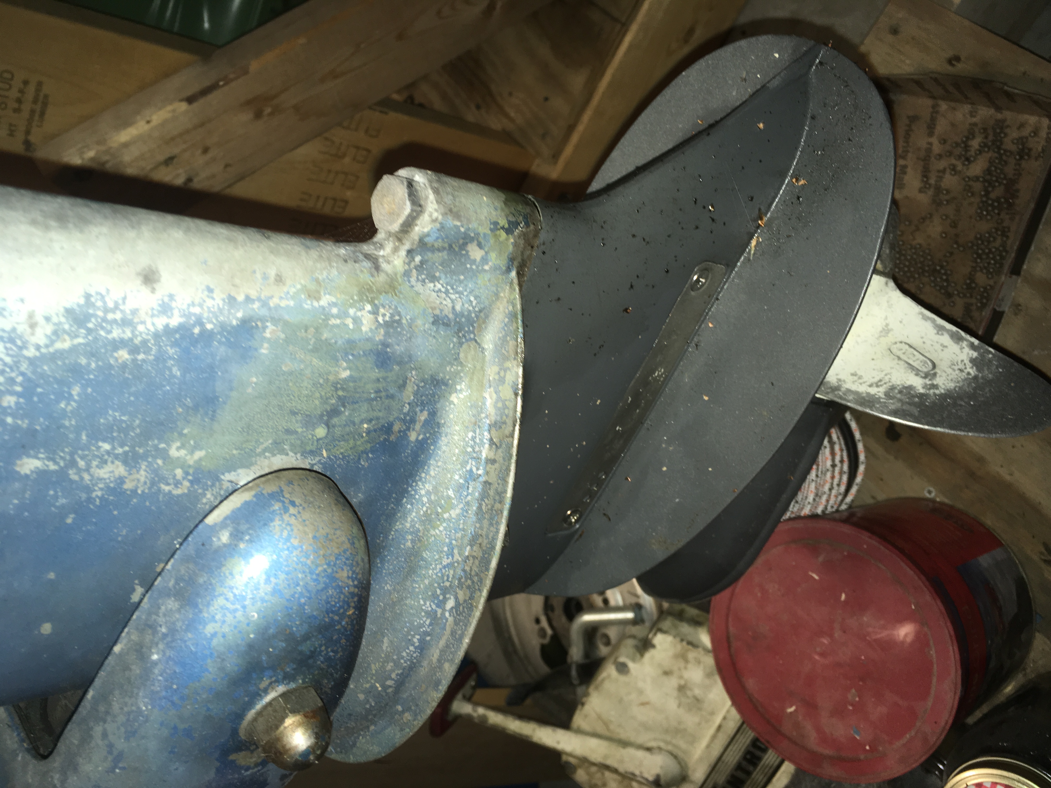

      So,1946Zephyr, how do you recognize the 5 bolt lowers?

      1946zephyr
        You have the 4 smaller 7/16 hex bolts and the larger 9/16 hex bolt at the very back of the exhaust housing. It was used on the following models:
        10 hp 1955 – 1957
        12hp (not sure of years)
        15hp 1955 – 1956
        18hp 1957 – 1973
        20hp 1966 up
        25hp 1969 -1976
        Those are just my guesstimates, but they’re close. It was a very common lower in the J/E and Gale motors. Gale brands had the 12hp deluxe motors with it too.

          So these bolts (2 different sizes) are under the hood (?) where the exhaust bolts onto the power head? I thought "lower" meant the bottom half of the whole motor. The blade, skeg, and covers for the right angle gear and so on(?) If I’m going to shop for this I need to know what it looks like.

          fisherman6
            Paul, The bolts are not under the hood. The bolts are on the lower portion of the exhaust leg where the lower unit connects. There will be the usual (4) 7/16′ hex head bolts that go up from the bottom and thread into the exhaust housing. The fifth bolt is a larger 9/16" hex head bolt that threads into the lower unit from the top down through a hole in the back of the exhaust housing. I do not have a picture at my disposal at the moment, but I own multiple OMC 10hp motors in each configuration. I can post a picture of each this evening after I get home from work if someone has not already posted some. 😉

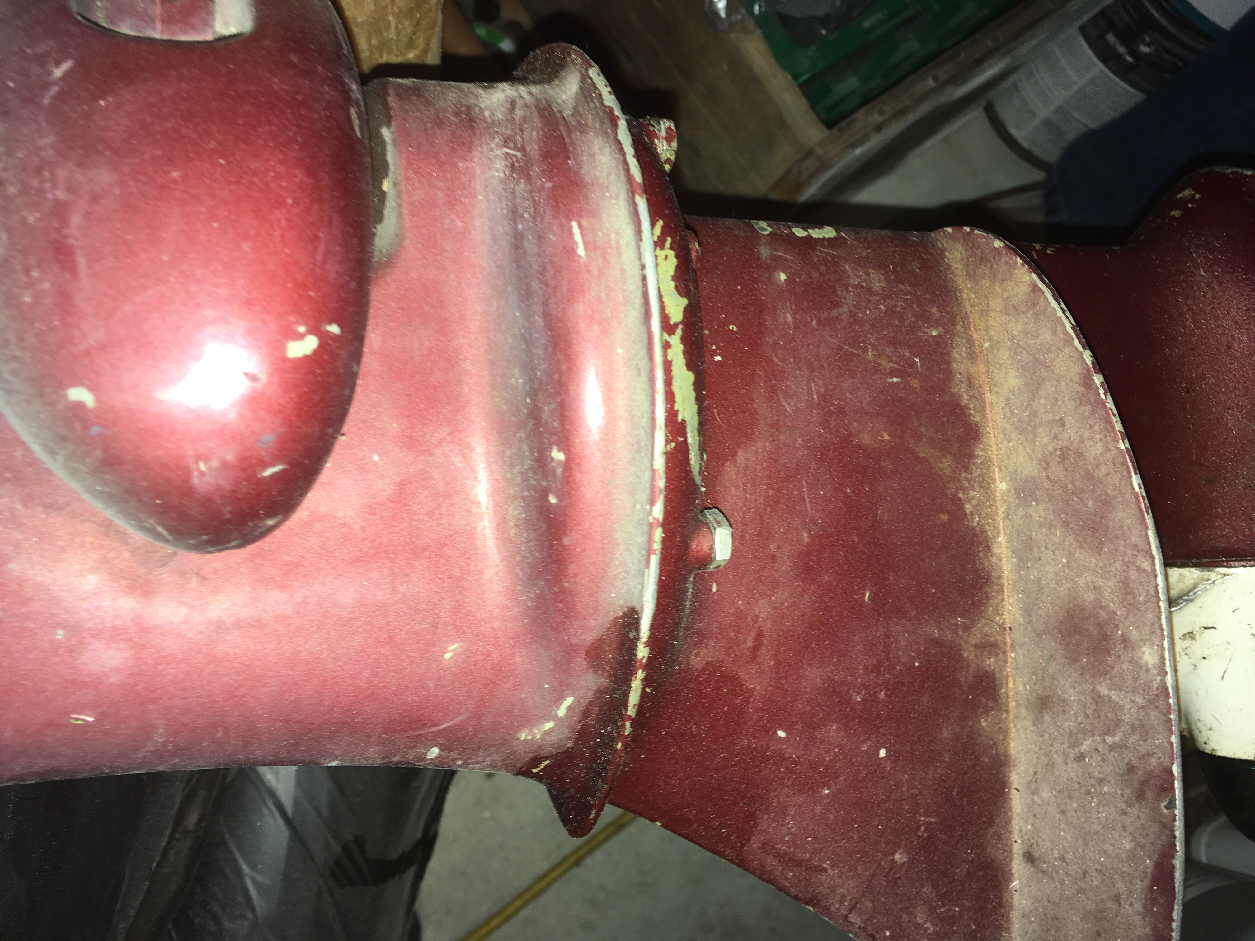

            david-bartlett
              These pics show the difference. The blue one is an 18hp with the 5 bolt lower. You can see the 9/16" bolt from the top. The red one is a 7&1/2hp without the extra 5th bolt.
