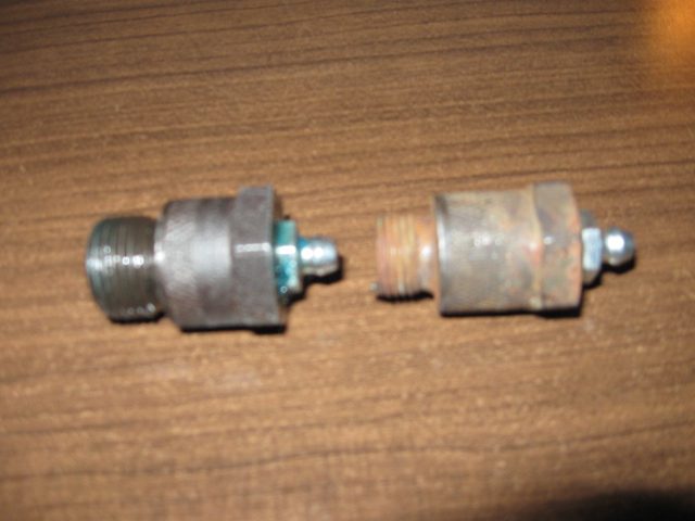

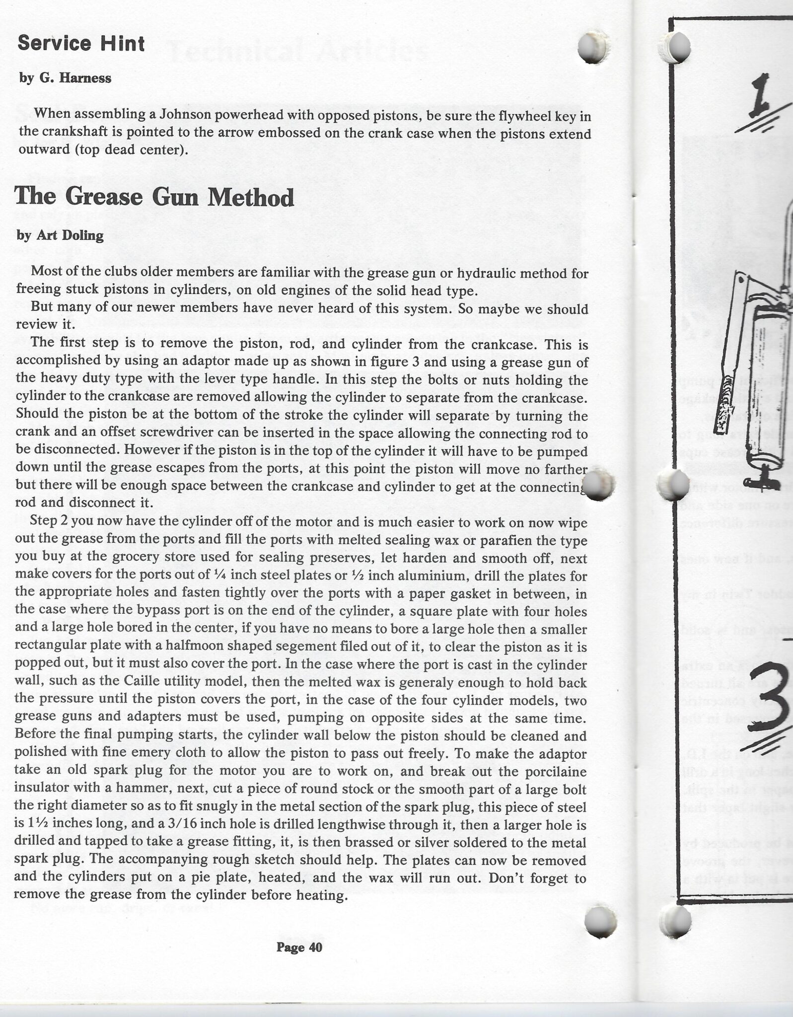

          You could use the grease gun trick the break the piston free. The piston must be near the top of the cylinder to do this. Make an adapter out of an old spark plug and a zerk fitting.

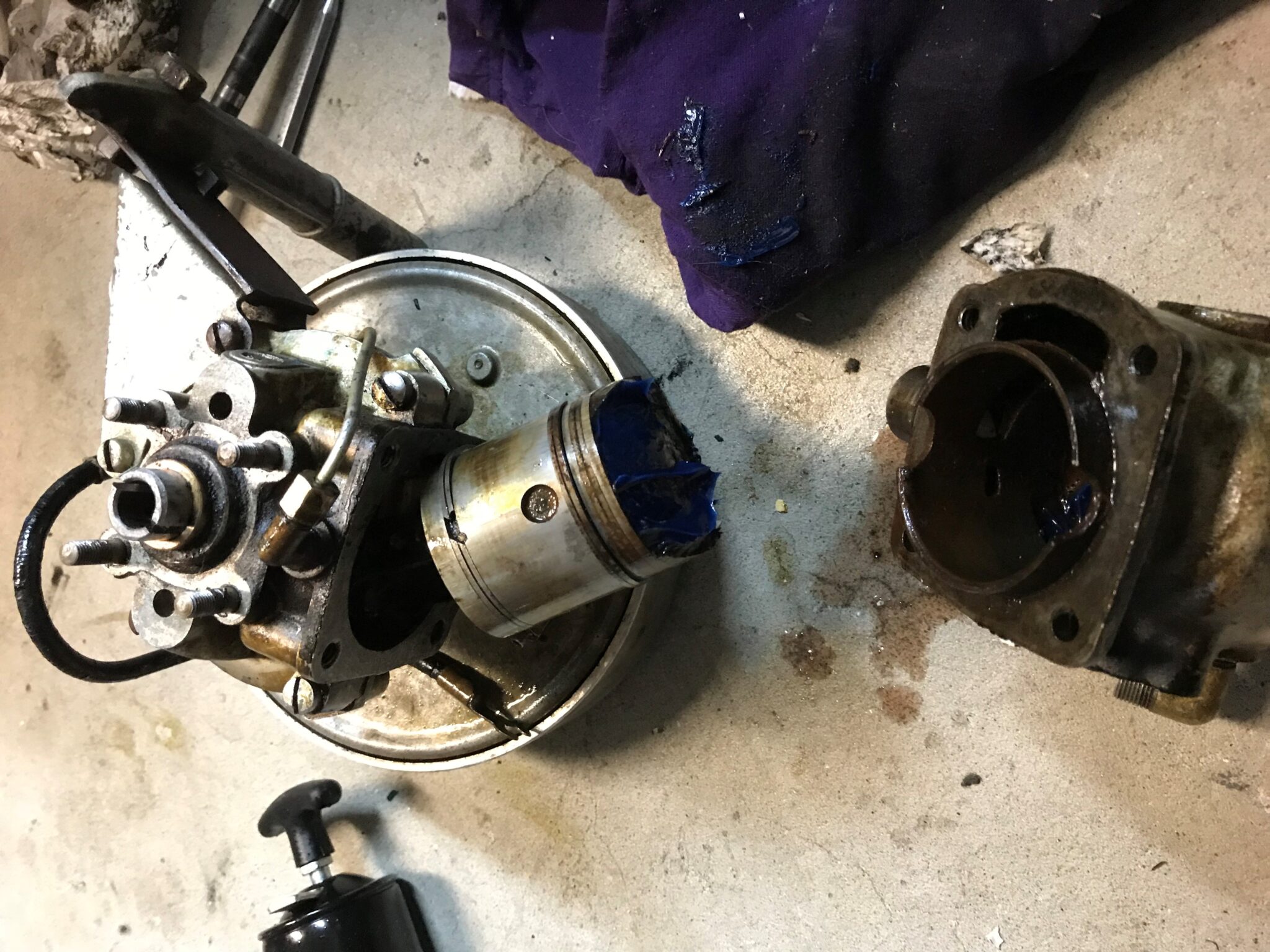

          ROBERT LAFAYETTE
            I was able to use the grease gun method to free my stuck Johnson Model 100
            Has good compression now.

            Herman Powers
              Thanks I will give it a try
