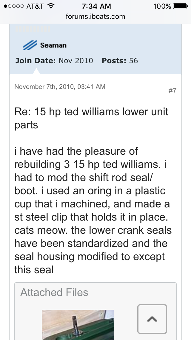

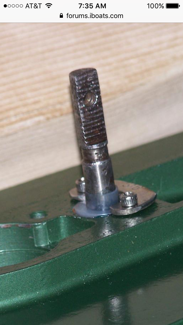

            Yeah it’s a hard part to find and I’ve looked at other engines also. Yes i do believe it is made specifically for this motor.
            I did find this article but I do not have the equipment to machine a part.
            #82547
            john8504

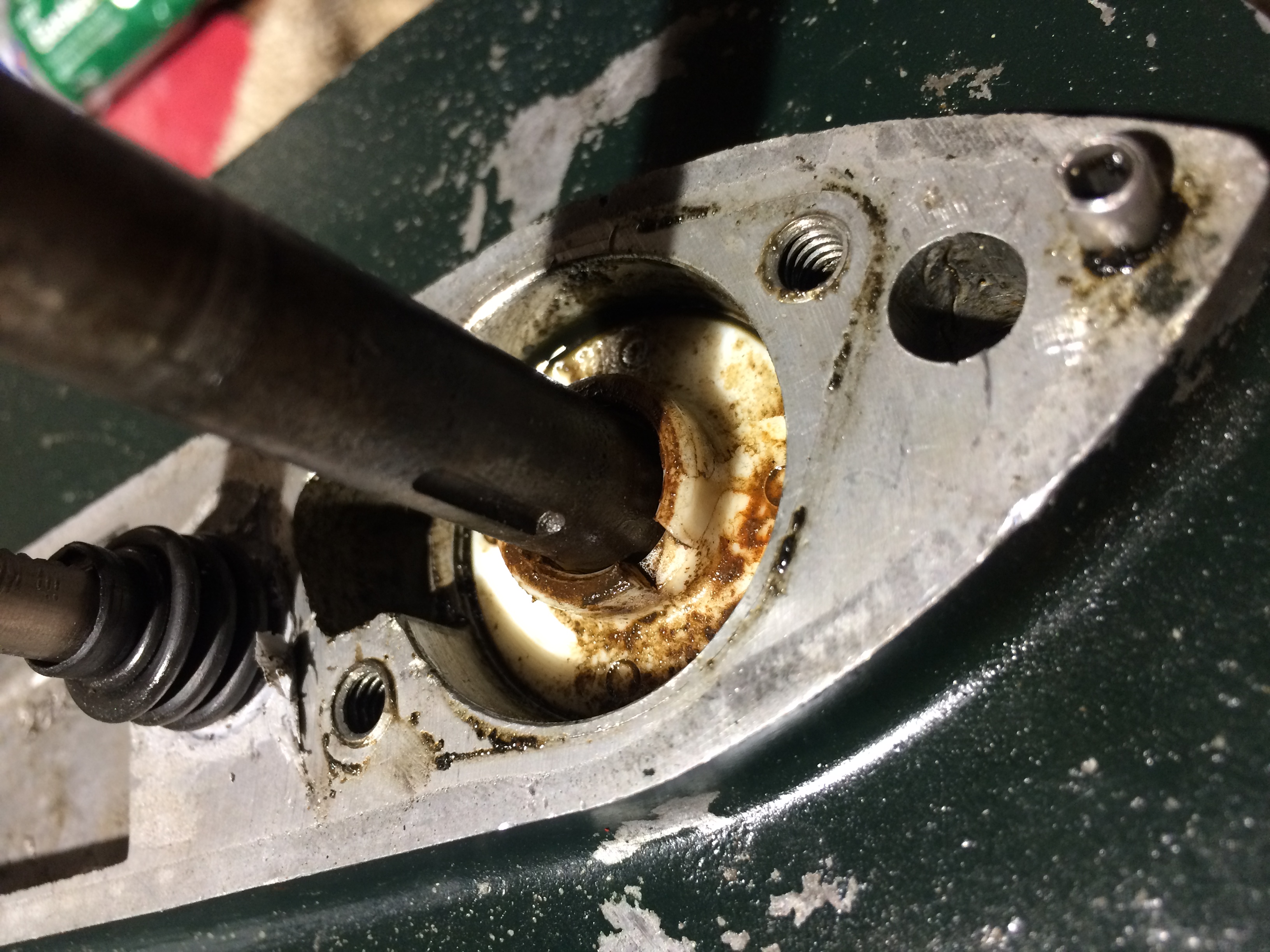

              I ended up modifying a nylon spacer to fit and it seems to be a nice fit.
              Now I found another bad seal, however I’m unsure of how to get this one out. Under the water pump plate is a plastic piece and a seal under that, in which I’m trying to get to. The only problem is that I do not know how to remove this piece. In the manual, it looks like it could unscrew but to no avail on that venture.
              Has anyone seen this or know how to remove it?
              #82549
              david-bartlett
                John,
                Looking at your picture the plastic piece might screw into place. Hard to see and I admit I have no experience with that motor. Is there a matching notch 180 degrees opposite the one I can see? If so then some sort of spanner tool might spin it out.
                Just guessing here.
                #82554
                john8504
                  Yes there is a matching notch on the other side. I’ll see if it can make a tool and try that
