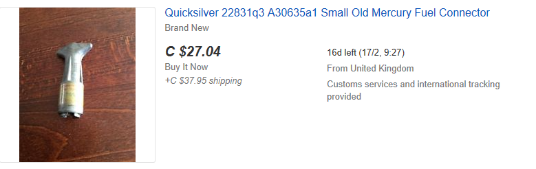

      I show a 22831Q 3 as being the larger one.. 30635Q 3 for the 3.9 thru 9.8 1971 and older
      #70338
      jpatti75
        Yep, that matches my info too, Jerry.
        Not sure if this helps any, but here are mine in each size for comparison:
        #70344
          The only problem is they did not use them in late 60;s early 70’s I would want to see it before buying.
          #70354
            My ’68 Model 60 six horse uses the small connector.
            #70379
            20mercman
              I think that the small ones were used at least through 1971. I know my 1969 110 has the small connector. Also, the small connector works with the Scott Atwater motors.
              Steve
              #70421
              rapier
                I think all the small motors, i.e, 39, 40, 45, 60, 75 & 110 had the small connector. My 1975, 45 still has it (but is a Belgian bult motor…which sometimes means use of obsolete, or excess stock parts). Eye watering prices though.
                #70426
                  the small connector is approx $75 cdn plus 15% taxes at my local Merc dealer 😥
                  As soon as ice is out and I get to the cottage (april) i’ll solve the problem either way
                  #70496
                  rapier
                    This is ebay UK, postage will be around $14 (250g, large letter, international tracked & signed, value $20). Item 112762391242
                    #70507
                      comes up to $65
                      #70543
                      rapier
                        Saw that and for some reason gave you the wrong item..apologies, it’s this one 201694277419. Ask if they’ll post – they’re a recognised marine dealer here and all it needs is a small padded envelope. All the customs services rubbish irritates me..we even have a CDN20 post office ‘handling charge’ where UK customs are involved.This just might be cheaper.
