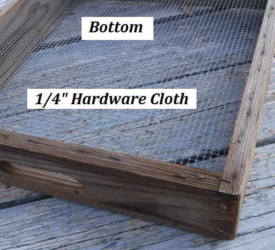

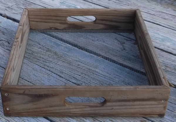

            here is one of two sifters that I made from 1×4" lumber with screen on the bottom.
            this one is just plain 1/4" hardware cloth when I was fossil hunting and the one

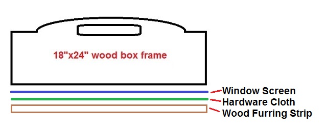

            for the media blaster has window screen on the bottom, then the 1/4" hardware cloth for support
            then the 1/8" thick wood furring strip stapled into place (like a screen door).
            the window screen alone is not strong enough to hold over 5 pounds of material and must be supported by hardware cloth.
            the next ones I make will have 1×4" for the sides and 1×6" for the two ends so I can make the hand holds higher.
            the bottom furring strip will be 3/4" x 3/4" to keep the bottom higher (just because that is how I want it).
            you can also attach handles of your liking on the outside to hold on to while you shake it.
