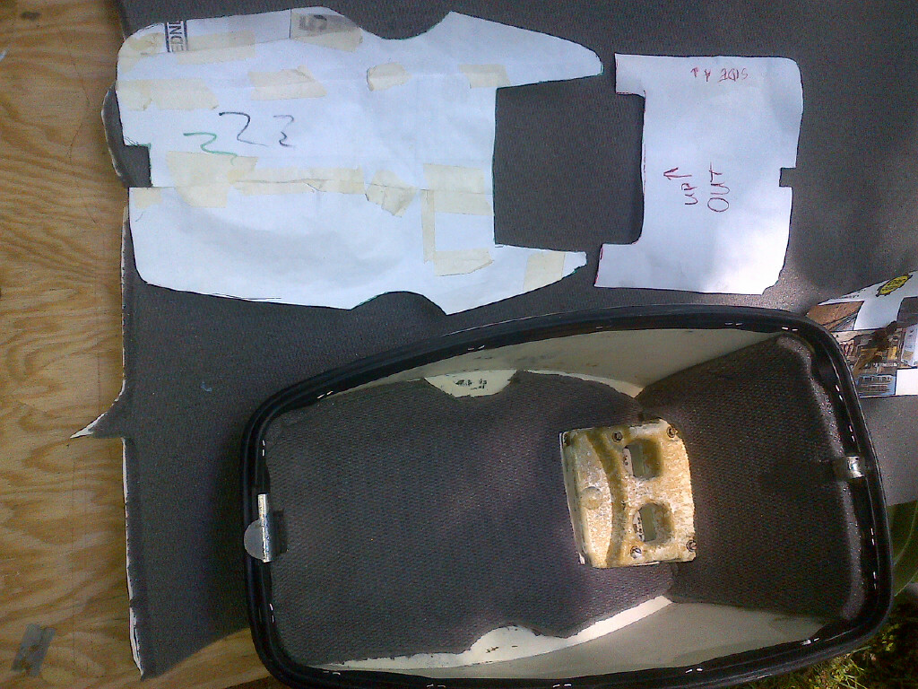

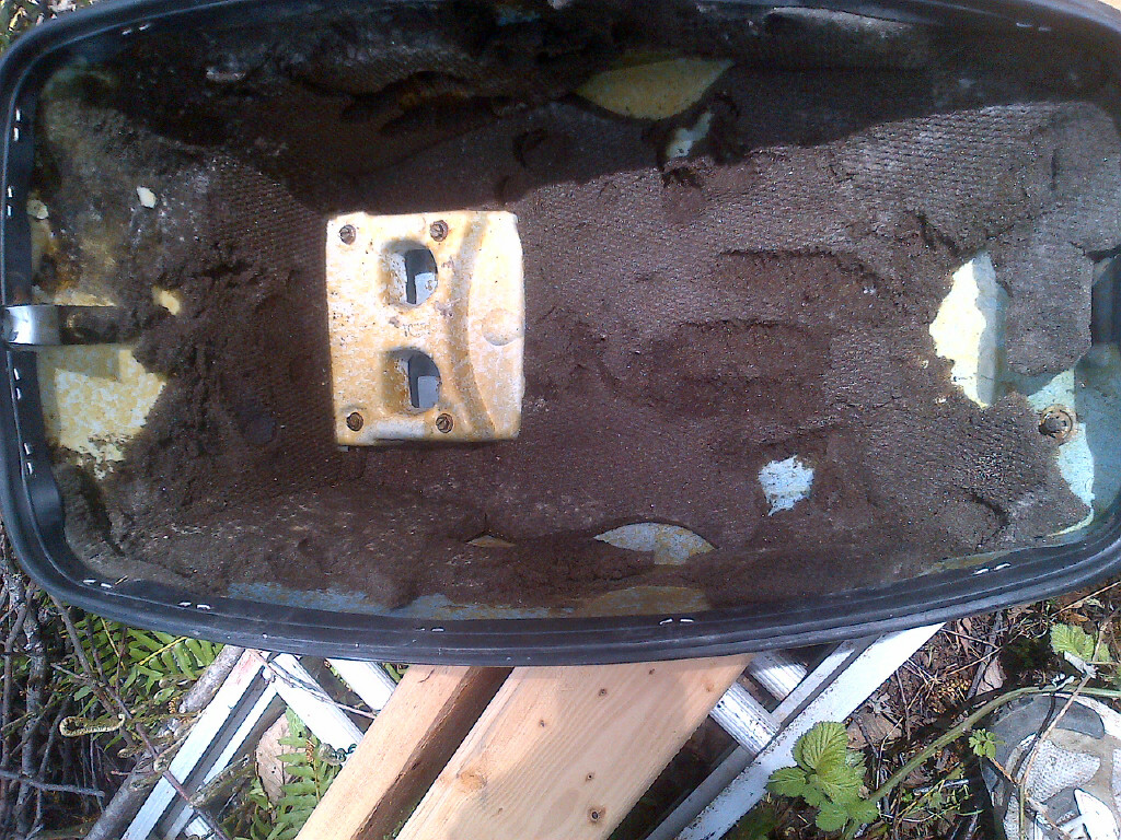

                  #82694
                  PugetSoundBoater
                    Here are 2 photos , before and almost completed on the 15 hp cowling. I made patterns off my other 9.9 since the insulation on the one shown was too far gone to make a good pattern from.
                    Robbie Robertson
