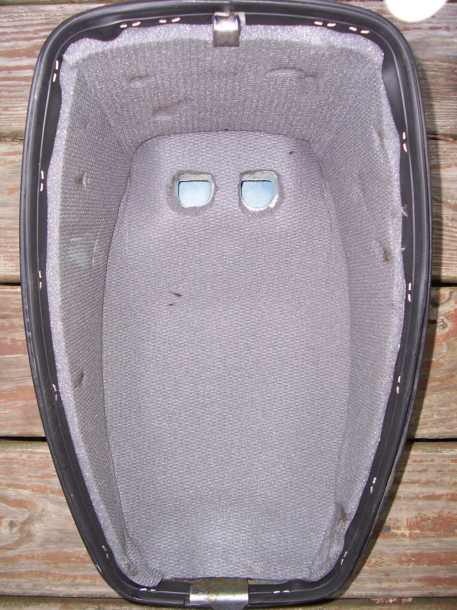

                aquasonic
                  In 2013 I added 1/2" thick Soundcoat acoustic insulation to my 1990 Evinrude 15. The original insulation had crumbled, so there wasn’t much to make a pattern from other than the cowl itself. Four panels did the trick. The adhesive is so powerful that you only have one chance to position it. So far, it has worked well.
                  Improvise-Adapt-Overcome
                  #82819
                  Chris Roach
                    quote aquasonic:
                    That’s all I needed to hear. Ordered. 😀
