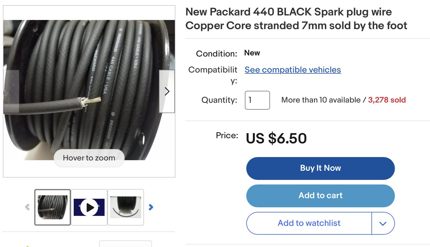

            John, here is what I use, it’s on EBay.
            Bob D

              Perfect, thank you. I’ve been looking but could not find it by the foot.
              I appreciate the help!

              #280198
              aquasonic
                That’s some pricey sparkplug wire! There are other vendors with the wire priced at a little over a dollar/Ft. Of course, a 100′ roll can get you a price less than a dollar/Ft.

                #280240
                  I believe the Packard 440 wire is correct for some auto restorations. That
                  may explain the price. Search eBay for ” 7mm copper core spark plug wire
                  by the foot” for some lower priced options.”

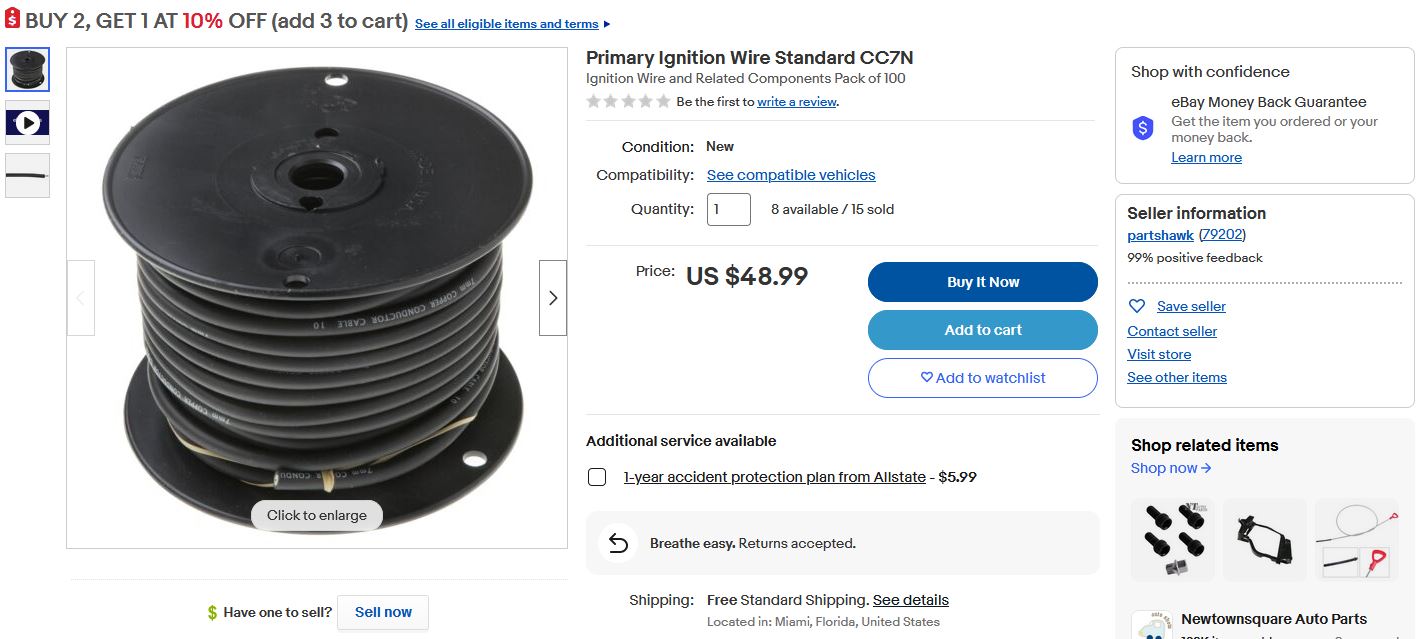

                  #280243
                  seakaye12
                    You might as well get a 100 foot roll of it and get it over with. Here’s the brand that I bought a coupe of year ago: “Standard” 7mm Copper Core Spark Plug Wire…..100 feet shipped to your door for $48.99.   49 Cents a Foot.  (It was 38 Cents a foot when I bought mine!  Inflation!!!)
                    The quality seems fine to me; I have never had an issue.
                    100-feet
