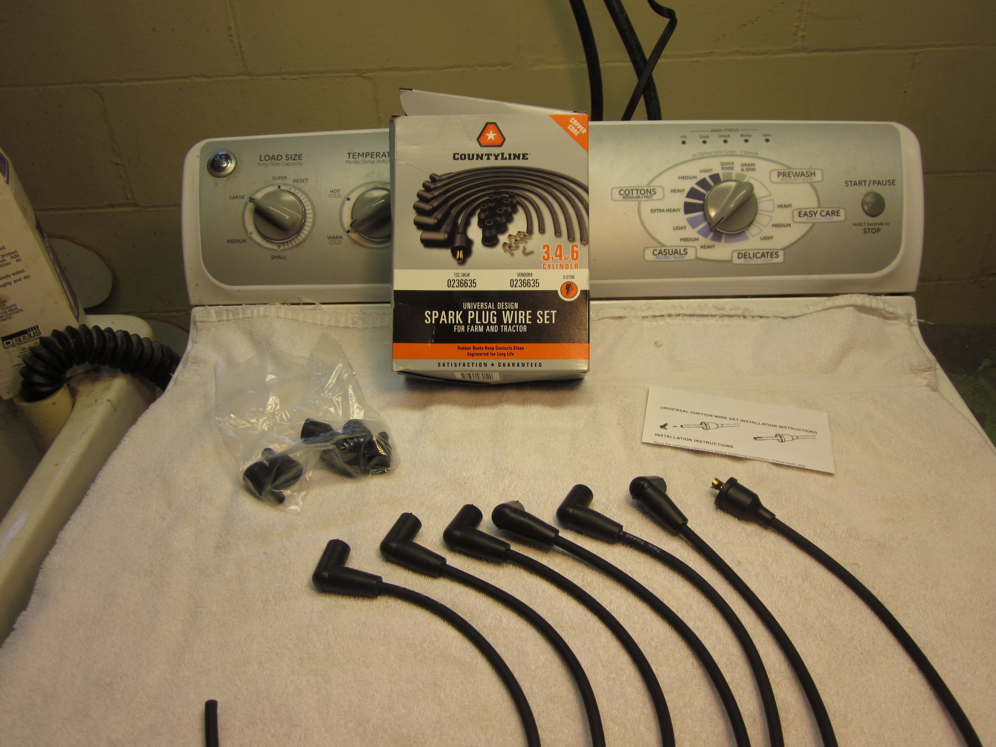

      The set I used was for a 4 cylinder. I bought them years ago. I have been able to get 2 wires from each length using some other terminal ends I had. As long as the ones you are looking at are 7mm copper core I think they will work.

        I buy a set for an old ford tractor, makes two sets. I can’t clean the connectors inside the old boots to my satisfaction.

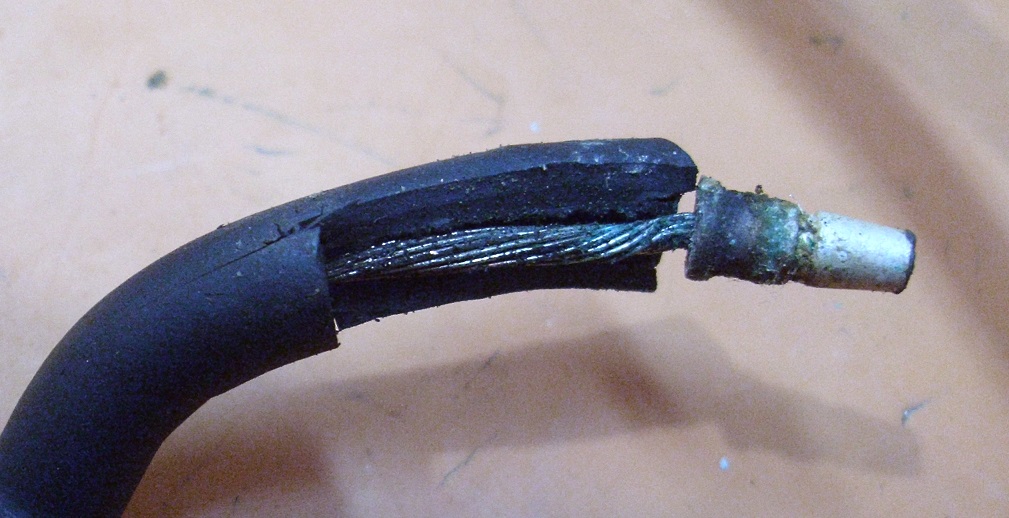

                    #72752
                      make sure you don’t get any arcing … check in the dark flexing wires do eventually get micro cracks allowing HV to jump to ground and will measure 0 ohms nonetheless
                      it is up to you new wires are better than rowing
                      #72754
                        A plug wire may look
                        good on the outside but may not
                        still be good on the inside.
                        Also old insulation may look OK
                        but it can actually leak and short
                        out. That can be aggravated by
                        moisture so your out on the water,
                        it starts raining, and you cant get you
                        motor to start. Even at $2.00 a foot
                        its not something I would consider
                        not replacing.
