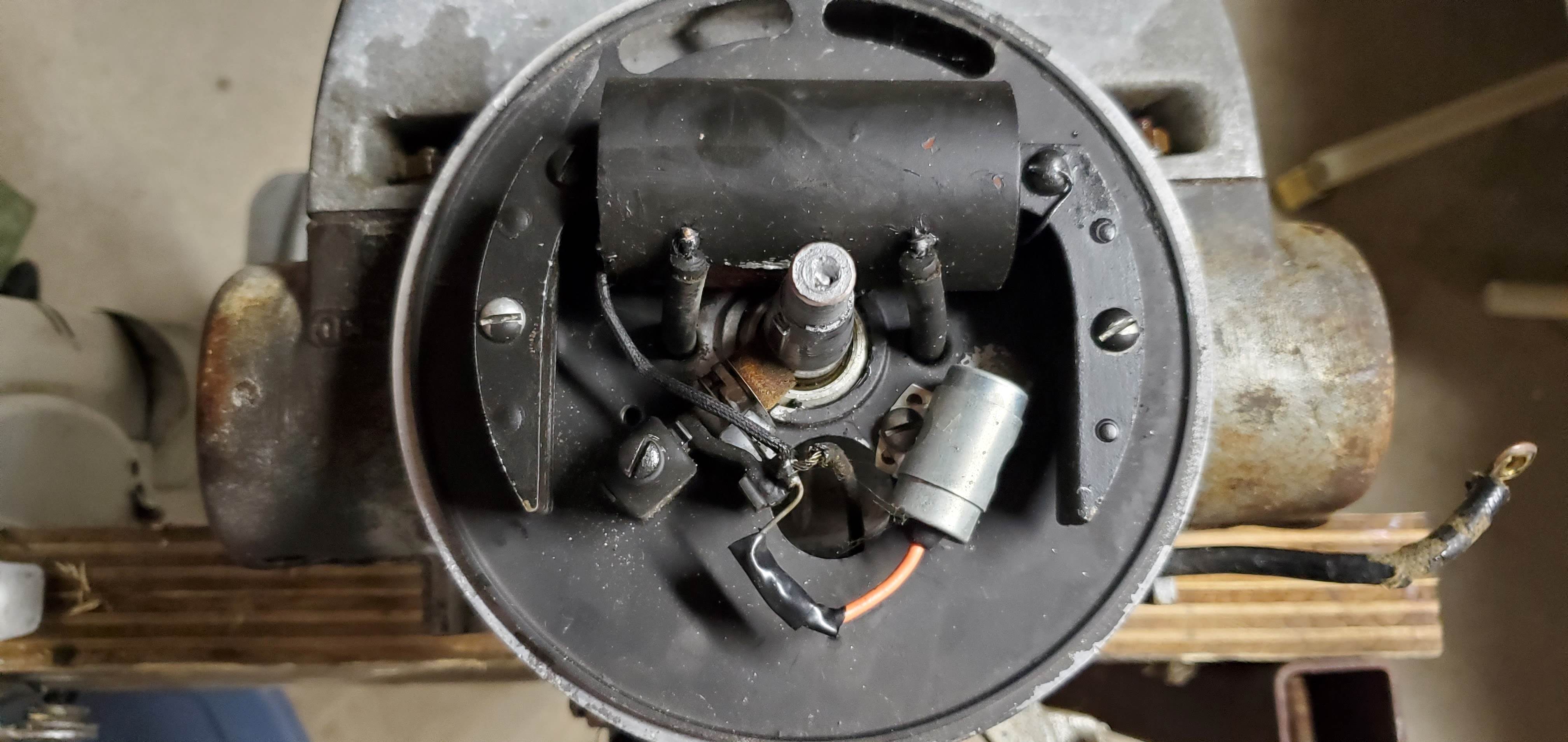

        How have you determined that the coil is bad. Have you cleaned the point assembly and checked for spark.  A picture of the coil in the magneto will help with possible options.
        #302647
        Gregory Geurts
          Hey Tubs, thanks for responding.  The primary circuit seems good, the secondaries bounce between 5 and the mid teens but I only have a digital tester.  Looks like someone replaced the condenser at some point so I need to test that yet.  Cleaned and set the points and there is definitely no spark to the plugs.

                  Gregory Geurts
                    Ok, thanks for all the suggestions. I misread the file size so this was likely my issue. The old 1D10T error.
                    20251221_142414
