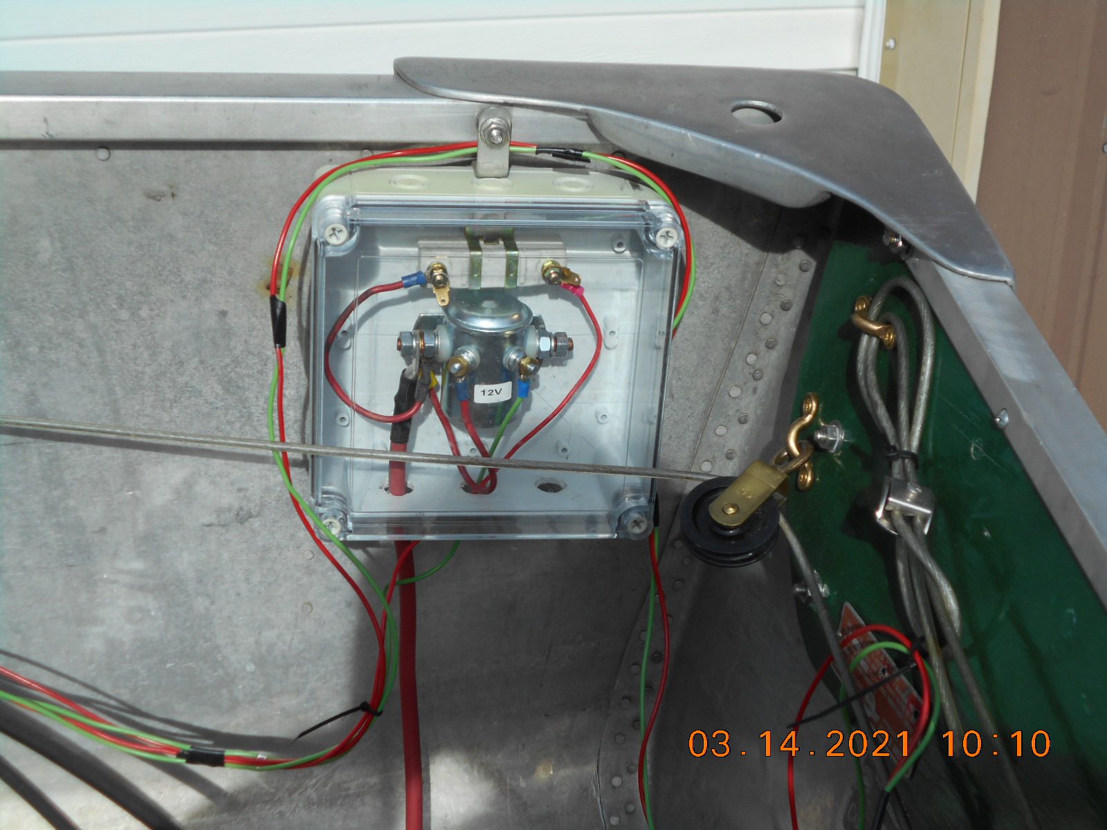

        I made up a box for mine using a plastic electrical junction box that had a waterproof,
        screw on cover. For some reason, I can’t find any photos of it.
        I spun my starter with a 12 volt battery, and had a resistor to feed my choke solenoid
        6 volts.
        I mounted the box near the stern of the boat and ran wiring from there.
        Found the photo!…
