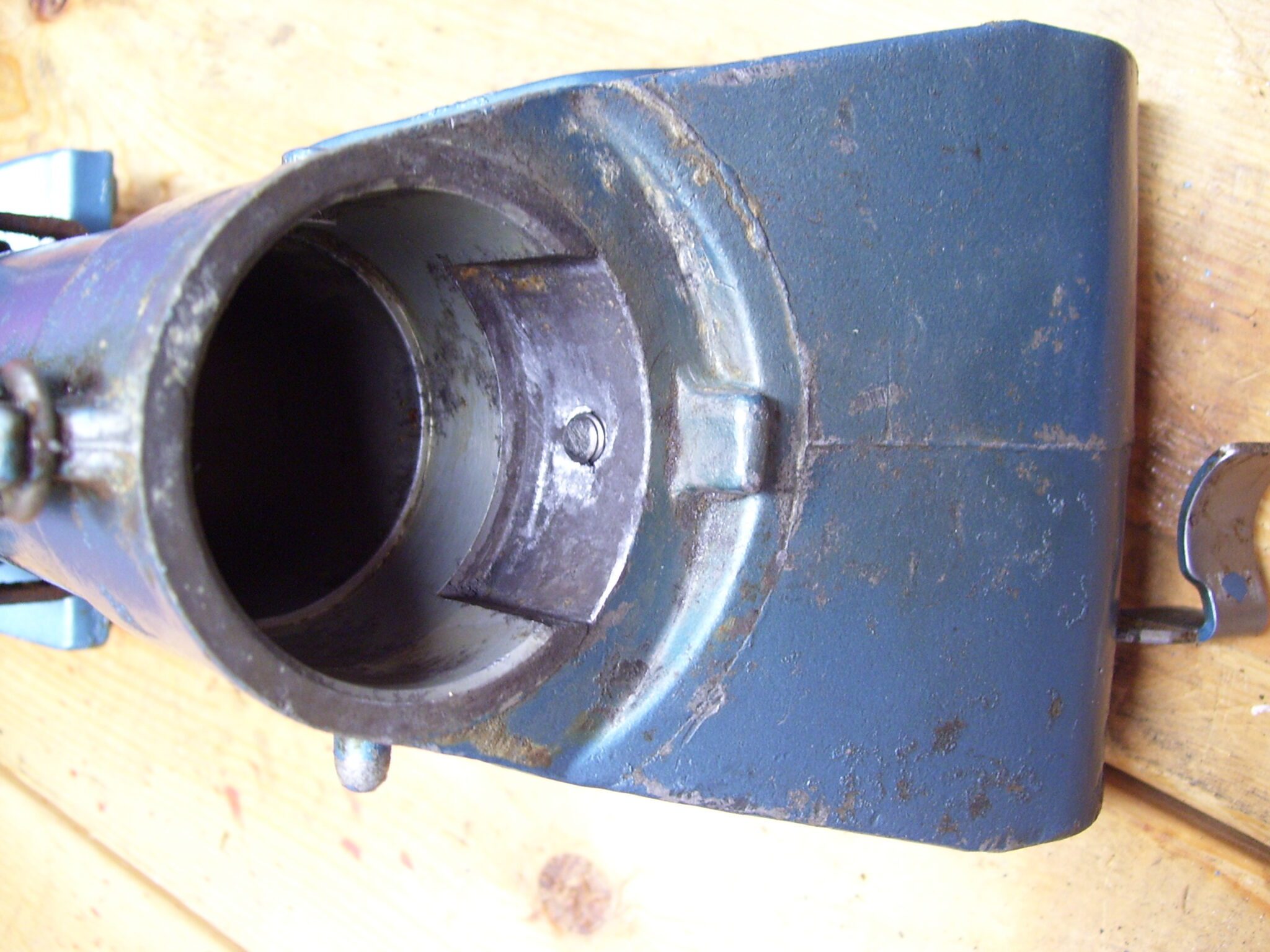

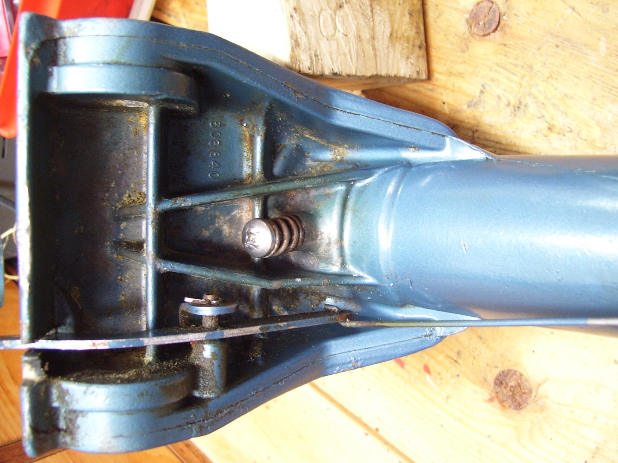

                  Took the motor leg apart, drilled and tapped the old screw.  Broke a vibration mounting and found the inner upper phenolic ring was cracked but should be able to find those two parts.  Drilling thru the old screw was difficult because of clearance with the drill chuck.  Used a hand drill (eggbeater drill), with patience and luck.
                  Thank you everyone I appreciate the good advice.

                  #275149
                  JOSEPH BRINCAT
                    Good work in getting that screw out. Not to be too picky, but I would replace that philips screw with a nice beefy filister head screw… you will appreciate it in the future.
                    Joe B
