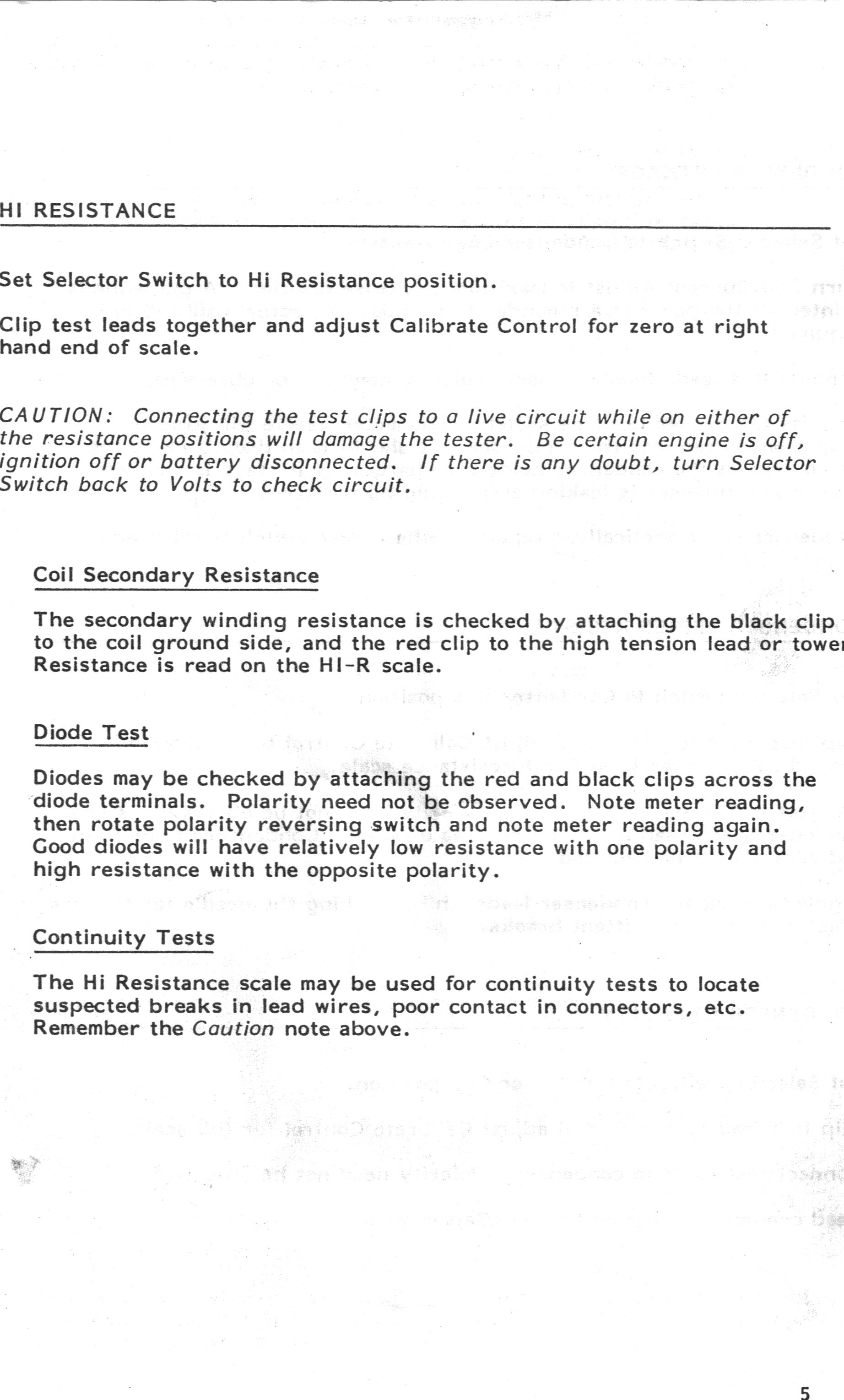

          I think the reverse polarity knob is to be used after testing a condenser for leakage. By reversing for a spit second with power switch off it keeps you from getting shocked when you disconnect the condenser. Not sure if that’s correct but that’s what I use it for.

            Joe, I went back thru the manual and found out about the "Reverse Polarity"
            knob. It was in a section for, and regarding, testing diodes.
            Also, the manual states that when testing condensers for leakage, they’re
            automatically discharged when you let go of the test switch.
            This little manual is before they invented pictures, so I have to
            read it carefully, lol.

                  Thanks for clearing that up for me I don’t have a manual for my tester.

                    Joe, The reverse polarity switch is talked about on this page
                    of the manual.

                      Thanks,
                      I will use this test on the mosorb diodes I am installing on my electronic modules to see how it tests compared to my digital multimeter.
                      If you have the manual in digital format could you post it here or pm it to me.
                      Thanks,
                      Joe
