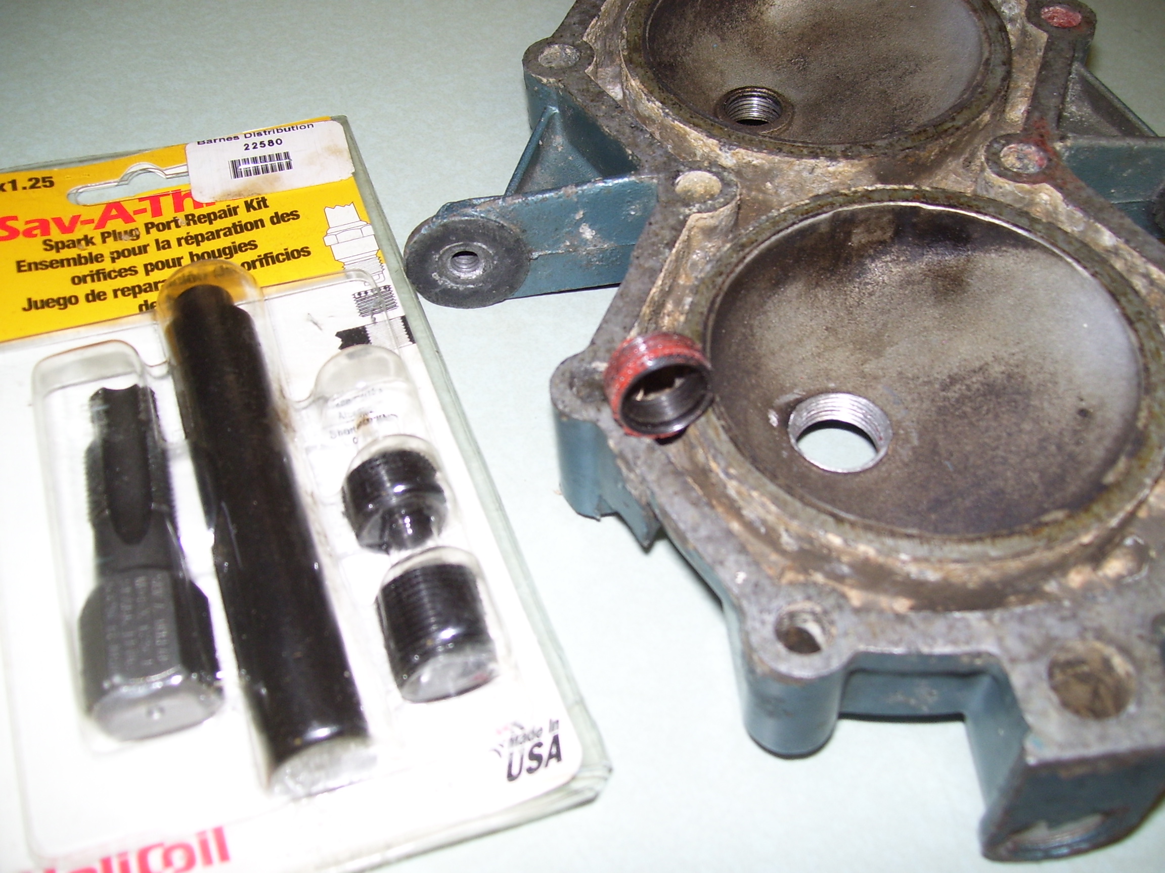

            The head did not tap well. The tap tore the aluminum head material without cutting clean threads. The head is quite thin so the tapped thread was short. The insert just pulled out.
            Something went wrong here, big time. The supplied tap in the kit has a pilot thread on it and will follow what’s left of the original threads, if any, before the wider section cuts the required thread for the insert. The pilot ensures the threads are going to cut at the same angle to the head as the original ones were. This should have been a plug and play type of operation and the threads shouldn’t have failed.
            #56214
            olcah
              Yes, The tap was new out of this package. I am no expert on tapping but I have tapped a lot of holes so go gently. Immediately I noticed that the material was not cutting cleanly but tearing in a gummy way. I tried to clear the tap and then continue but the tapped threads were terrible. I have not always had good results tapping aluminum especially die cast. Only thing I can think is maybe the tap is defective or the diecast material composition does not lend itself to tapped holes. I know that sounds strange. I did start the pilot in the remains of the threads. It followed them. Started cutting dry then tried lubricants but as I went forward tap continued to tear the material.
              I appreciate your comment. Frustrating experience but we don’t win them all. 😀
