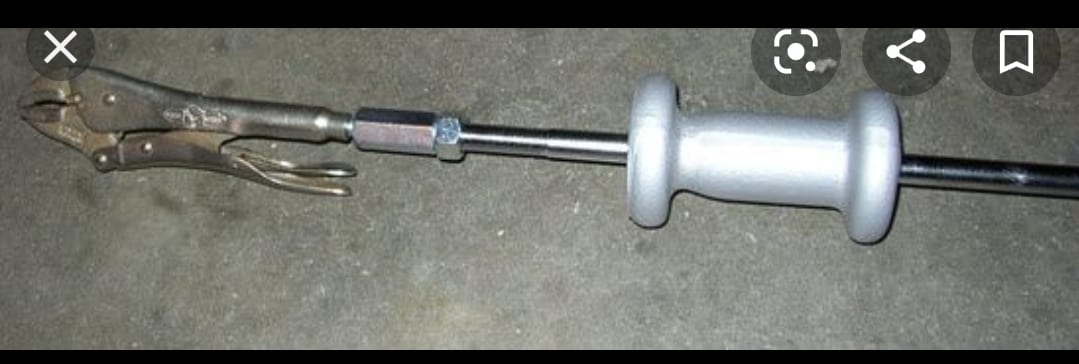

          What I use is a slide hammer that has been welded to the adjusting screw of vice grips. Just make sure you grab ABOVE where the seals are and hammer away. Resist the thought to pull directly vertical from the splines, you will ruin a perfectly good driveshaft that way. Using the slide hammer on an angle has never failed me and I’ve had some STUCK ones. You can tap the drive shaft back in a little once it starts moving to help loosen things up.
          There are actual slide hammer kits that come with a vice grip attachment but welding one permanently was much cheaper since I already had everything.

                Please be careful trying to pull the driveshaft down with slide hammer etc…Like Trex says, it is super easy for those vise grips to move destroying splines or seal area. If none of the methods already mentioned help, you may have to pull the powerhead…Prying down on the driveshaft while rapping on the driveshaft near the crank with an air hammer usually frees em up for me…Once it moves a little bit, spray the splines with oil and tap the driveshaft back up into the crank…Keep working it back and forth til it comes out…

                  Ok, tapped the driveshaft to try to break rust loose and ran motor for 20 minutes. No luck. A friend has a slide hammer with vise grips. If I can clamp onto shaft an inch above the impeller drive pin I should be safe,correct?? Any other locations recommended from anyone?
                  #238317
                    Well, the location of the impeller pin is up inside the exhaust housing so getting the vice grips on it up there seems tricky. Keep in mind that the vice grips will probably migrate down while using the slide hammer. Be careful…
