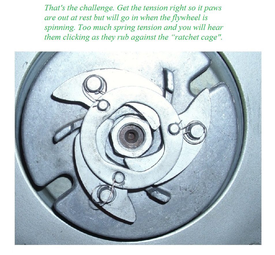

I took this appart some time ago and don’t recall there being a spring return to keep the prawls extended to enage with the clutch dogs.
Don’t see what I’m missing here. I’m not finding anything in the parts diegarams that look like a spring.Please advise.

October 17, 2025 at 8:48 pm #300715Oh boy, this looks like fun. I do recall these springs now that I see the picture.

If your the type that likes to fabricate and has some patience, I suspect it can be done. Its a lot of on again, off again, to see if there engaging. Then running the motor to see if there pulling in. Me and a friend spent quite a bit of time one day trying to make some but never could get the tension just right. These assemblies are plentiful at Tomahawk. Most are in different stages of completion but I did find one with all the springs. Doug Penn had a complete one on eBay not that long ago.

I do enjoy a challenge but see this one as you experienced a time consuming endeevor with marignal results. Agreed, the better option would be to find a good assembly or a parts recoil. I don’t want to invest a lot of time in these motors as I plan to sell, donate or give away.
