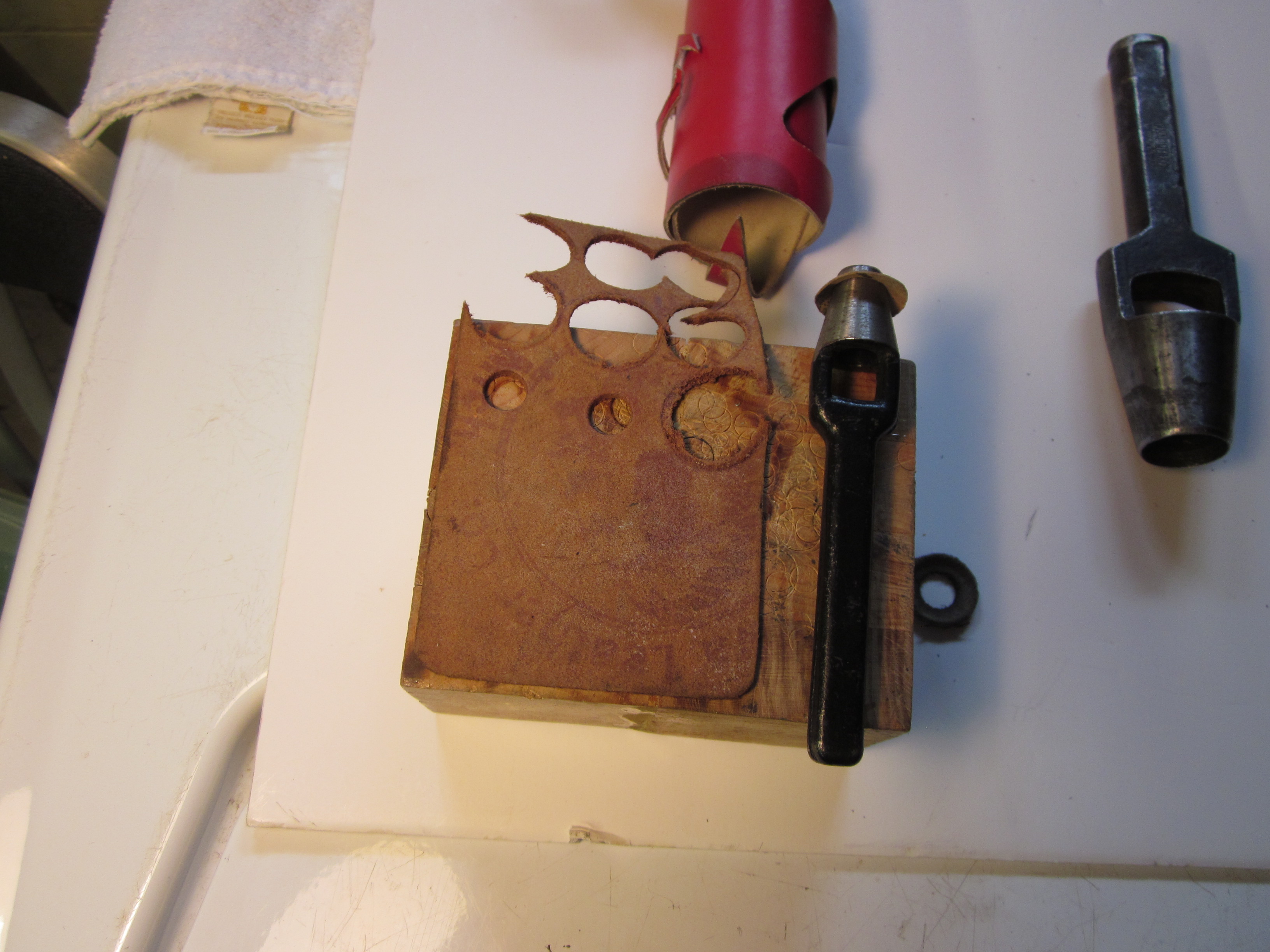

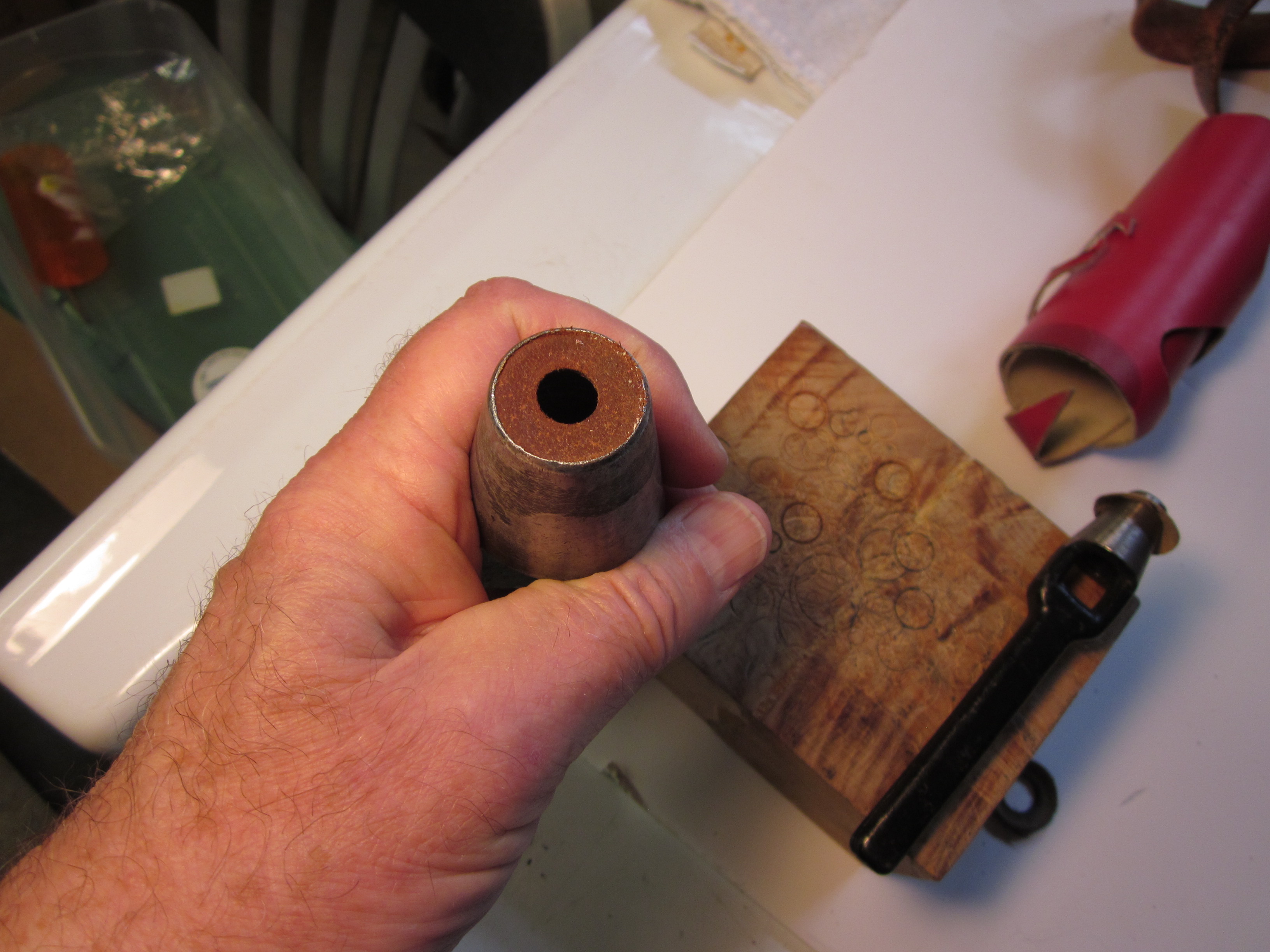

      Louis can always be relied on to do first class work. As for the gasket cutting wood block…. there is a little secret there. The wood block works best with the end grain as the working surface. The block holds up better and the gasket cutting comes out cleaner.

        Nice gaskets Louis! I’ve been making my own gaskets for a long time,
        but never to old to learn new tricks or of a new tool.
        A couple of years ago I got a set of transfer punches.
        Great tools for the spots you can use them.
        They perfectly mark the center of a flange hole, etc.
        After marked, I then use a transfer punch as a "pilot"
        for my hole punches, so the holes are spot on where
        I need them.

              I like that! Never thought of it before. I have a couple of rubber vent screw gaskets to make. Can’t wait to try that trick!

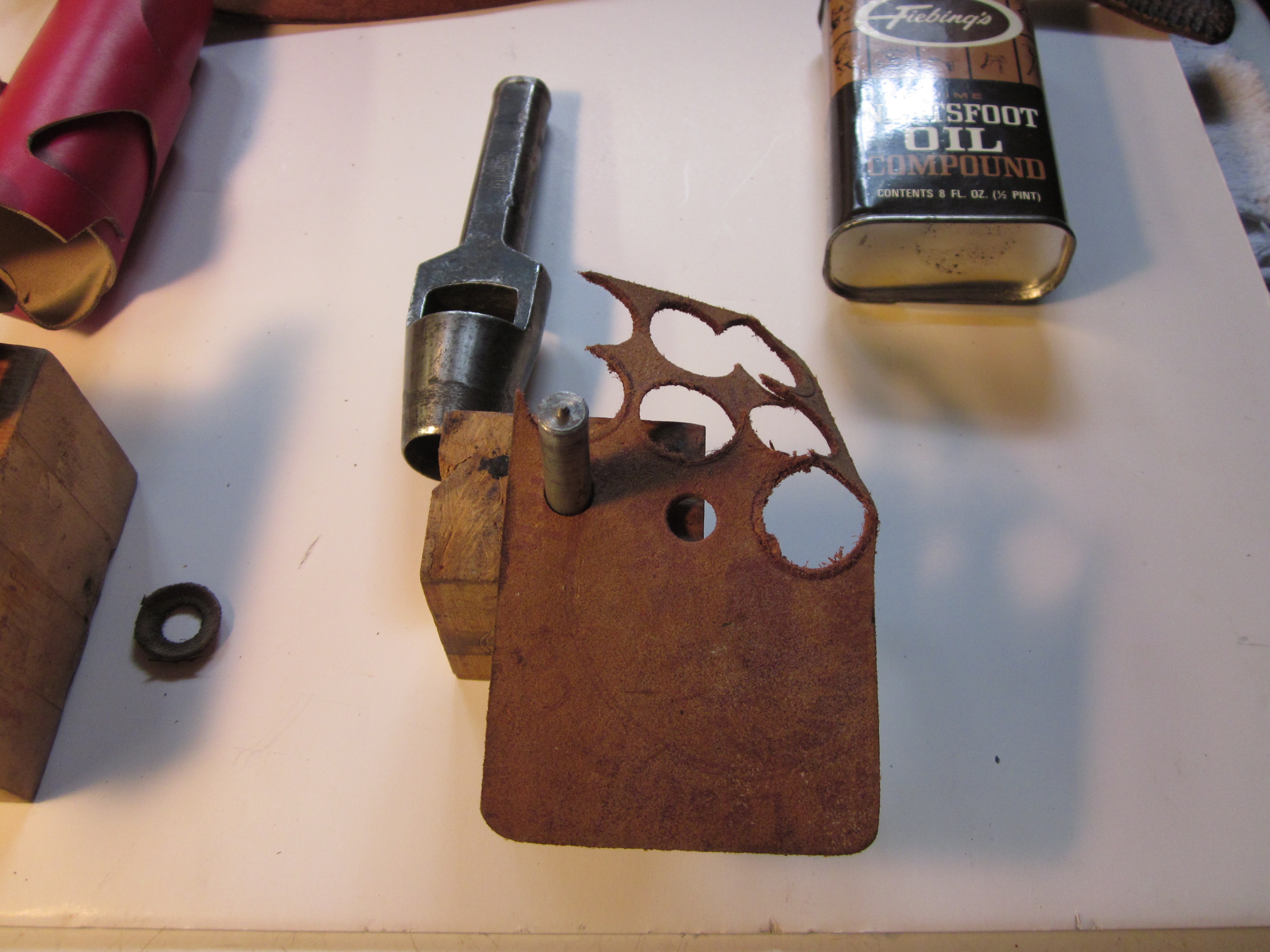

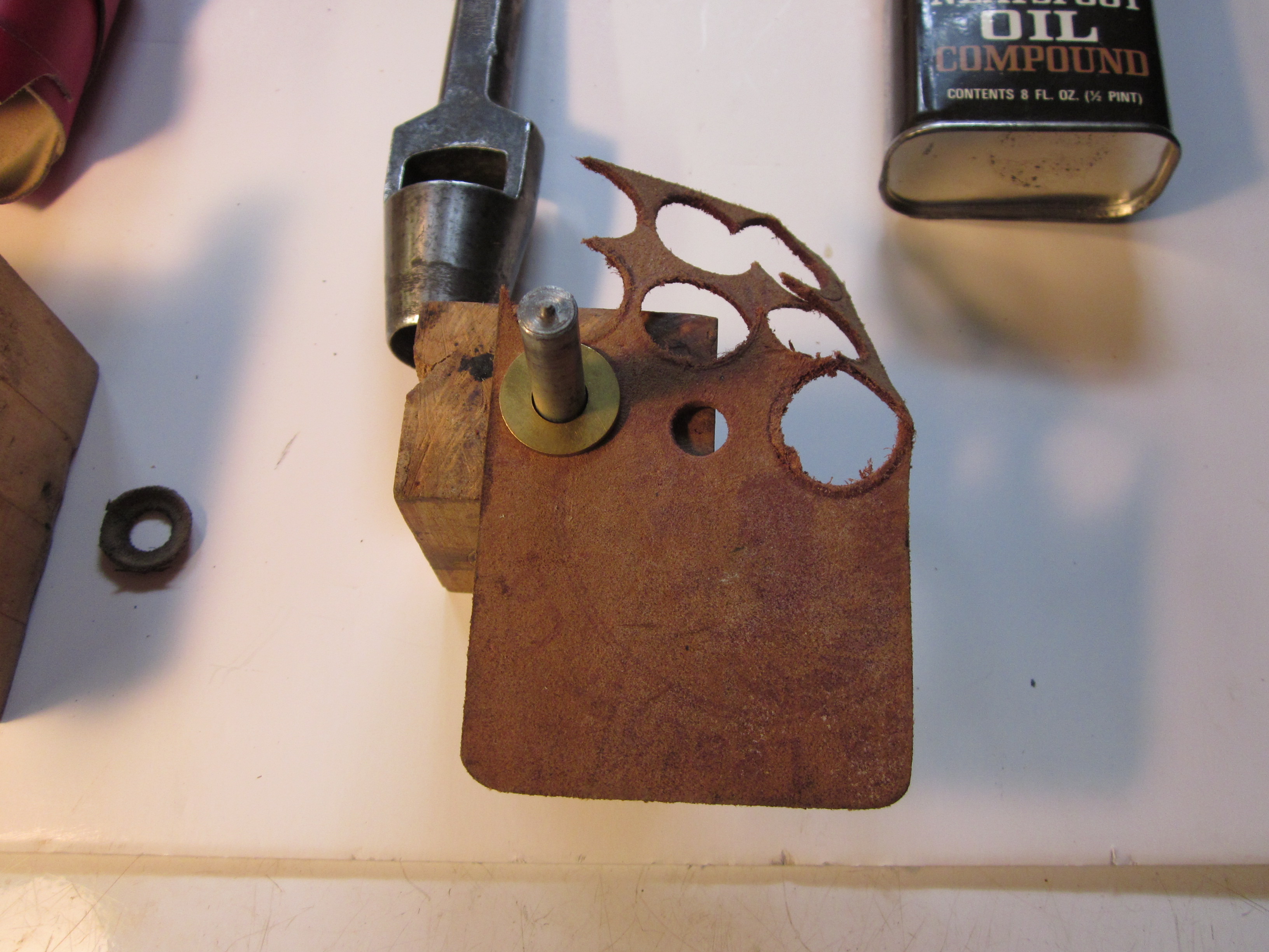

                      Fot those who might be making lower drive shaft seals (for Early Kiekhaefer K Models)
                      Use 3/8" center and 7/8" outer punches
                      The 1/2" drive shaft and 3/4" bore are tight fit for seal so
                      saturate seal with leather oil and it will install easier.
                      Pressure of spring forms the seal into cup shape.
                      The key is the washer that locates the large punch so the outer diameter concentric
                      to the center hole..
                      The brass washer just happened to be right size and on hand.
                      I doubt this simple idea is original.
                      Louis
