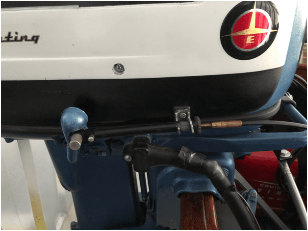

      Could a picture or diagram be provided of shift cable attachment to engine shift handle on 57 Evinrude Big Twin 35 HP? At the control box the shift goes all the way into “Forward,” but at the engine the handle barely goes right of “Neutral.” Disconnected, it shifts through Reverse, Neutral, Forward just fine. I’ve tried numerous adjustments but unsuccessful getting shifthandle to move all the way to “Forward” and for the lever to go down into the “Forward” opening at the bottom of the unit. Apologies for possible wrong terminologies; new to this engine. The motor is on our ’58 Thompson Sea Coaster.

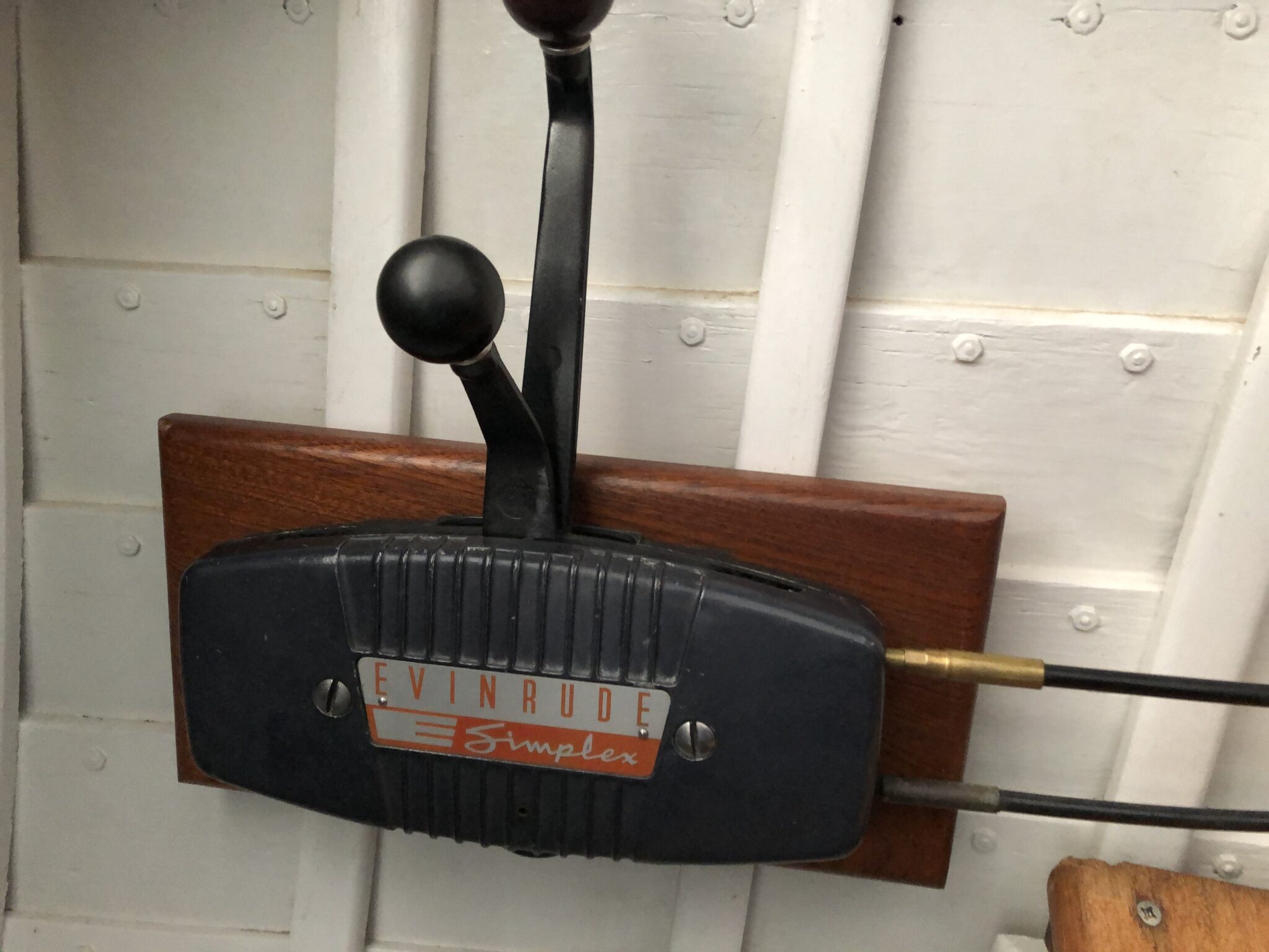

      #236902
        Can you post a photo of your control box?
        #236911
        Seacoaster1
          I can email a picture to you, if that’s OK with you to provide an email address. Or check the doc. below.
          Karl
          • This reply was modified 4 years, 10 months ago by Seacoaster1.
          #236918
            Check your PM box for my email address. Top right corner.
            #237105

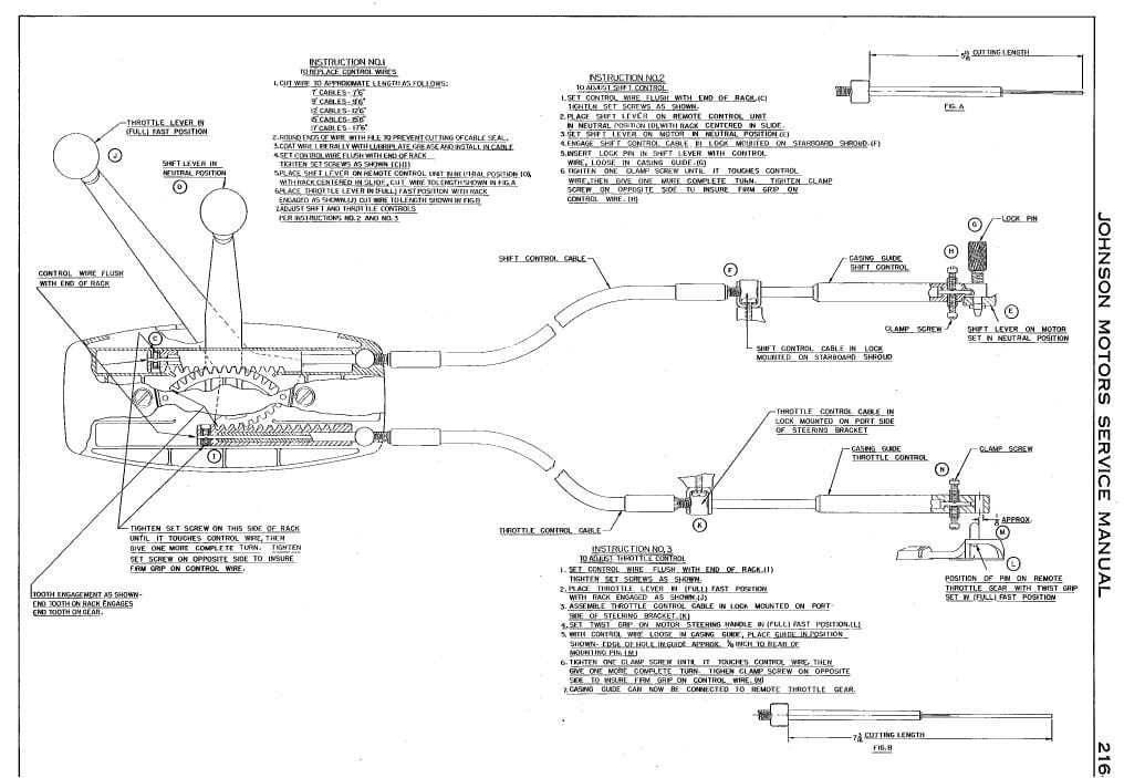

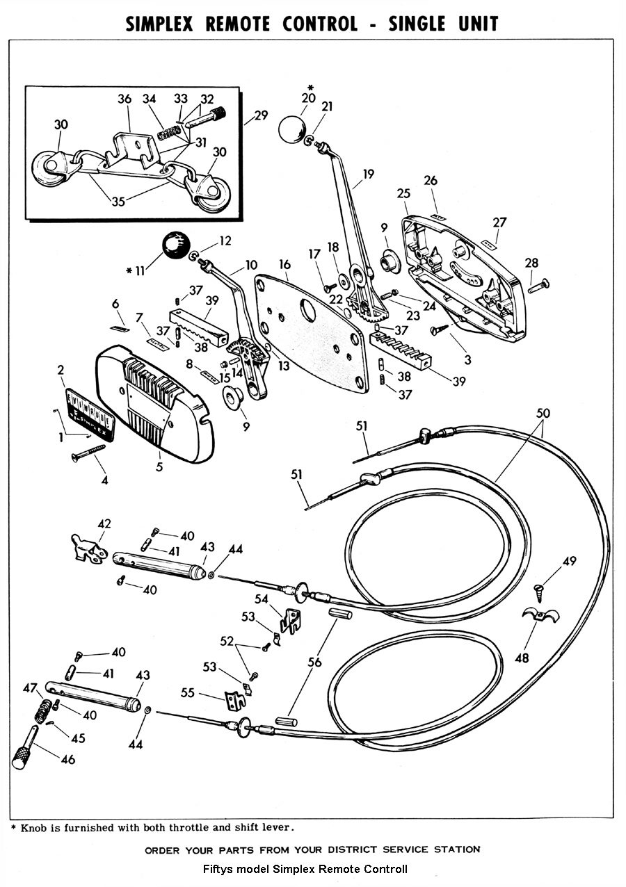

              The control box would have been apart to attach the cables so is it possible it got reassembled with the plastic rack which the inner core attaches to may be one tooth out from the lever? Also, is the motor running or the prop being turned over while trying to shift into forward gear? If nothing is moving, the shift dog inside the gearcase may not be lined up correctly with the dogs on the forward gear which will prevent it from going into forward gear. The inner core may be too short to.
