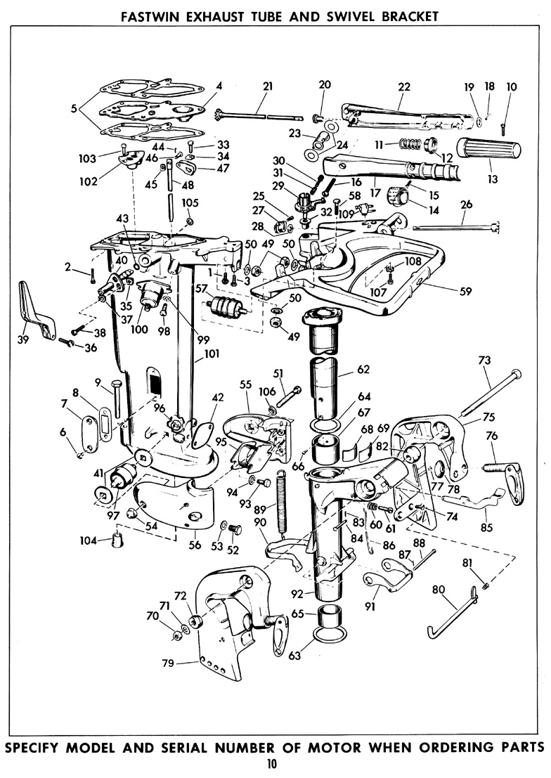

      The tapered ring (12) inside the grip is designed to add friction to hold it in place when the grip is not held. It is taken out when remote controls are used. It needs to be greased to turn easily.
